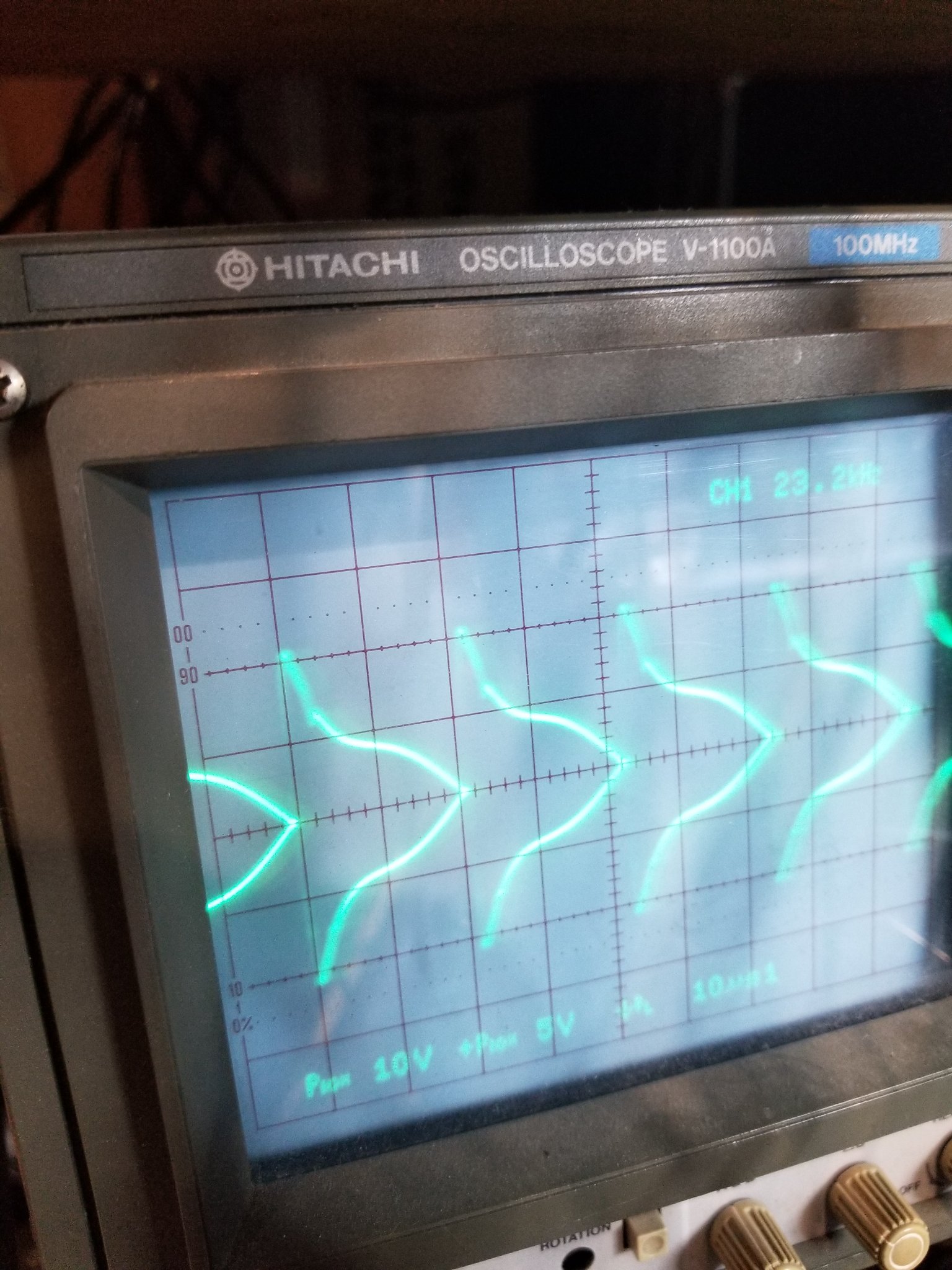

The waveform will change because it's a regulated circuit and the duty cycle changes to maintain the target rail voltage.
If you monitor the pin 8/11 waveform and vary the 12v input voltage, you can see the duty cycle change.

I did get a wave off pin 8 (didnt probe 11) but I'm not sure what I'm looking for. The voltage at battery is not getting dragged down considerably. What other voltages should I check?
The pin 8 was just for knowledge. You'd vary the 12v supply voltage to see the difference.
