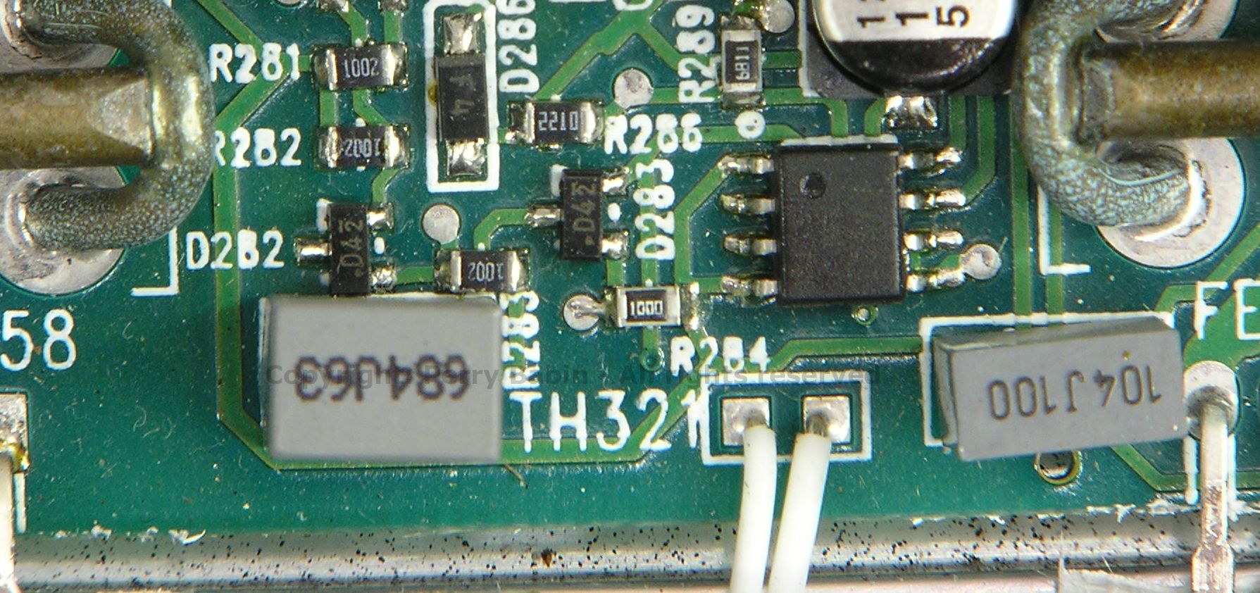

In that few seconds it seem maybe th32 was warming up. The heatsinks is a couple degrees warmer there and the outputs are not clamped. The sound was like a sizzling sound. Th32 tests the same way as th320 wich appears to be the same part.
After a little while that part of the heat sink is still a couple degrees warmer . I may be just from the light on my bench or some other anomaly. So I dont think that component was warming up.
See attached. TH321?
I didnt let the power wire sit on ther long because of the sound it was emitting. I didnt even get a chance to hook up the remote wire. My battery voltage was sitting right at 12v. I'm not sure if that's low enough to cause the amplifier to make that noise or not. I'm not used to amplifiers making noise unless I'm running it hard into load resistors with a 1khz test tone. I know some of these class d amps make a whining sound but it is nerve racking to me ahah. Should I just let it make the noise and see what happens? It didnt pop the 10 amp round fuse so it couldn't have been drawing a ton of current.
