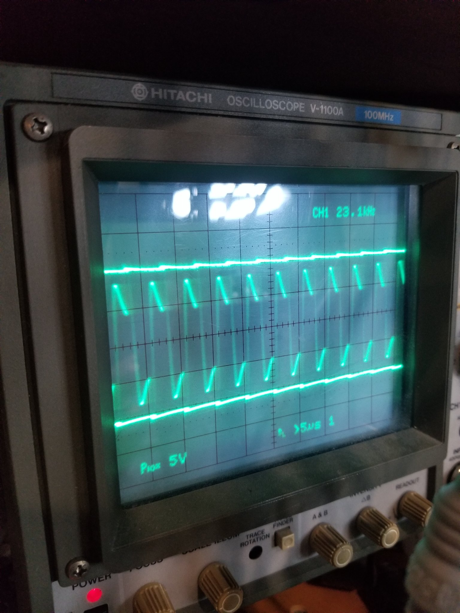

The resistance between +and - was 215ohms. After pulling ps fets it is 1 megaohm. It is not blowing fuses when powered up. It is not making any noise at all. The fets all test good in my tester. Checking drive at the ps fet sockets I get a signal but not the same as I was getting. Here is a picture.
Is the scope triggering properly?
Is this with remote applied?
Is this waveform with the loading capacitor?
This is with remote, amp powered on. This is without the loading cap. I played with the scope to get the best possible image.

Use the loading cap and confirm that both drive signals look the same for both banks of FETs.

I installed loading caps and both drive signals look like they should.
