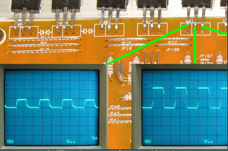

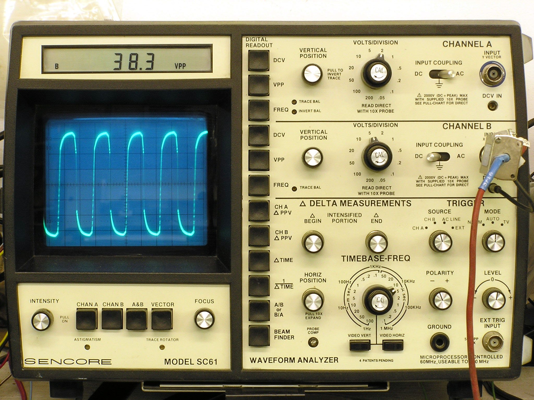

You picked one of the oddball power supplies. Below, you can see two sets of waveforms. The one that swings above and below ground is the MTX type of drive (from a transformer). The other that's all above ground is, by far, the most common and possibly what you expect.

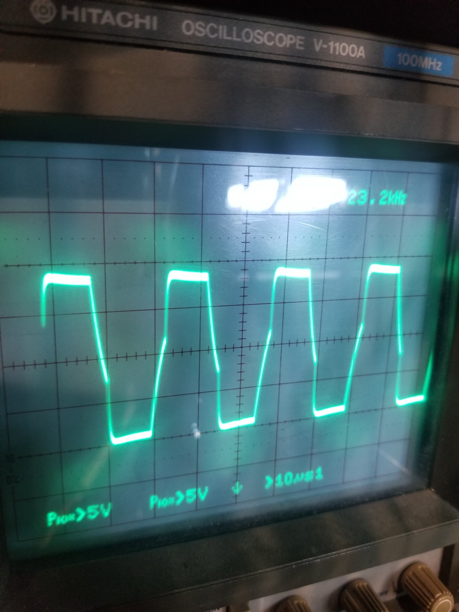

Ok understood. Mine must be the mtx type. It basically looks like a horrible ac wave. With my dmm I'm getting about 1.1vac and that makes sense after seeing this wave. This is both banks superimposed.

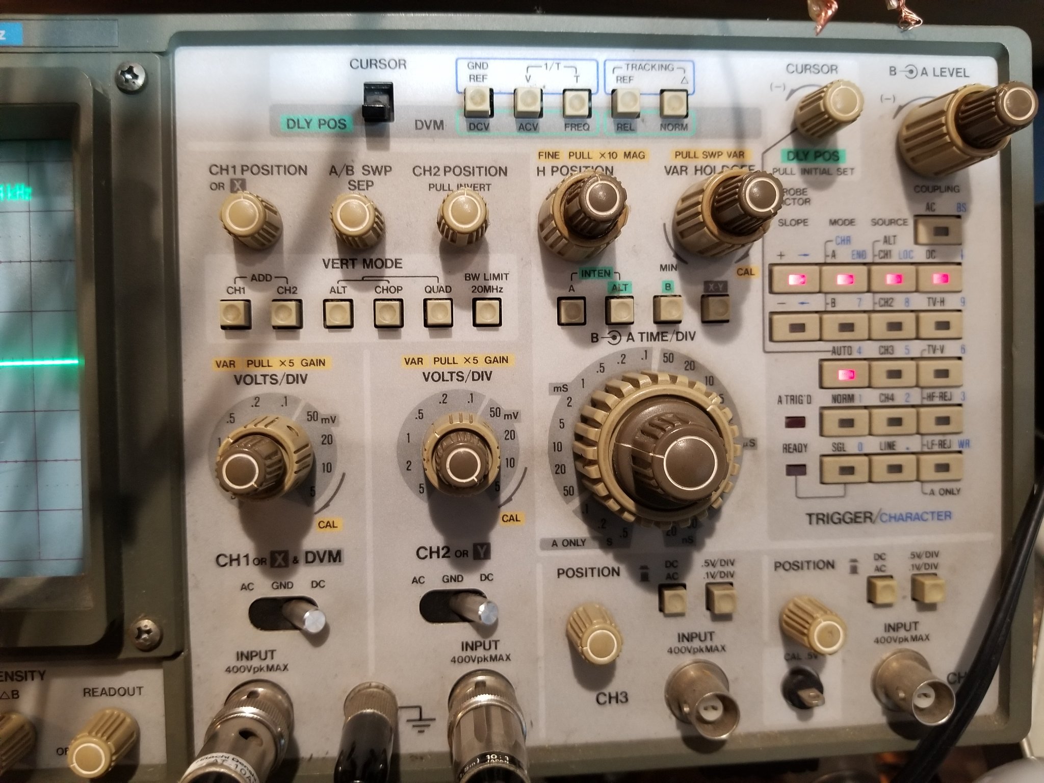

This is definitely the first class d amp I've even looked at. Much different then class a and class ab. So what am I supposed to be adjusting here? I can pull the the channel 2 position knob to invert the 2nd channel but cant seem to get in differetial mode with any of the variable adjustments.

With one channel/probe, if you touch the 12v terminal of the power supply, the trace should deflect up ~2.2 divisions with the vertical amp on 5v/div.
With the other channel, touching the same point, the trace should deflect down the same amount.
If you touch both to the 12v+ terminal at the same time, the trace should not deflect.
Do not ground the 3rd terminal of the FET with the FETs installed. That was only for testing the drive signal with no FETs installed.
Right. They both deflect the 2.2 divisions in opposite directions showing 12v, but when touching them both to 12v at the same time they do the same thing. I understand the idea behind differential so I understand what I'm looking for here but cant seem to figure it out on the scope. Also yes the source of the fets are not grounded.
I figured it out with your question. If I hit add channel 2 the channel 1 button pops out. So I had hit alternate so both channels would be shown. If I hit add 1 and 2 at the same time they both are displayed. Sorry about that, user error no doubt. So yes now when touching both probes to a 12v source there is no deflection like it should be.
If you only need one channel, you can leave the scope precisely as it is.
The reason it's important for class D amps is because the high-side FETs are typically N-channel and their entire drive is swinging rail to rail. The only way to confirm that they have the proper drive with a mains powered scope is to use differential mode.
