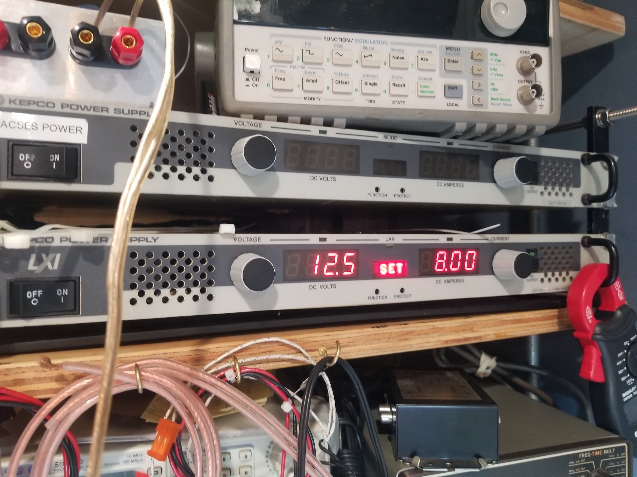

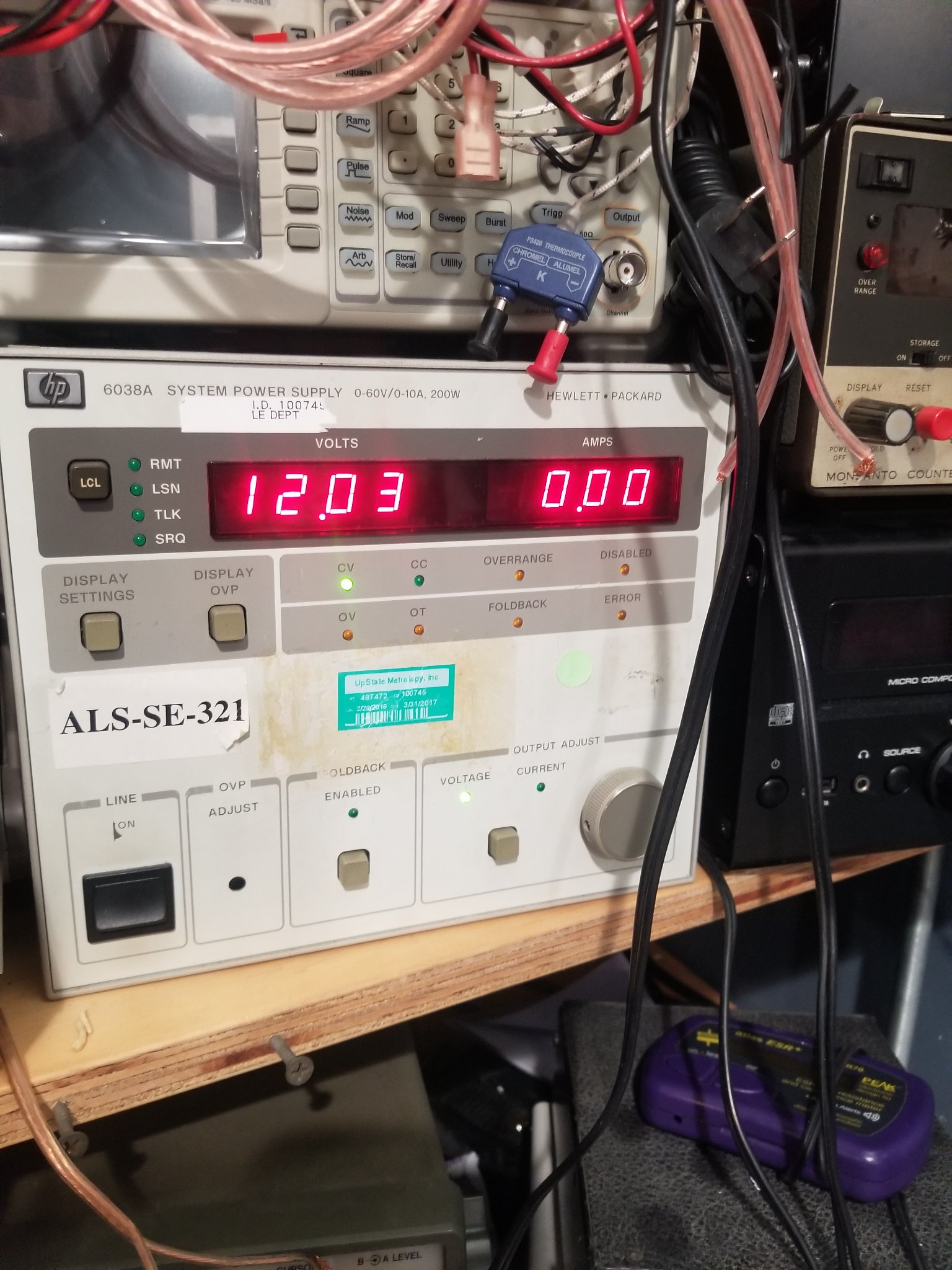

Do you have a DC supply that has internal limiting or is possibly simply limited in its capacity (10 amp power supply).
The limiting is needed here because there may be a problem and I don't want to destroy any more parts. The excessive current draw could be due to capacitor inrush or some other problem.
Use that. There is no way to damage the FETs if they're clamped to the heatsink with 10 amps of current.
Neither of my power supplies will let me get the voltage that high. Seems there is some built in protection that I dont fully understand. Either of these power supplies have ever done this to me before. Somthing about this amp they dont like. I did notice when I do get low voltage and a few amps going into this amp the clamp fet483 warms up quickly while the clamp on fet 437 (bank they were exploded in) doesnt change temp at all. Il have to get a big resistor I guess.

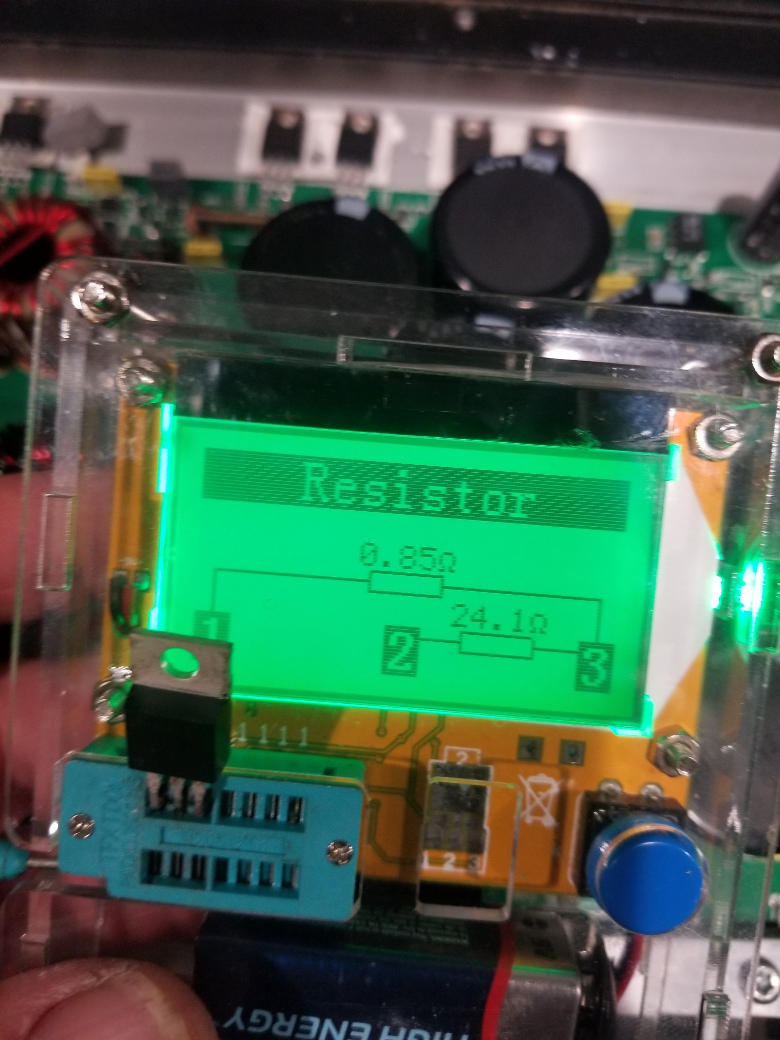

Did you check the FETs with this tester when you stated that they were OK?
Ok. Il get them from mouser in my next order. Yes them did read good yesterday. I think I accidentally reversed the polarity of the power wires with a 10 amp fuse inline. The fuse popped so I didnt even get the remote wired up. I went to replace it with a 15 amp and realized I just hooked them up backwards. I had a long day yesterday before talking to you. But hey that's how it goes. That is likely what took that fet out I'd imagine. Maybe not but I think maybe soo.
