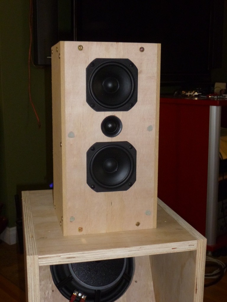

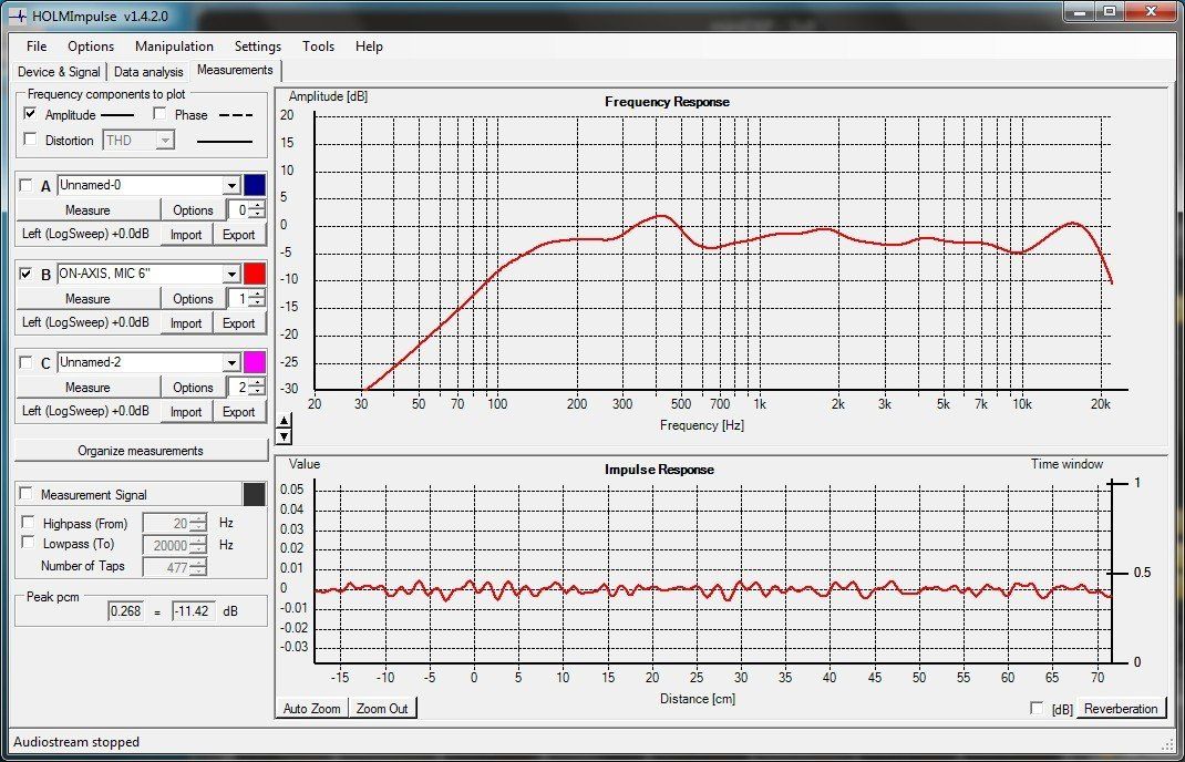

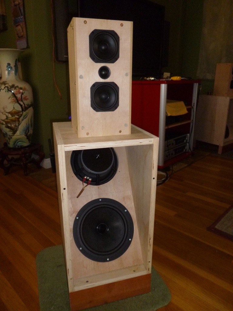

I took my Nola prototype and added the Dayton tweeter between the existing TC9's, fit was perfect. The internal open back box dimensions is about 6" x 5-1/4" x 11", smaller than adasons. I used a .22mH coil and 3.3uF cap and no resistor. My measurements are pretty good, but not as nice as adasons. Sound wise, these ARE better than the Nola, IMO. I'm running them over a pair of Dayton RS225P-8A 8" woofers. Cabinet is a Z-frame that xrk built in another thread.

Nice work Kec, I have questions 🙂
How are you finding the Z frameS?
What frequency you crossing over at?
Got a link to the xrk thread?
Thanks. I like the Z frames very much, they get pretty low. I have them crossed at 150 using miniDSP 4x10. XRK used the aluminum cone RS225's, I used the paper ones.
