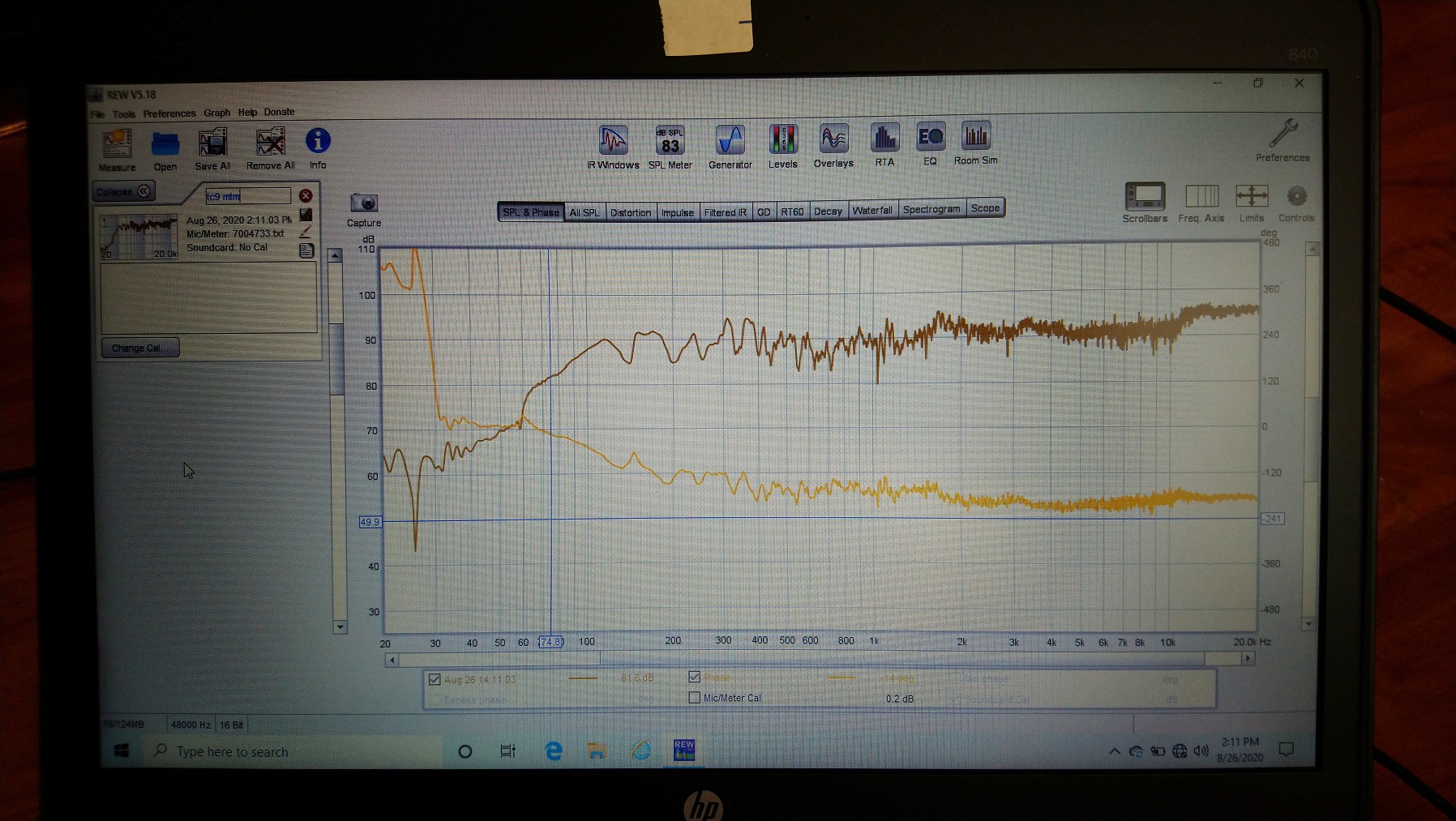

Nautaloss MTM mod

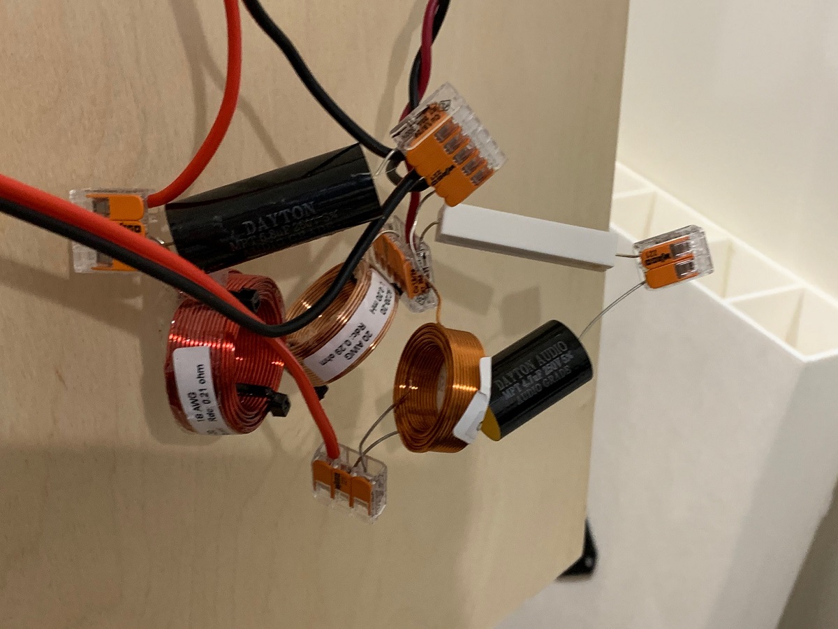

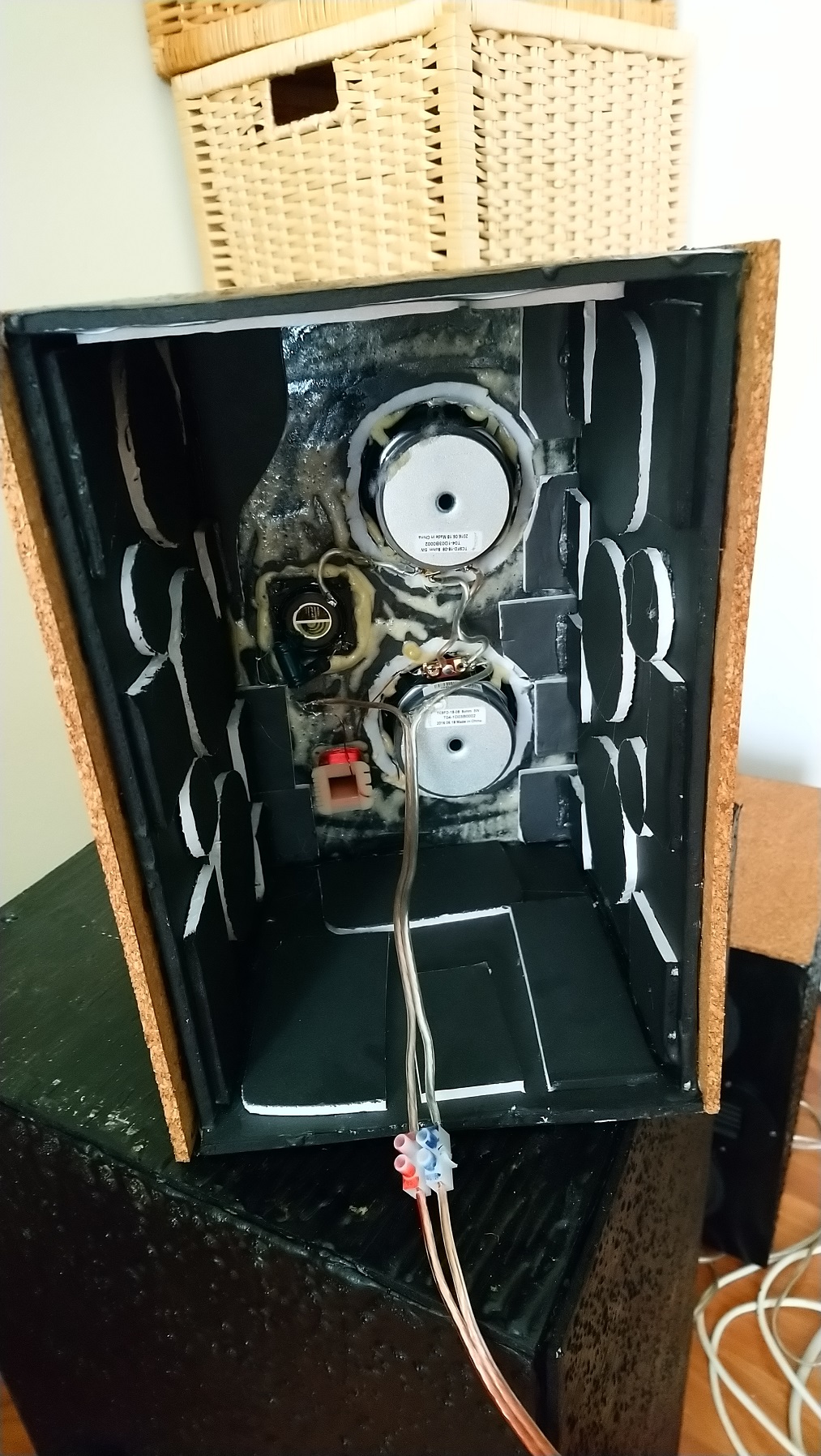

I got a PM by a member asking me about the XO on Post #1. It piqued my interest and I did this over my lunch break. I revived my old Nautaloss speakers from years ago and decided to add a Dayton dome tweeter to them to make an MTM a la Brio Clone / Adason-mod. I only have the ND25FA-4 tweeter on hand and my TC9FDs are in a sealed spiral TL rather than open back so maybe the response is different? I could not get the XO schematic from Post #1 to be flat - in fact, it was better without the inverted tweeter. So just by measuring and adjusting and adding XO components over 30 minutes of tweaking, I was able to come up with the following XO without any simulation at all. Purely educated guess, confirmed by measurement. What I ended up with looks pretty good as it is about +/-2.5dB from about 150Hz to 20kHz, and the phase tracking is clean and smooth. Being all postive phase, the step response is quite good - a nice right triangle just like I like them.
I hope you all find this info is useful - it's not an expensvie XO to make.

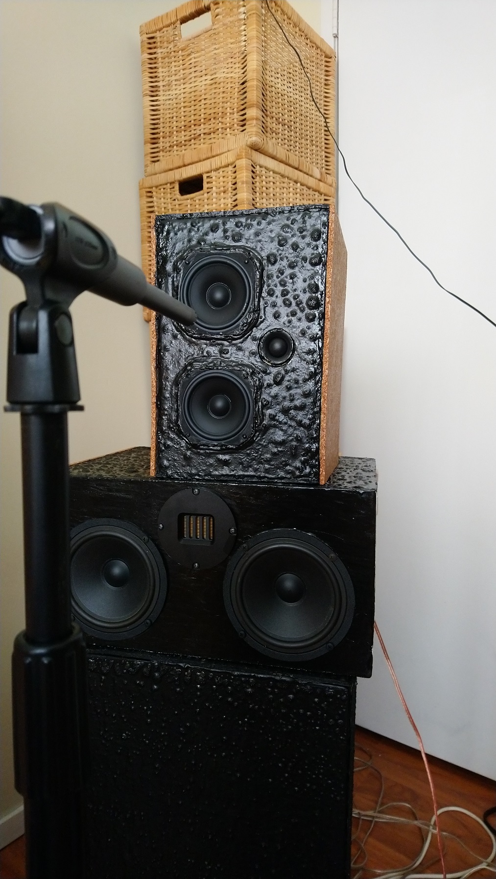

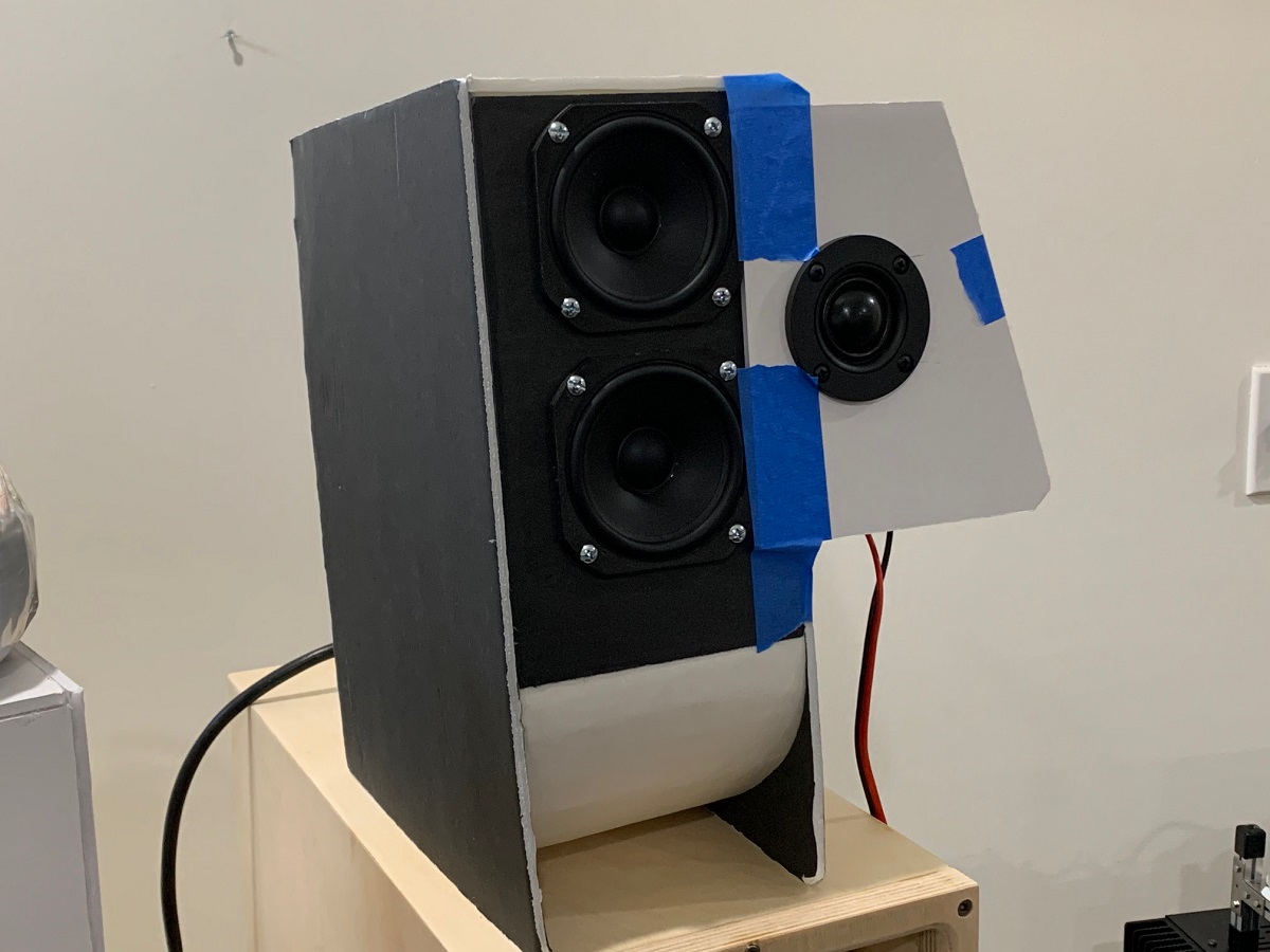

Photo of the setup with a half trapezoidal foamcore baffle to reduce diffraction:
The speaker baffle is 13cm wide and driver CTC distance is 9cm vertical for the TC9FD and 9cm horizontal from TC9FD to ND25FA.

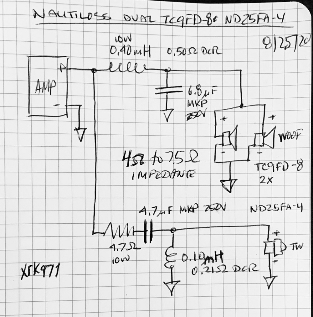

Final XO schematic:
Wago connectorized temporary XO:

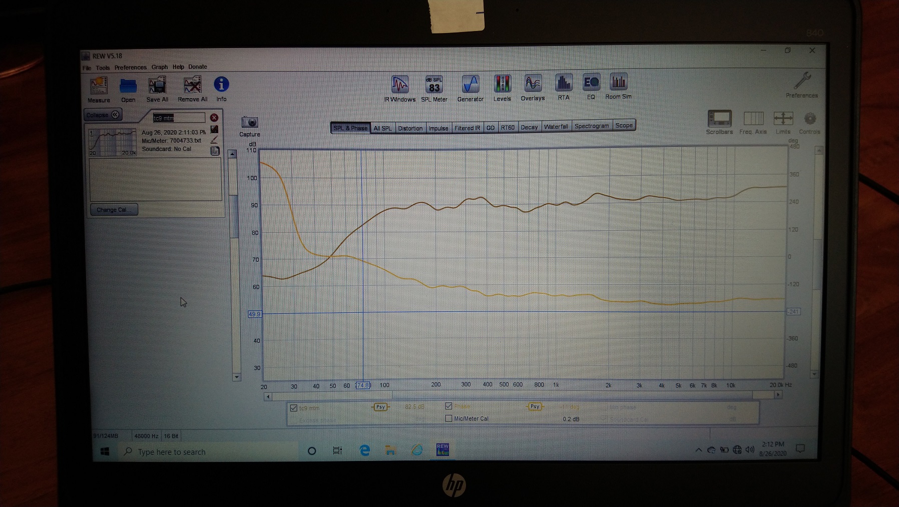

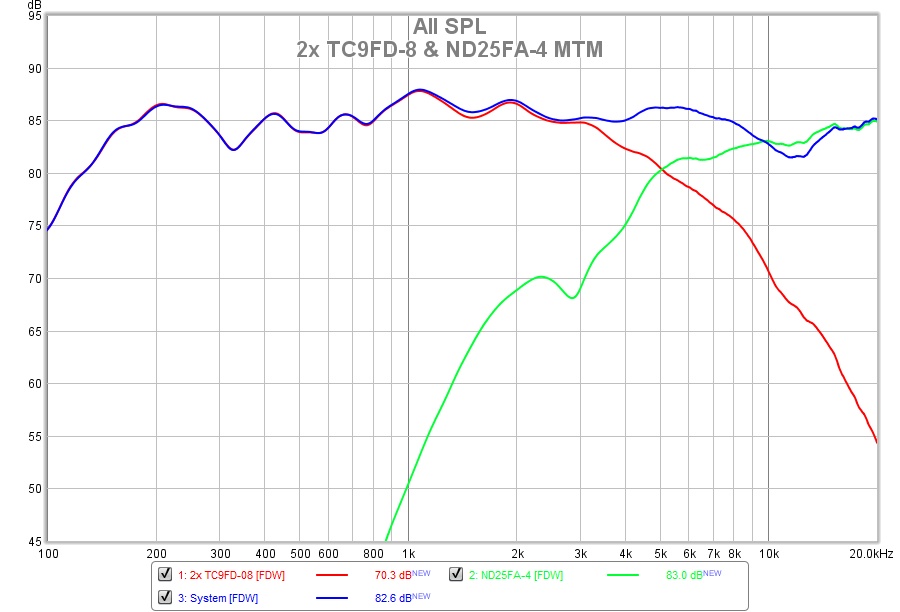

Measured frequency response at 0.5m and 2.0Vrms with mic on tweeter axis, 6-cycle freq dependent window (FDW) smoothing to remove room reflections:

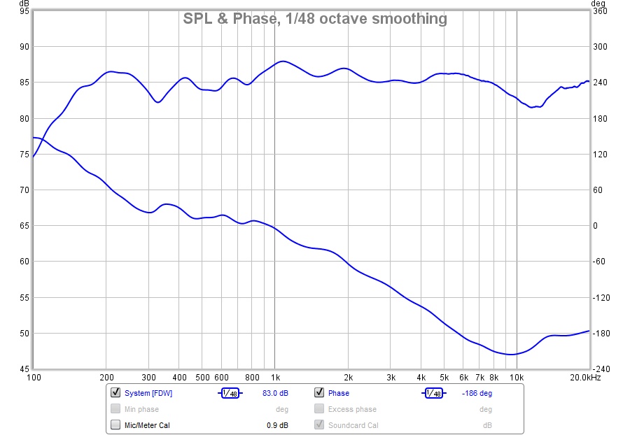

Measured acoustic phase:

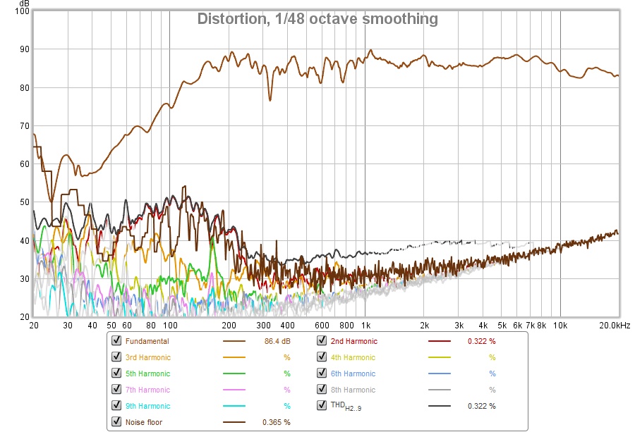

Measured Harmonic distortion (a lot of the stuff below 100Hz is the rumble and vent noise from the A/C system):

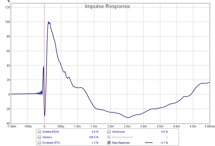

Measured Step Response - nice transient perfect shape:

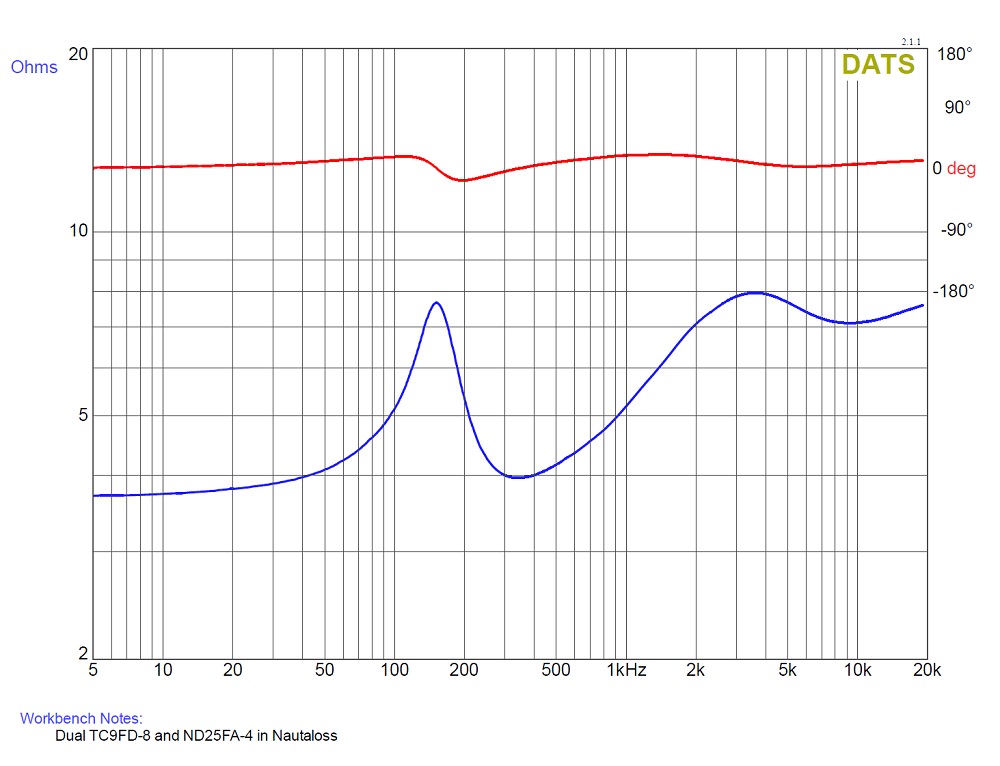

Measured Impedance (varies from 3.5ohms to 7.5ohms):
How does it sound? Well, very good with all genres as it is a neutrally voiced speaker. it could probably use a little more Harman tilt down to the right. It needs a subwoofer or woofer below 150Hz as the sealed Nautaloss has ni bass below 150Hz. It has pretty good sensitivity though at 85dB at 2.83v.
Final XO schematic:

Hi X, great work. Thanks for the interest.
Ok, flat is relative term. I remeasured the speakers today, three years after, and they still measure the same, and there is still the same minimalistic crossover.
So not sure why it did not work for you. Different enclosure? Different spacing between drivers? It worked for kec.
Yes, there is slight tilt up, which I do not mind, once you listen far enough, tilt is gone. If you do not like the tilt, increase the resistor before the tweeter.
Remember, this was not meant to be high end perfect speaker. Its based on $20 drivers after all. It was mean as fun.
Yes, I keep the back open, and only use it from 150Hz up.
