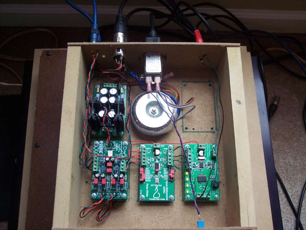

Right now I am just running the DAC in a little test rig box I threw together (all from scrap). It's running in hardware mode (right now, not for long), so my filter options are limited to low,medium,high sample rates.
Later today I will be throwing in a controller with a VFD display to handle volume control and setup. The input will be IR(RC5) and rotary encoder.
I am using the Metronome at 96khz. So I have the filter set to medium sample rate.
I am also find that I really like the anti clipping filter!!! It makes some poorly recorded CDs (way too hot) sound much better. And it does not seem to negatively impact the good ones. Basically it just pads to the digital signal down 2db prior to the analog stage, at the digital filter.
The opus is under the IVY upside down so that all the I2S are short and straight. This is an excellent way to layout the modules.
Also note I am only using one PS. 🙂 this was done for expediency more than anything, but I have proven it works very well.
Here is a picture, don't laugh too hard. 😉
Cheers!
Russ

Hi Russ,
I've seen that wooden box configuration many times before (maybe a different wooden box 🙂). I thought the chip would support several filter modes at a specific sampling rate. From the data sheet p42, with pin 4 you can select the following filter responses: Pin4 (FSEL/DINR): Digital Filter Selection: for 32/44.1/48KHz: 0=Response1, 1=Response 4, Z=Response 5; for 88.2/96,176.4/192KHz: 0=Response3, 1=Response 1, Z=Response 2.
Hi glt,
Yes you very well may have seen this box before I have used it for other prototype work recently. 🙂
Ah yes, it is true you can choose between 3 filter modes. I just have not done so yet. I have been more busy getting the controller up and working. 😉 I don't plan on using hardware mode for much longer.
For now I have that switch open so I am using filter response 2. 🙂
I will probably play with it a bit later.
Cheers!
Russ

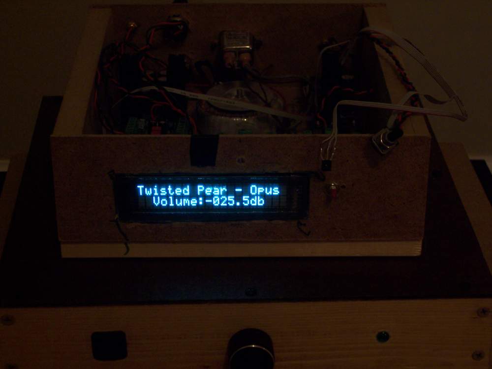

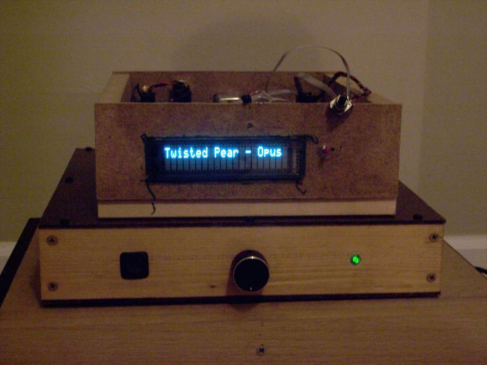

Nearly done implementing the controller.
Again ignore the ugly box it just there to get the thing working. 🙂
I love the VFD. The picture actually does not do it justice. Blame the photographer. 🙂
The controller is just a modified old Joshua Tree controller.
All the hardware is setup now, I just need to write some firmware tomorrow.
Cheers!
Russ

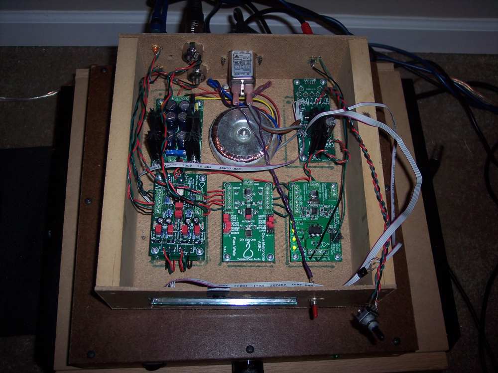

OK I finally got my firmware written. And it worked first shot!. 😀
Now in doing all this I found two issues with the silk screen on the OPUS version 2.0 boards. Neither are very serious, but need to be noted.
I added terminal blocks along with the pin headers pads for a few of what I expected would be frequently used signals. A couple of them are incorrectly labeled.
The terminal mark "ML" is actually "MUTE".
The terminal marked "MUTE" is actually "IWO" or buffered data output.
I will add an errata to the manual, and correct things on the next revision.
Neither should pose a problem as long as the user is aware of the issue.
Now for the working Opus:
It has rotary encode and infrared input.
Controls are volume,mute, and balance (very simple add .5db at a time to either side).
I only used 256 of the 1024 steps available for .5 db from 0db to 127.5db. 🙂
Cheers!
Russ
