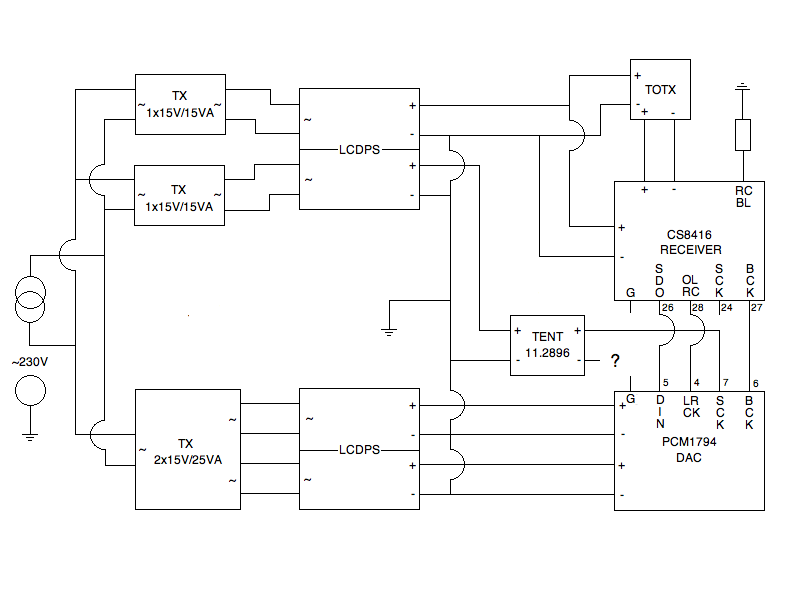

Perhaps someone can help me with connecting a TENT clock to the TP CS8416/PCM1794 (COD) boards. I tried reading the datasheets and found some leads (I think) but this is unknown territory for me.
I attached a schedule that shows the setup I want to use. The connections between the DAC module, receiver module are a guess. I think that the CS8416 needs to be put in slave mode (hence RCBL to ground with R), the clock I calculated as 256*44.1.
Is this enough? Should I put the DAC in master mode (if possible/needed as I could not find it in the datasheet)? Is the frequency correct? What to do with the clock ground? Am I correct about RCBL? And I probably messed up the connections between COD and CS8416
So, lots of help needed. 🙂
Also, a little explanation would be welcome. I will never be able to design this stuff but at least understand it a bit would be great!!

Hi Jeroen,
are you aware that clocking this way will loose/replicate samples? This can work - I've done it with the TDA1543 in NON-OS, but I wouldn't want to make a prediction with a chip like the PCM1794.
I'm not familiar with th CS8416, but the older Cyrus chips need a word clock and bit clock input when run in slave mode. Google around for phrases like "asynchronous clocking CS8412" etc. You'll need some extra circuitry - to divide down for the word clock.
Truthfully, I'd recommend that you go with an ASRC like the Metronome, or simply use the Wolfson receiver from TP with a 12MHz Tent clock if that's your choice. You'll be sure of getting a good working result this way.

Hi Jeroen,
That single input CS8416 PCB is not designed to work in slave mode. So I don't think what you are wanting to do will work, at least not without some board surgery.

Hi Russ,
I noticed that on the board the RCBL is fixed to high. One trace cut and a wire to ground from R7 would do it.... I think (hope).

Well you would need to input the external clock on the OMCK pin of the receiver, and it is connected to GND. There is no simple way to unconnect it. You would have to cut a pin.
The RMCK (SCK) is output only.

Hi Dan,
No, I am not aware... 🙂
Can the ASRC clean up the I2s without changing anything else? Will jitter go down when adding the ASRC and Tent clock? I just want a clean signal from receiver to dac, no (asynchronous) reclocking or something like that.
Would adding the tent clock to the wolfson receiver not still mean that the receiver still generates the clock?
Reading a lot of posts on the forum I sort of concluded that clocking DAC directly would be best.
