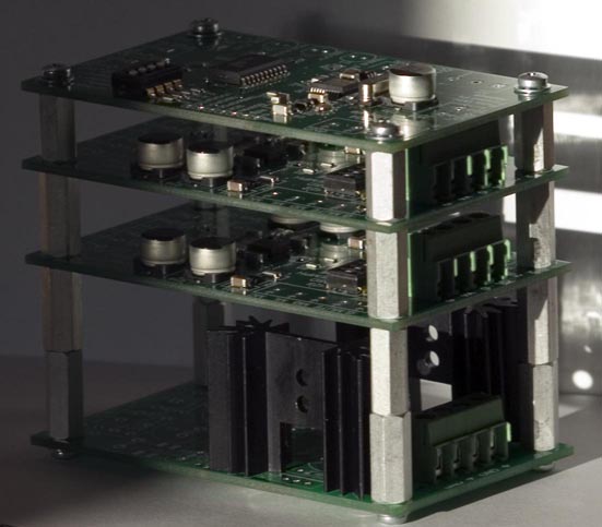

Got the last board today so it's ready to be put together. I was thinking of stacking all the boards on top of each other like in the attached picture. Is there something negative about using a design like this? The only thing I can think of is the LCDPS board being close to the DAC boards but that shouldn't make any real difference.
Also I was looking at transformers and I found one torroidal, 2x9V 30VA which would work fine. But I also found these two:
No picture attached, but the modules were designed to be stacked. I usually place the power supply(s) in a separate stack opposite the power connections of the modules.
The 2x12(12VA) should work.

Your stack should work fine, as would the transformers.
I would suggest though that you move the power supply to the top of the stack, this will aid with the cooling of the heatsinks.
