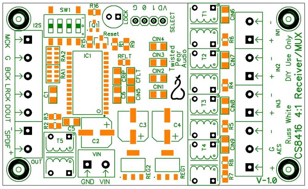

BrianDonegan said:We have a new receiver/MUX coming out based on the CS8416
Do you guys have a preliminary layout of the board you'd be willing to show?
You got it. 🙂
Thanks Russ, looks nice! I'm guessing the i2s output is arranged in that order (MCK, G, BCK, LRCK, DOUT) due to pcb layout issues. Is this in your next batch of modules?
