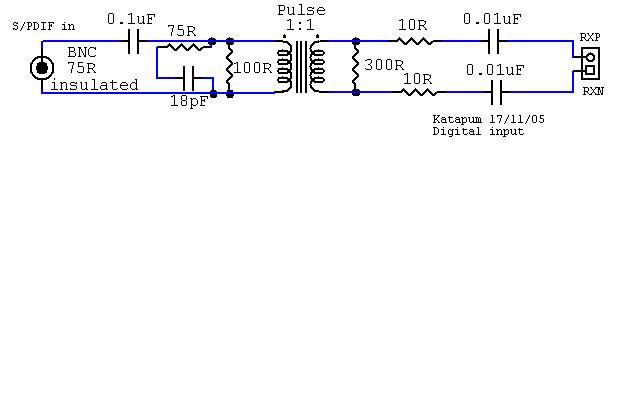

I know I am late The input stage could use some refinement IMHO. I would load the primary side after the cap with 150 Ohm and I would load the secondary side with 150 Ohm too. Definitely keep the input cap, it protects the pulse transformer from DC. A 10 kOhm from the SPDIF-2 to GND wouldn't hurt, it will keep the primary side at low potential when switching cables with the DAC powered on. I used this circuit a lot ( also for inspiration ) but please note that it uses a 1:4 transformer:
http://members.brabant.chello.nl/~m.heijligers/DAChtml/dig_r2a.pdf
*It is adviseable to use a 75 Ohm BNC chassis connector directly on the PCB for optimal results as standard PCB connectors really aren't suitable 75 Ohm devices. Please see the DAC Peter Daniel designed to see what I mean. The circuit with SN75179 also works well but IMO the guideline with semiconductors is that "less is more"....
When I was searching for the right thread I stumbled upon this one that I did not try ( to me both the caps and the 10 Ohm resistors at the secondary side seem useless but I may be wrong ) but you'll get the idea:

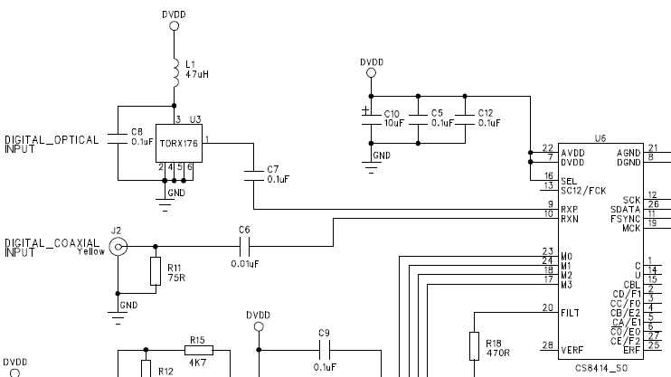

pinkmouse said:Am I right in thinking you are using a power plane and a ground plane? Would you not be better off with a ground plane both sides with loads of vias, and power tracks?
The datasheet encouraged the use of both a power and GND plane.
BTW I am reworking the silkscreen(had some flubbage) and layout a bit based on the input so far.
