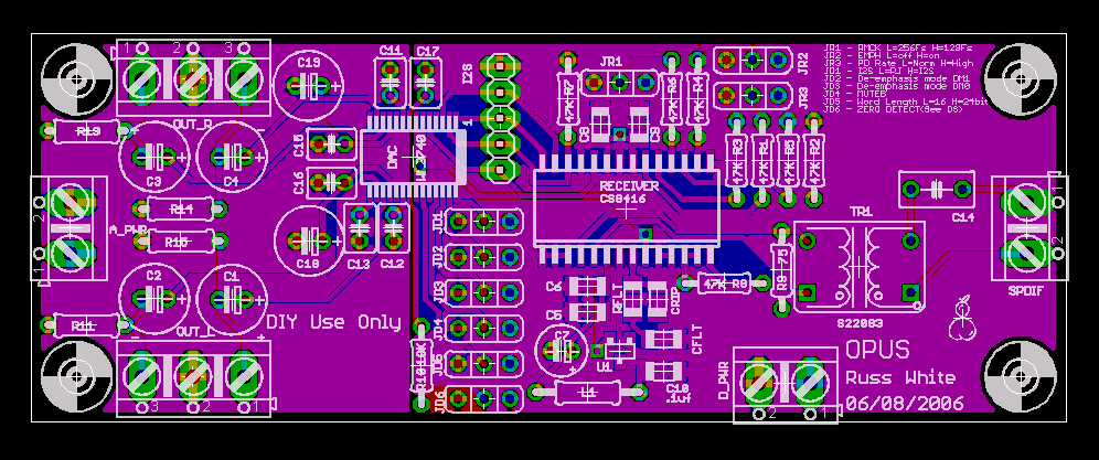

Here is how the prototype PCB might look :)
The output are going through caps so that the DAC output can be used directly. They are AC coupling caps. If you did not have them the outputs would be at DC potential. If you intend to have coupling caps at some other place(say a filter circuit) you could simply jumper the caps on this PCB. In short the caps are there to block the DC. Pretty much standard on a DAC output.

Have you thought about adding in a PCM2902 with all surface mount stuff for a USB input? There is a bit of extra space on the board and you might be able to just add it to this board instead of having another board for just the USB. People can just leave off all the parts if they are not looking for that feature. I think it would be about 16 more parts including the USB header. Oh, if I'm babbling or this is contrary to the design goals just ignore me.
:D
-Naz
Hi guys,
Thanks for the input, I will consider adding USB. if it will fit the PCB as I have it sized. Optical input can actually be done with the current PCB, its just some of the components would be off the PCB.
I would really appreciate some input about my schematic. Is the reset scheme OK? I have heard nothing really on that. Does the basic schematic look OK? I want to get some protype PCBs made, but I don't want to waste money on a circuit that has no chance.
Remember this is my first DAC design. I really need lots of eyes looking at this and giving me plenty of hints.
Thanks!
Cheers!
Russ

And here is the layout so far. I think I will stick with the USB input as second PCB because I want to isolate it more completely with its own power supply and such.
The transformer provided complete isolation of the SPDIF signal, so I see no particular advantage to putting optical input dircetly on the PCB. You can still use it, just panel mount the components and run the input to the DAC side of SPDIF input trafo.
I am really trying to follow the K.I.S.S principle on this first go.

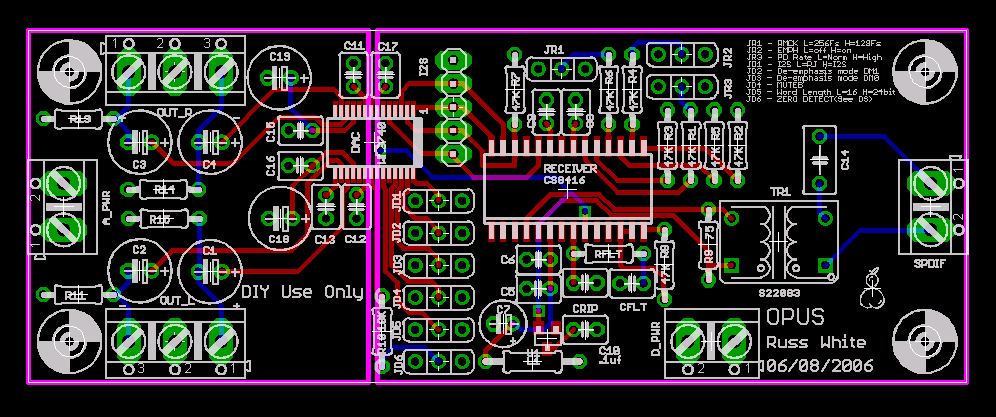

Here is the layout right now:

Russ, this might sound like an odd request, but my color blindness (red-deficent) is making it hard to see all the traces on your board. I don't know what program your using, but if there is an easy way to change the color scheme, I'd appreciate a "color-blind friendly" version (blues, blacks, greens). If not, I'll just squint really, really hard at it. If this qualified for "strange post of the day", I apologize in advance.

Russ, a point or two if I may.
There is no isolation between the CS8416 output and the I2S connector. It is therefore possible for the two outputs to drive each other. Not good. You might want to consider a TTL switch.
The deemphasis bits in the WM8740 should be set by the CS8416 which in turn will be triggered by the deemphasis flag in the SPDIF datastream. I find it unlikely that anyone will open a up case to set the deemphasis bits. I know I wouldn't, I only have one CD that triggers the deemphasis flag.
Finally, you might want to provide the option of having the CS8416 or the external source trigger MUTEB when there is no data.

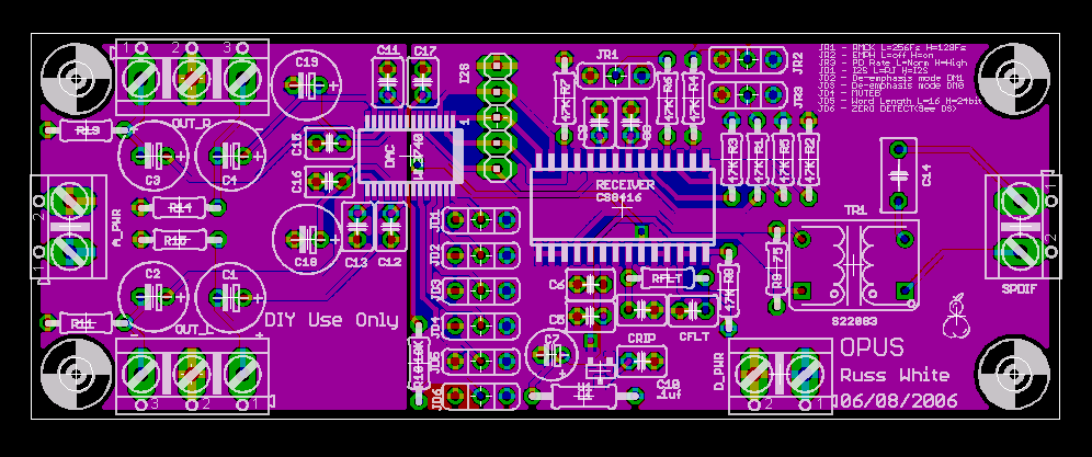

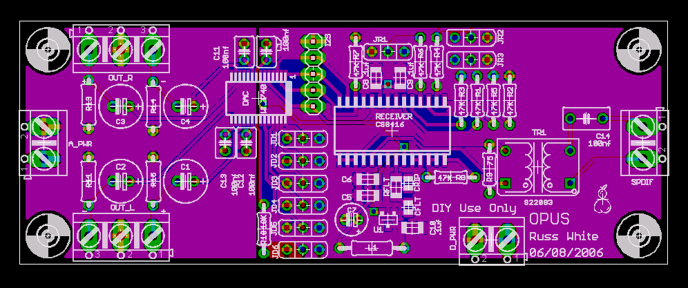

Opus ready to fly... I think...
OK folks,
Time for beta prototypes.
For you beta testers here is what I am going to get made (there still is a little time if you see anything wrong, but only a few hours...)
Keep in mind that I2S header is for playing around with external receivers and debugging and such. If you use you would omit the on board receiver. The PCB s not designed to use both at the same time. You could also use just the receiver and pipe I2S to another DAC if you omit the DAC.
I have several emails from interested beta testors. You will have an opportunity to order a beta board. We will only allow 10 beta testers. Beta testers will get a complete kit at our cost + shipping.
Here is an image of the PCB without the copper pours for clarity.
