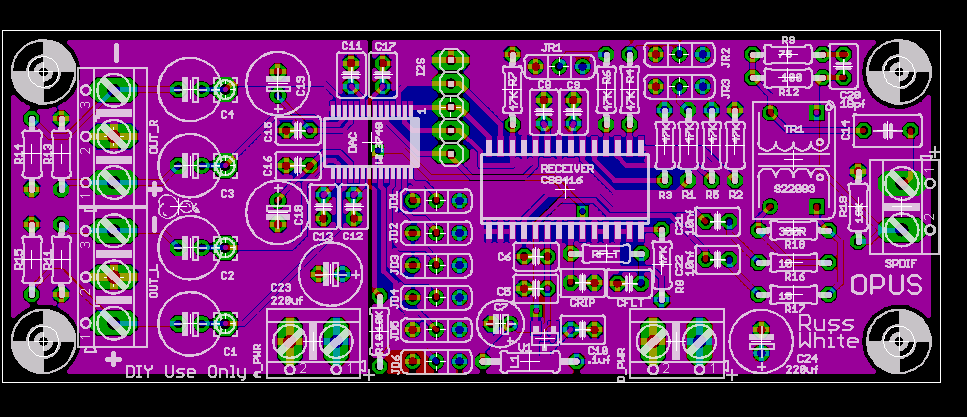

I did read the datasheet. I actually thought it was kinda funny. But, I though people might like these more. BTW, I did say "price wise." 😉
I was actually hoping to use Panasonic FM (ultra-low imped), but they don't have a 10uF. :xeye:
Then stay with the Silmic II caps. They are quite inexpensive as I see now and they're good quality too. Do you want only one brand and type electrolytics in the kits ? Otherwise I'd still recommend using low ESR caps like Pana FC or FM for decoupling the Wolfson chip.

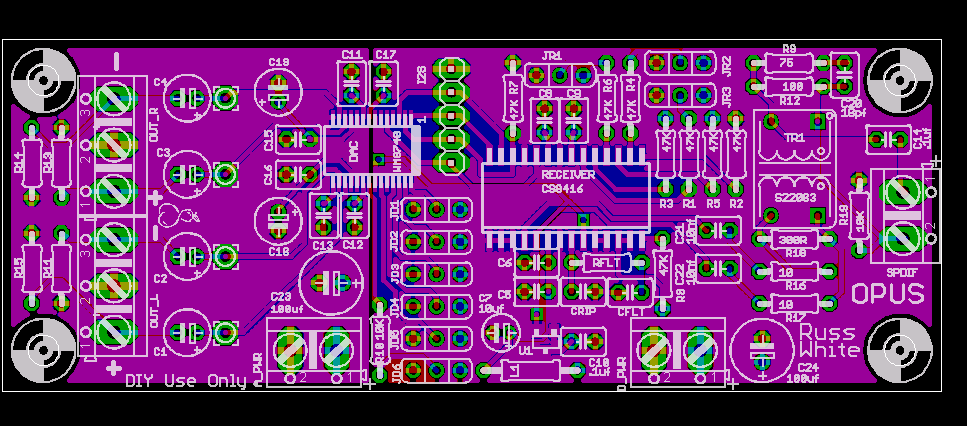

How is this?
Notice the output caps have 2.5 and 5mm pitch. 🙂
Also I used the digital input scheme Jean-Paul pointed me to.
Cheers!
Russ

dw8083 said:
Rather than just grounding the extra receiver inputs, why not run 1 or 2 of them to a solder pad at the board edge? It would make the boards even more flexible.
-David
It is possible, but then I would also have to add two more jumper headers so you could install switches/jumpers to select the input. I am not sure I have room for that. I will check into it. 🙂
:EDIT: I would also have to directly AC couple RXN to GND. I am not sure is that is desirable. You could not as easily do balanced serial input.
Progress report.
I really appreciate the thoughtful input and support provided so far. There are a lot of hours of development in this thing. I am sure many are learning a lot. I know I am! 😀
Beta testers you are putting a lot of faith in me and this circuit. I really do not want to let you guys down. I have no idea if it will work correctly or not since I have no other way to test it but to get these boards made. So thanks for the votes of confidence, but if you are not willing to take that risk, then please just wait for us guinea pigs to finish our work. 😀.
The best way to get success if for many eyes to look at the circuit. I am especially concerned if I am handling the following correctly.
1) Serial data rates (what if I have 48khz signal and then 192khz signal). Will I need to adjust the filter on the receiver?
2) Serial input (though I am feeling much better about it now).
3) Resets. The way I read the data sheet, the only truly necessary reset is on power up, so I think I have it right. I reset both devices at startup.
4) Master/Slave mode. This one still has me a bit puzzled.
To insure interested parties have enough time to review the circuit, I will not order the PCBs until Monday. Please, please, please take the opportunity to review things over the weekend. I will be checking email often until then.
