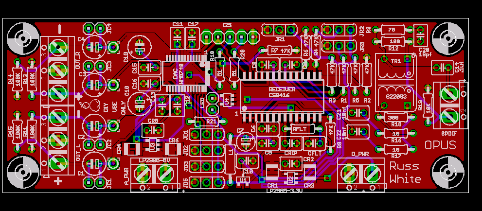

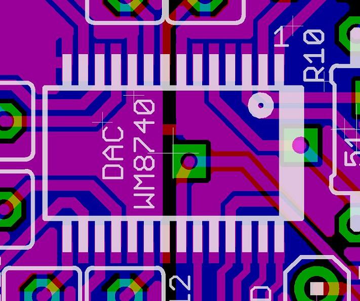

hayenc said:Are you looking to do the AGND to VGND connection like on the eval board? It is a zero ohm resistor under the chip on the reverse side of the board.
Yeah, AGND to DGND. The only way to insure they have the same potential is to join them. I see now how the eval board did it, I wonder if that is the best/good enough, or if there is a better way...

Probably worth putting the pads there like on the eval board. That leaves the options of bridging or leaving off. I notice the eval board has two other sets of pads, but the board is huge compared with yours and you may not need other sets along the ground interface.

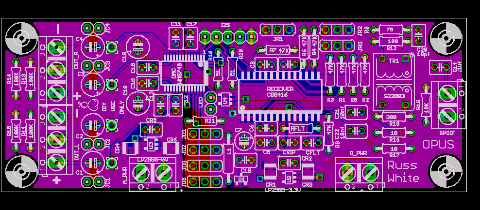

Russ White said:What I did was joined the two planes at a single spot with a very thin trace.. That way people can simply cut the trace if they like, or connect a ferrite or something between an AGND pad and a DGND pad.
That very probably is a good solution and won't need a change at all. The PCB looks OK and complete, certainly for a beta version. I do not see errors although I do not have enough time to reread datasheets of both the chips so I might not see mistakes. I hope rfbrw is around to check things over. Series and/or termination resistors for I2S use would have been nice but the board would have to change too much.

This ground link under the chip might or might not be a good idea...

I suppose you mean this part...
I have seen both sides of this argument more times than I can count, yet I do admit to being new enough at this science (and art) to not be authoritative on the subject. That said, in the end practicality must prevail. I do have to "actually" finish this thing you know. 😉 My solution is close to the manufacturers own, so it must be close to acceptable. I hope.. 😀
That counts for me too. But I know Guidos expertise in this matter and trust his opinion. Maybe the trace can be 7 times wider so that the planes really are connected ? It still can be cut with a Dremel if one wishes to connect groundplanes with a ferrite bead or 0 Ohm resistor.
Guido's comments about power planes seem to agree with much of what I have read from other sources, as normally power planes are used as internal layers in four or more layer boards that have ground planes as the outside layers on both sides.
However, if you follow all our suggestions you will probably end up with a completely different board to the one you posted to start with, and a redesign that will take months! 🙂

Are you sure this is still a beta version Russ ? It is looking better by the day. To be honest I did not even see the powerplane, probably because the colors resemble eachother on the picture.
