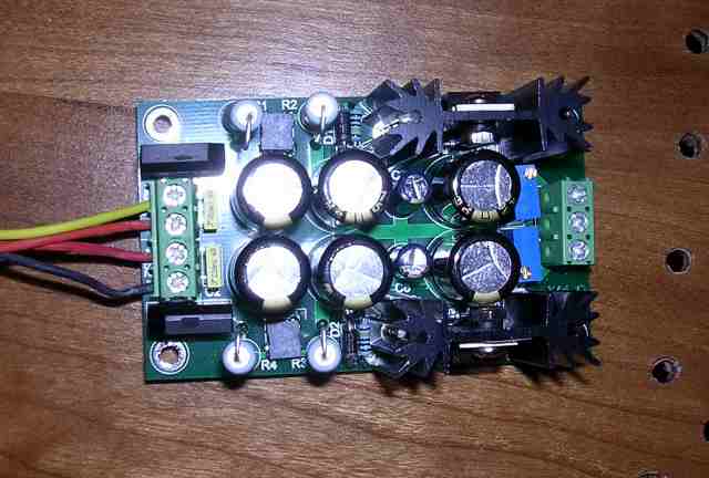

Having issues with LCBPS for Balsie
Guys,
I'm finishing up the assembly of my DAC and I was checking out the power supplies before I hooked anything else up. The LCDPS for the reciever and DAC modules looks fine and I had no trouble adjusting the output to 7.5 VDC using the pots. However the LDBPS for the balsie doesn't seem to be resopnding to the pot adjustments. On the tranfo inputs I'm reading 17.2 VAC across the blk & red, and across the yellow & orange feeds to the PS. On the LCBPS outlets I'm reading -20.6 VDC and 21.3 VDC between the gnd and - & + terminals. Adjusting the pots does nothing at all. I've included some pics of the hookups. What do you think I'm doing wrong?
PJN
Guys,
PJN
