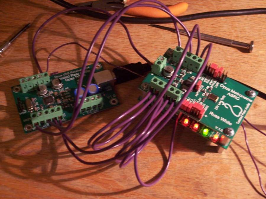

Just for fun
I wanted to test all of the feature of a couple of our modules. So I rigged up the following.
USB module ---> Metronome(ASRC) ---> Transceiver (WM8804)
I took just BCK/LRCK/DATA from the USB module simulating a CDPro or similar situation and ran it int the Metronome. SCK is an output on that board anyway so you would not connect it in any case.
Then I took the I2S out (including master clock) from the Metronome into the WM8804 transceiver module. The metronome is setup to re-clock at 96/24 with a 256fs master clock.
I set the transceiver module to be in AIF slave mode (AIF clocks become inputs). And used the SPDIF output of the transceiver. This goes out to another dac. Well it works very well. And even sounds very nice!
Now in the pic you will notice the SPDIF input flag lights are red and non-audio LED is green, thats ok because there is no SPIDF input, just output.
