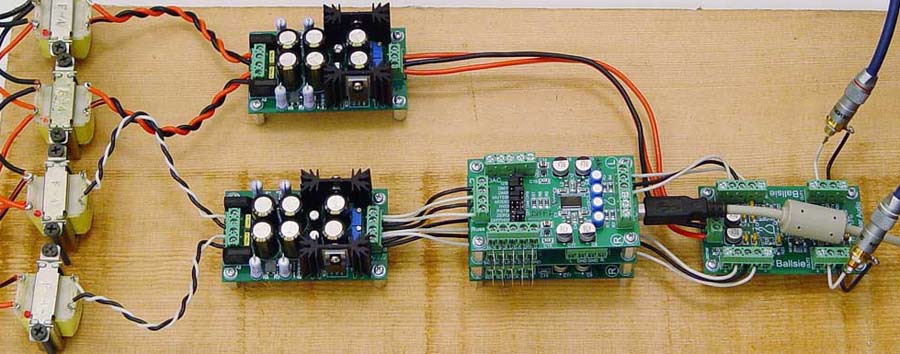

Thank you Russ and Brian, my Opus went together easily!
Line up- Mac G5 usb to i2s>Opus dual mono>ballsie>rebuilt Grundig PPEL84 amp>Optimus LX4 speakers....my little computer listening system.
First impressions- Wow. Great imaging. Smooth, but articulate. Clean. Bass? Yes it’s there, just not the flubbery loose kind. When it's raising the hair on the back of my neck- it’s got to be good!
Admittedly, I am comparing to the computer's dac. I cant wait to get it on my main system!
I can't stop listening to my music!😀 Darn, you! I've got to get work done!
My pic- quickey breadboard set up. The opus differential outputs were hardwired underneath, thus only 3 wires seen from opus to ballsie.
I plan to hardwire most of the boards together in the final form.
Thanks again for such a great kit!😀
-Kent

Excellent work! 🙂
That photo will make a nice reference for other builders.
I am very glad you have found the project enjoyable. I have been having a lot of fun with it too. 🙂
Cheers!
Russ

Kent,
it might be worth experimenting with bypassing the filtering resistors in the ballsie's power supply. I suspect doing so will improve bass/dynamics.
Yeah, the Opus is great fun, whether building to the original recipe or as a base for experimentation.
Dan

Spartacus said:it might be worth experimenting with bypassing the filtering resistors in the ballsie's power supply. I suspect doing so will improve bass/dynamics.
While that might be fun to try, I actually doubt it will actually have much effect. Though it probably won't hurt much either 🙂 Noise wise, it is likely to be worse.
And actually there are two version of the split rail PS, you may be referring to the older one, the newer one has a common mode choke in addition the the CRC of the old one. Bypassing the resistor(with a cap) with the choke in place will effect the filter, and not for the better unfortunately.
Kent has the newer one with the choke.
