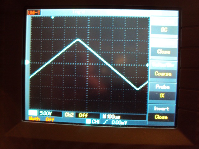

First is the clipping behaviour. The generator puts out 20V, my limmit. You can just see a small rounding of the triangle wave, similar in positive and negative direction.

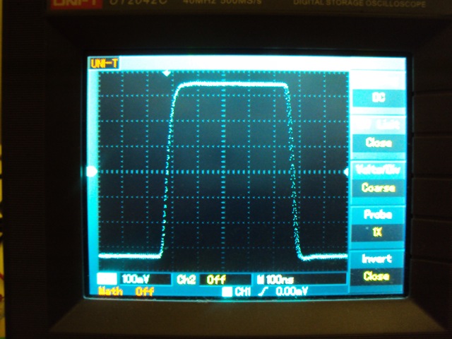

Then a 1MHz squarewave, this time with a 150 Ohm, 33pF input filter.

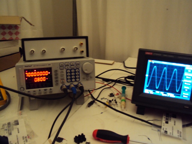

Last the -3dB point at 7MHz with the 150 Ohm, 33pF filter.

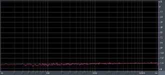

This is a simuation of distortion in reference buffer 4. That was an early prototype. It has been developed to perfection in the meantime but i have not made any real distortion measurements. Distortion is too low to be an audible problem anyway. Distortion on that low level may still add some "character" but it will not audibly sound distorted i any way.

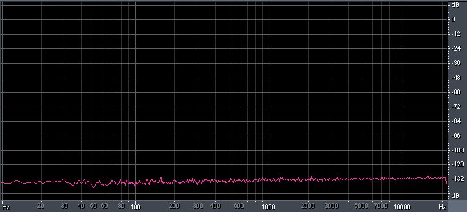

It´s hard to say where we put the frequency to define dynamic range.
That's not how it is done. For SNR and DR you have to integrate the noise over the bandwidth of interest, possibly after applying a weighting filter.
Further, the position of the noise traces on your graphs are a function of the FFT's bin size. The numbers you read there are thus meaningless.
CD doesn't have > 98dB dynamic range, but if you plot the noise of a 1-bit TPDF dither track in a 16 bit system, with a 65536 points FFT, the line is at -132dB below 0dBFS.

For N-bit digitizing, and M samples in the FFT record, one can get the noise bottom, apparent S/N, as low as:
S/N = 6.02N + 1.76dB + 10log(M/2)
So for 16 bits and 200 000 samples you may get 148 dB of apparent S/N. This is of course no real S/N, but something like spectral density at the bin size used, as Werner has already said.

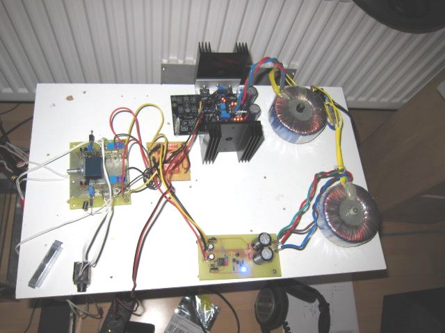

Hello, to all those people who are interested in this thread.
As promised, I did a comparison of several PSU units, to feed the line stage designed by JG himself.
But first I have to report, that I have changed the 4,7K feedback resistor from metalfilm to naked Z-foil. Hey, again a step forward, much more sweet music came out of my speakers. This is a have to, if sb wants to rebuilt this wonderful linestage. More details, stage and a fantastic bass!
Ok, back to the PSU comparism.
These have been the candidats:
1. Salas PSU, with the suggested upgrades and 11R at the CCS
2. Kubato Regulater from China, a friend has built this.
3. Sulzer PSU
4. LC Audio PSU
5. Usual 3 leg PSU, but with LT337 und LT1086
My setup: Mod. Philips CD 820 with I/V Stage from Spencer
Hirage 8 Watt class A, Tantal and Vishay resistors, KimberKable
Speaker are Fostex FE207 in MLTL-Design from M.King, mod.
with Phaseplugs and Damping à la Planet 10
So I liked much:
1. Salas Hypno PSU, best bass and details.
2. LC Audio, maybe a little weaker bass, but voices are very sweet, I liked that very much. And my wife liked it best.😉
3. Sulzer PSU, not so fast, bass and details are a bit weak.
4. China Kubatu regulator, bass details and musical athmospere are missing.
5. Standart 3 leg PSU, sorry the other's can do everything better.
Remember this are my personal results!
What I have to say is, that the differences are marginal. Even with the standart 3-leg PSU it is a very,very, good sounding linestage!
I have compared it with my Kaneda linestage ( Tantal-R, Ladder Attenuator, Kaneda PSU), so I will say, if you compare the price for parts of the Kaneda and the FF2010, there is no choice for me, what I will do next.
Last thing I will do, is using 2 x12V lead batteries and the JG coils. And, maybe the SuperTeddyRegs.
Let's have a ear!
