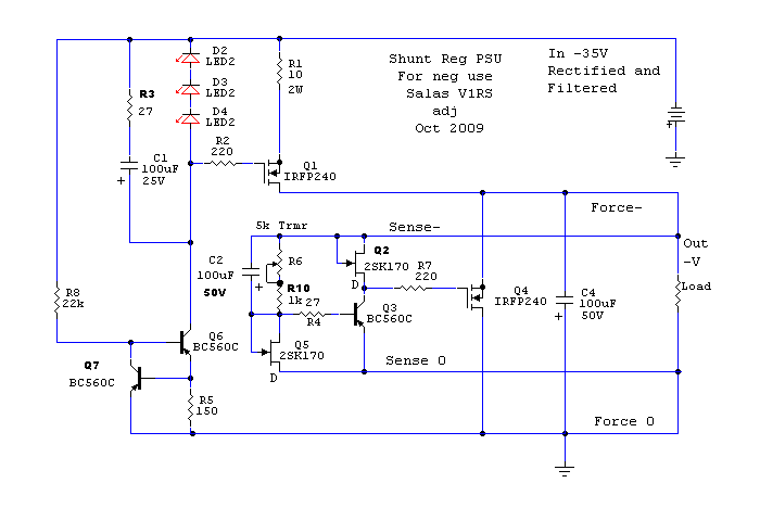

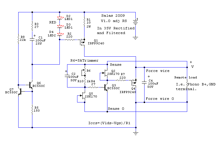

Those two should help you out. I dug em up and did sync the designations.
Up to 28Vout +/-. With 10R R1 shown circa 200mA CCS, exact current depending on LEDS Vf and Q1 Vgs, I noted the CCS formula so you can set them for current at will. Keep a 2:1 to load if able to sink.

Yep, just tweak those R6 multiturns. If you want best ppm there, sub with nice resistors after you find proper values by trimming. You can limit your DCin to 30V if your roof is 24Vout, to save some dissipation. C2 is influential for tone, choose/bypass as you know best.
