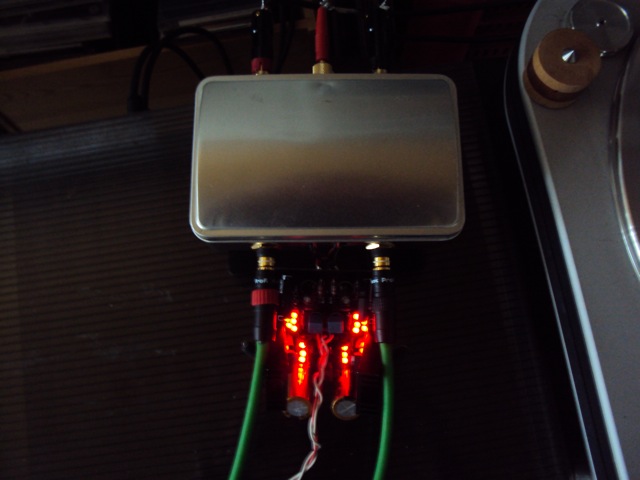

This is how the tidyed up setup looks now.

Remember, when you add resistor to extend Vout as in the guide, you lose the benefit of bypassing the Vref with just mini MKP. You will need theVref bypass lytics back, else the closed loop gain is going to suffer in the lows. Full LEDs for 10V can do it with only MKP, resistor is a passive Norton ref. But you still can use one 1837 under each lytic for some help.
Did you have any better experiences with the additions of Nichicons, 1837s, 160mA CCS, shorter cables? Listened more?
Yes, i listened more. I kept the circuit under current all the time. As i already said, noise dropped and bass got more robust. I have no objections any more in the treble so this is a full success. I also finished my buffer. When you see the diagram, you maybe disappointed. It is very similiar to PMAs and has only best praxis and some little tricks that inprove the sound in my opinion. It does what i want though.
Posting will be in 10 minuts and i will include a picture of the build.

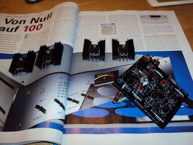

I am building a second Hypnotize to supply another experimental stage. I need 2 x 17V.
I mounted the Fets on bigger finns this time. That makes some mechanical trouble but i can solve that. I will use 6.8 Ohm set resistors this time. I have already mounted the two Leds with the test resistor. I use a 250 Ohm because i did not have a 200 Ohm. I have to go though Salas text ones more to not make any mistake. I start to understand this circuit better but not in full and i am really fascinated that it gave such a good improvement in sound over the LC Audio. I am using a split bobbin frame transformer with 2 x 18V AC.

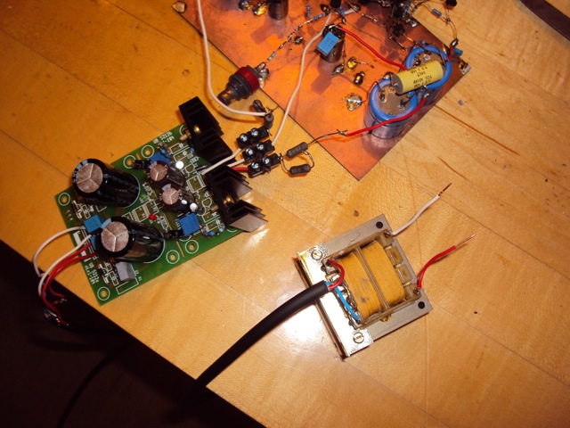

I have used that transformer for a standart 2 x 24V supply before. See picture.
