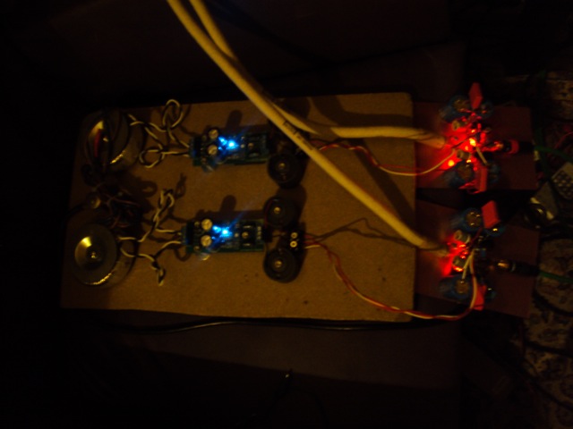

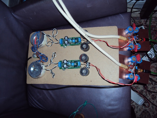

Today was the first time i put the Open Loop Reference Buffer 4 into the system. Until now it existed ony in simulation and on the bench. For safety the class a output stage idles on 15mA and i will try to raise that up to 100mA while listening and measuring. The only time i had listened to various settings of the iddle current in an output stage was when i developped my headphone amp. It sounded better and better, especially in dynamic slamm and in the bass until i hit 75mA and then nothing more exiting happened. But that was with the 60 Ohm load of my AKG701. This time the buffer has to drive a 5m video cable and a 10KOhm pot plus the input of my active woofer so i may come up with another optimum. I also have some issues with the Leds that bias the circuit. Some of them light up bright and some are quit dimm. Maybe i mixed up high efficiency and standart types but instead of finding that out i will build a second set of buffers where i check that right away. What i did the first time too is that i totally seperated the two channels. I have monoblocks and only at the input of my woofer crossover is a common ground. Normally, even when i do a double mono circuits i do a common ground somewhere on the PCB. This time i am able to experiment with a jumper. I listened only breefly and with low volume because my wife is already sleeping. I could hear no hum or hiss, that i can say but the sonic evaluation has to wait until tomorrow. I will also listen against a staight wire bypass. The buffer is then at a slight disadvantage because it looses around 0.25dB of gain. When big differences arise i can of cause make the gain similiar with the pot. See a photo of the setup in the next post.

Here is a picture of the buffer, with and without flash. I let it burn until tomorrow and then listen. I have two hours left so i will work on the +-17V Hypo. The picture shows the current state. 200 Ohm test resistors in the minus feed not installed yet. I have to go again through the sugestions.

That's another use then. But if the LEDS are from same intensity batch and Vf matched, then it must be different currents. One or another. You got to be sure by installing new LEDS from sure batch first. But I have also seen a 1.75Vf LED surely dimmer than a 1.82Vf LED from same bag for 5mA for instance.
Good sugestion, i will measure the batch before i install. Anyway, the buffer is working and the Leds that do the dirty job are similiar if not ideal still. Idealy i whould need a Led
( or a string of two ) that drops 3.2V at 3.5mA so you see my dilemma. A blue one ? A mini string of IR ? Who knows.
I tryed two red ones in series that should give 3.6V and that is close enough but they where starving in the circuit and gave only 1.8V in total. I ordered a batch of red and green in high efficieny and normal. Not a big issue, i have time for this experiment and will find a solution as usual.

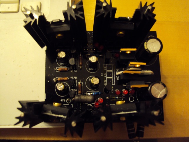

setting the Hypo to +-17V without load was not a big deal. I got 17,3 and 17,4 volt fast and easy. Connecting the ULN phonostage the voltage dropped to 9.7V positive and 15,5V negative so it draws more current from the positive side. Offset management was still not upset and i measured the same values as before. That is a good experience because that offset had caused me lots of trouble in the beginning. I will make the rest of the adjustments next day. By the way one shunt mosfet gets now warmer then the other but that is logical. Slowly i get into it. It´s fun by the way.
Give it a good margin of CCS:Load. 2:1 if it can take the heat I would recommend. Measure load current with 317/337 handy PSU in each circuit before you set Hypno's CCS for different CCTs. It will save time in resetting.
