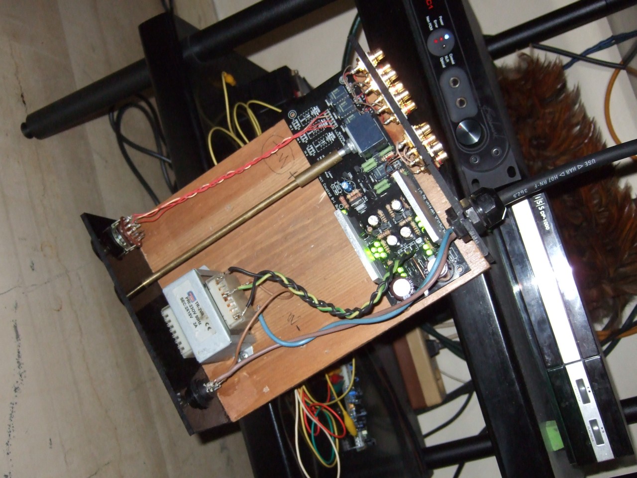

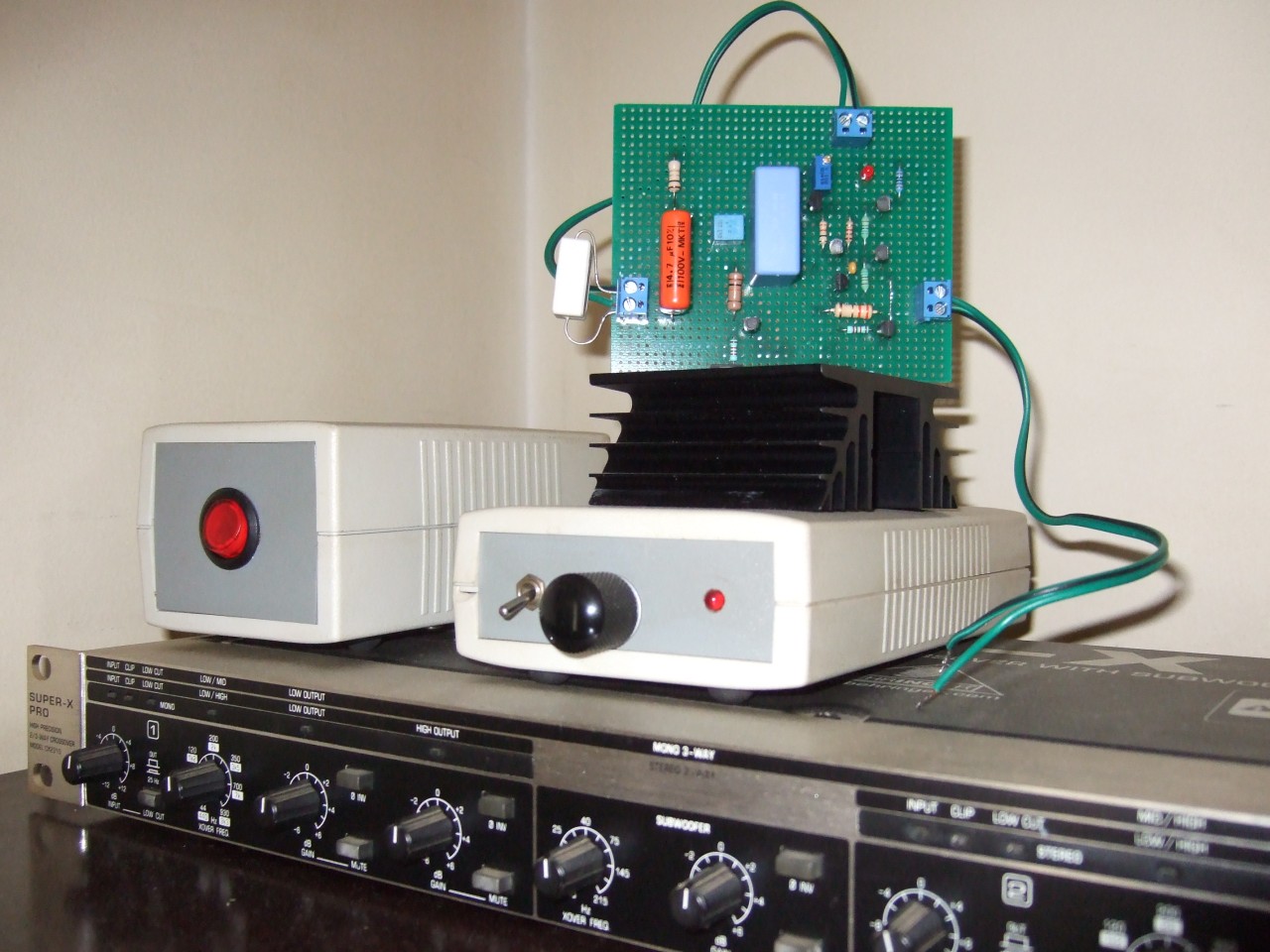

This kind of buffer ups its (very small) distortion little by little with input level. Mainly even. The JLH type compound JFET BJT follower holds better THD with level but ups odd harmonics. Has 2 more elements and a trimmer in signal line. Which one you prefer in a situation like after Aero? Did you actually test? I think you had one like JLH in a phones amp at least.
P.S. I got DCB1 in two builds. One with series regs (two small plastic boxes one just has the trafo), and one with shunt regs. It listens a lot to supply intrinsic quality.

I am using the JLH now most of the time and use the PSG buffer only when i need it, soundwise that is. I have rebuild my HeadPhone Amp with my version of the JLH and the sound difference was smaller then i expected. Maybe the JLH is slightly more tranparent and it is cheaper to build. A PSG could of cause be build with selected 2SK170.
