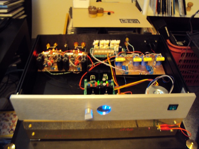

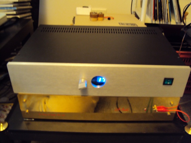

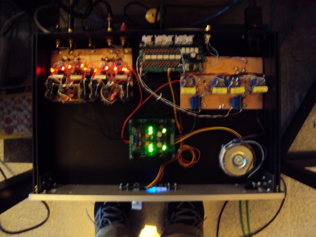

Over the weekend i finished my first complete preamp including cabinet. Actually it is not ready yet because i am still working on some subassemblies.
The phonostage is a High Z MPP, volume control is a Tent Labs relay module with remote control and the output stage is a PSG buffer. PSU is a Twisted Pear Placid.
I call it Markus because it is for a very god friend and mentor of mine.

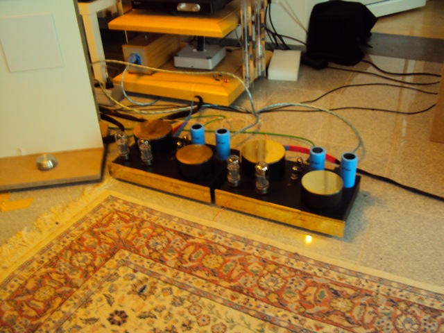

After Allen left i took a deep breath and thought how i can get part of the sound back we had. Markus visited me today to see the progress his preamp makes and we tried al 4 poweramps i have at home right now. The Berentzen Special Edition, an LFD poweramp,
A Strada Digital amp and my LA Audio Monoblocks. I had dusted them of some weeks ago found 4 output tubes that match well, adjusted the bias to AB ( ca.70mA) and switched into triode mode. Fortunately the LA Audio saved my day. It sounds beautiful on my MPL.
On loudspeakers with medium sensitivity i prefer the Berentzen but my MPLs sounded much better with the tubes. I think this is a good compromise i can live with until i make
my own Poweramp, but not soon, i am too busy.

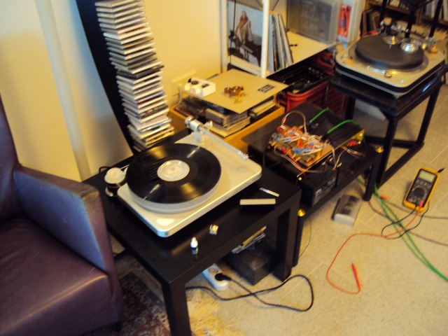

Another photo shows the little Cearaudio turntable with Lyra Helicon. It sounds very good. A super expensive turntable is not the only way to good sound. The cartridge and the setup is very important too

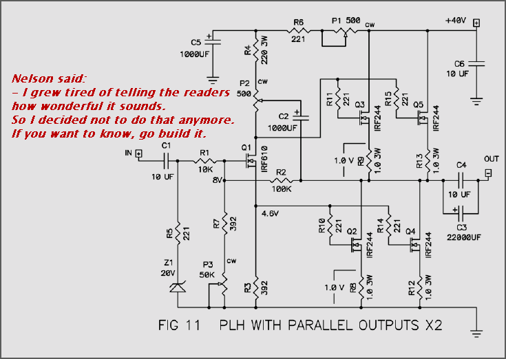

I think you need to try this circuit from the one and only Nelson Pass.
Try this with your speakers, you'll love it!
Firstwatt is also good, but I seem too have a weakness for these kind of amps. Nelson is a brilliant designer when it comes to building a musically "simple" amp that sound like a tube amp 😛😛😛
And when my Mono triodes are ready you'll be the first to be invited to listen to it! Well, together with Jaap if you don't mind driving a few hours 😉
Audiofanatic 😉
