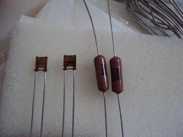

Today i made more listening tests to loading resistors. The good news first : The 300 Ohm
TX resistor sounded much better then the 1Kohm. The thinness is gone replaced by a totally natural tonal balance. So again the message is that the value of the loading resistor is critical, maybe even more then the type provided you use a "good" one.
To describe the difference between the TX and the Dale RS65C ( sorry, i named it RS65E before but it is a C type in fact) is much harder. Both resistors sound better than all others i tried including NOS Tantal, Mil.Spec. Wirewounds, Caddock 132 and Dale RS55 unmagnetic. Tonal balance and resolution of micro detail is very similiar in both cases.
The TX sounding dead neutral and the Dale very slightly warmer. Concerning speed music sounds very fast with the TX and the Dale not far behind. I whould say that the Dale has the edje on older material like Hellen Merill in Tokyo and Katy Lied by Steely Dan. It is slighty more convincing on thoose tracks. Somehow it sounds more relaxed and magical. The focus is more on the music and less on the sound if you understand what i like to say. On modern Electropop and Funk like Electribe 101 and Nona Hedricks
the TX provides the more exciting ride. Listening to this kind of music on high volume left my breathless. No time for analysis.
The biggest differences apeared in terms of 3 dimensional soundstage presentation. The TX projected voices more forward and less high. The Dale had amasing height projection. On Hellen Merill i had the feeling that she was singing 5 meters away and 2 meters over my head. I can not say what i more accurate but i certainly enyoyed the Dale more in that regard. It gave a kind of hyperrealism that i only experience seldom in very high resolution Audio. It can not be compared to the life experience and seems to be an artifact of reproduced music, still it did not distract from enyoying the music, quite the oposite. I had that experience when i tested resistors for speakers and the good old Welvyn W22 was the most spectacular in that regard. I have shown that effect to several people that visited me and it never failed to impress. Why that is so i have no idea. Later the day i will download even more. I have a 138 Ohm TX and a 150 Ohm Dale RS65C for that. I also will listen to classical music first with the 300 Ohm resistors.
One remark : I whould rate both resistors to be in he same quality class so the Dale is a huge bargain when you have the space to mount it. Some TX could be thrown in for good effect if you like a more "Matter of Fact" sound. For comparison of size i made a photo of the tested resistors side by side.

I've overlooked your marks at the end of the document. For T5/T8 I cannot find a BF446A JFET. Did you mean BF246A? In addition have you ever tried a lower beta transistor like the BC547A and BC557A for T6/T7? A higher beta results in a lower early voltage so y22 is also lower. As y22 is quite non-linear a high beta transistor has a higher distortion level when used as cascode transistor / common base circuit. At least in theory. I've never confirmed that in a real circuit as I ever used the lower beta types like the BC547A instead of a BC547C in this application.
Sorry, some mistakes came up. Yes, it is an RN65C. You can get it at Mousser.
The P/N is 71-RN65C1500F for the 150 Ohm for example.
yes, the Fet is a BF246A.
Yes, i tried lower beta in my Balanced INA desing. I used 2N4403, 2N4401. Anyway, i am very happy with the performance with that circuit. Distortion is around -90dB at cruising level. Other people sugested other transistors then the BC550C/ BC560C too but it is simply imposible to try everything. Do you have any sugestion ?

Is it the Dale RN65C ? Can´t find a RS65C anywere...
I believe I can read RN65C in the picture...
