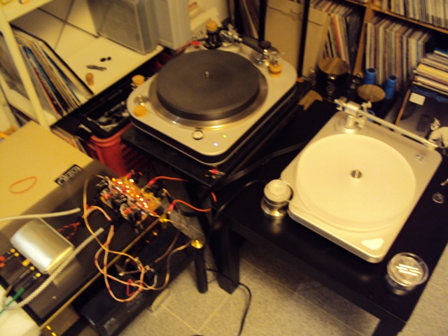

I am building a preamp for a friend. For many years he was listening to CD and never wanted back to Vinyl. Until the day i brought my turntable and phonostage to his home.
Now he gets a preamp with High Z Capacitive MPP, Tentlabs volume control ( he wanted remote) and PSG buffer. That buffer improved the sound of his AudioAero CD player a lot.
Eather someting is wrong with the digital volume control on that player or the PSG adds some extremely pleasing distortion. We cranked the volume control on the CD player full and then added the buffer with a conventinal TKD pot as an experiment and he was blown away. Anyway for his Pre i choose the Placid PSU from Twisted Pear. Actually this is my first experience of a Shunt PSU on my equipment and i tested it out on my Headphone Amp. Compared to the LC Audio with inductor i heard an improvement but it was not night and day. The Headphone Amp has superb PSU rejection and even with simple 9V blocs there is no hiss or humm at all. The placid had a slightly softer sound i prefered because most CDs are a bit hot and compressed to say the least. The Placid made CDs more pleasant to listen too. Quiet pasages where more quiet so to say and i heard some micro details that escaped me with the LC Audio PSU. Bass was on the other hand was more clear and detailed and even a bit tighter and extended.
See also a picture of my frieds Turntable that i have around for adjustment. It´s a Clearaudio with magnetic bearing and for 2000,-€ you get it with a good arm and cartridge. I substituted the cartridge with my Lyra Helicon and will that replace again when the new Delos comes. It sound really great and i was surprised how little the difference to my 35.000 € monster is. Well the little Clearaudio does not reach the mastertape precission of my setup but it is very dynamic and alive sounding and makes lots of fun. Rumble is extremely low courtesy of the magnetic bearing and speed stabilty is good. I have it sitting on a simple Ikea table but touching the surface with my hand, vibration was very low. That simple silicon feet that are fitted work exceptionally well.
