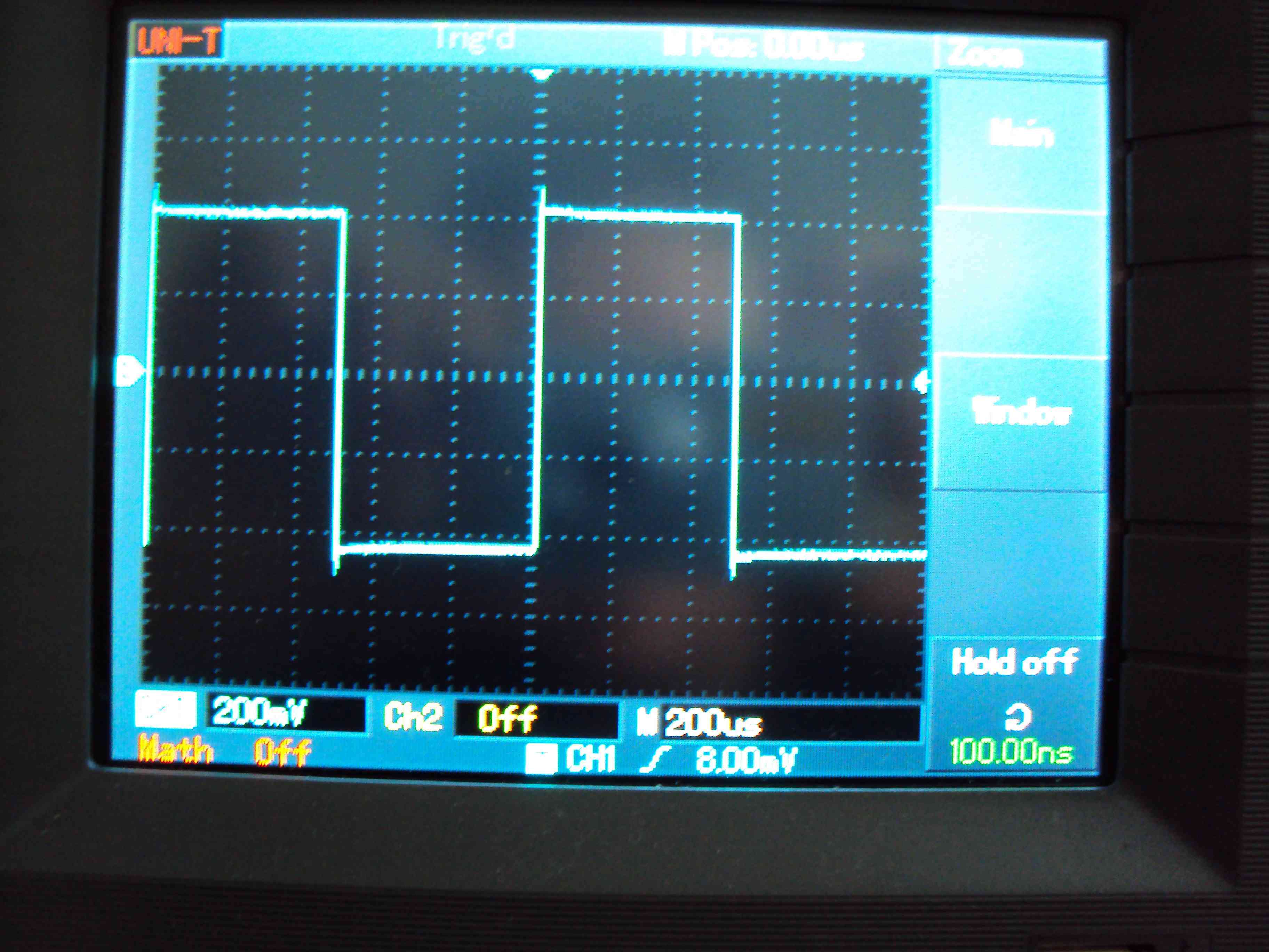

MPP
The Scope is a UNI-T 2042C.
I think the slight downtilt comes from the 2uF cap i use between the MPP and the Inductive RIAA ( 47kOhm Input Impedance) and the Inductive RIAA has a small lokal rise of 0.5dB at 20Hz. Same result on the DAAS. The serial resistor in series with the inductor could be finetrimmed but i kept it that way because i like the sound very much.

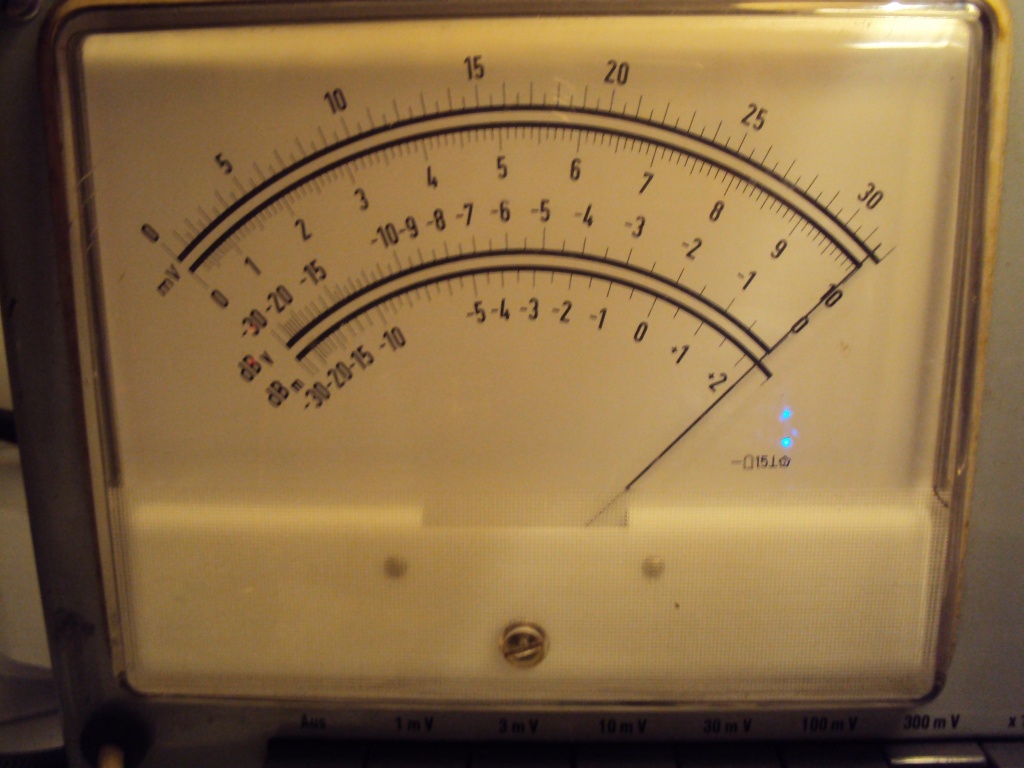

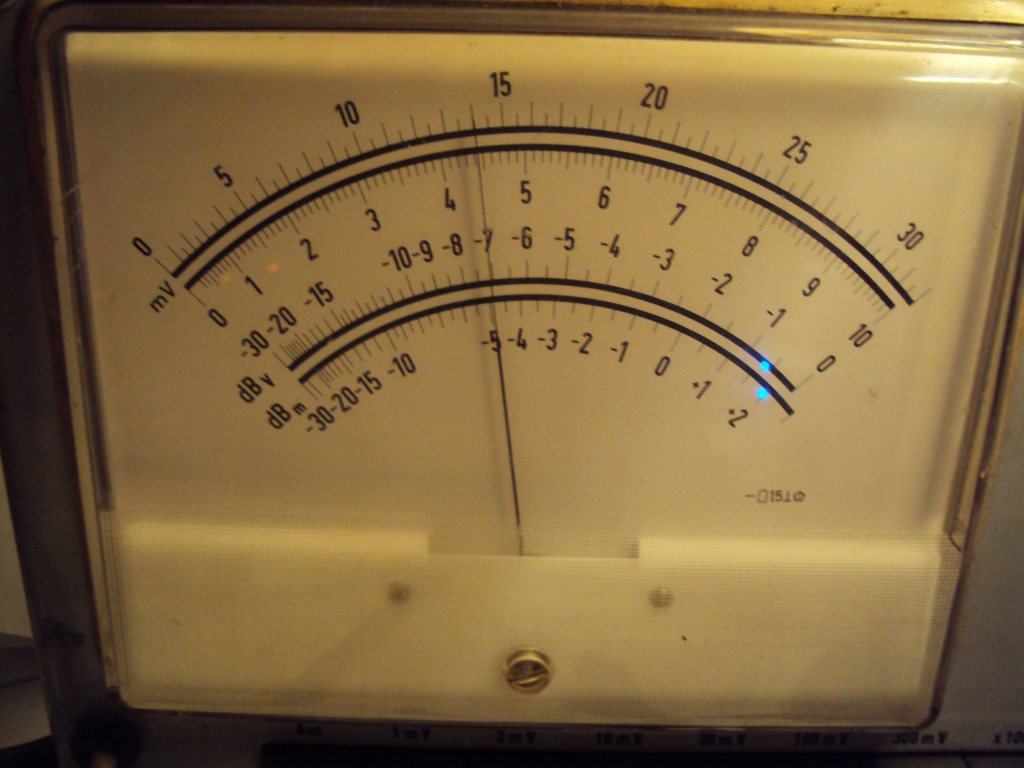

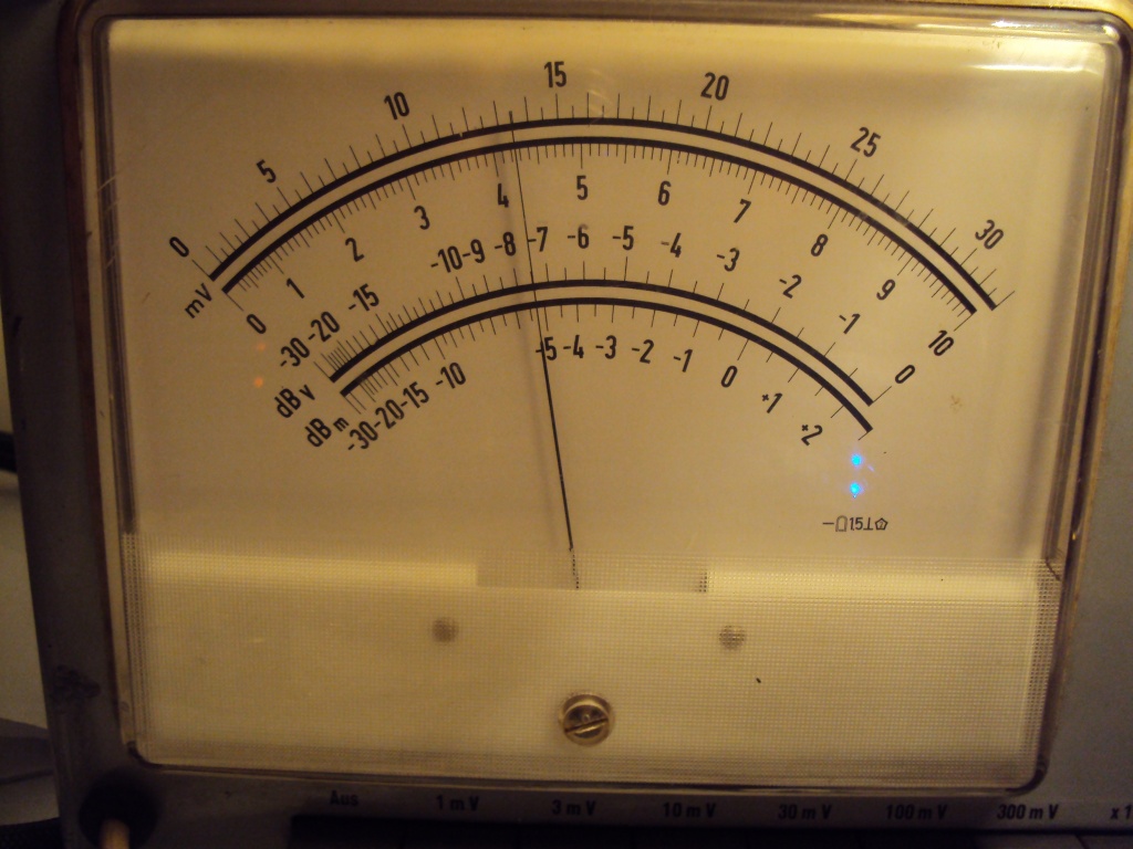

Here are Joachim's awesome vintage valve meter's readings for 1kHz and 200kHz left to right. Were just too big that is why they would not upload. I reduced them to 1024x748.

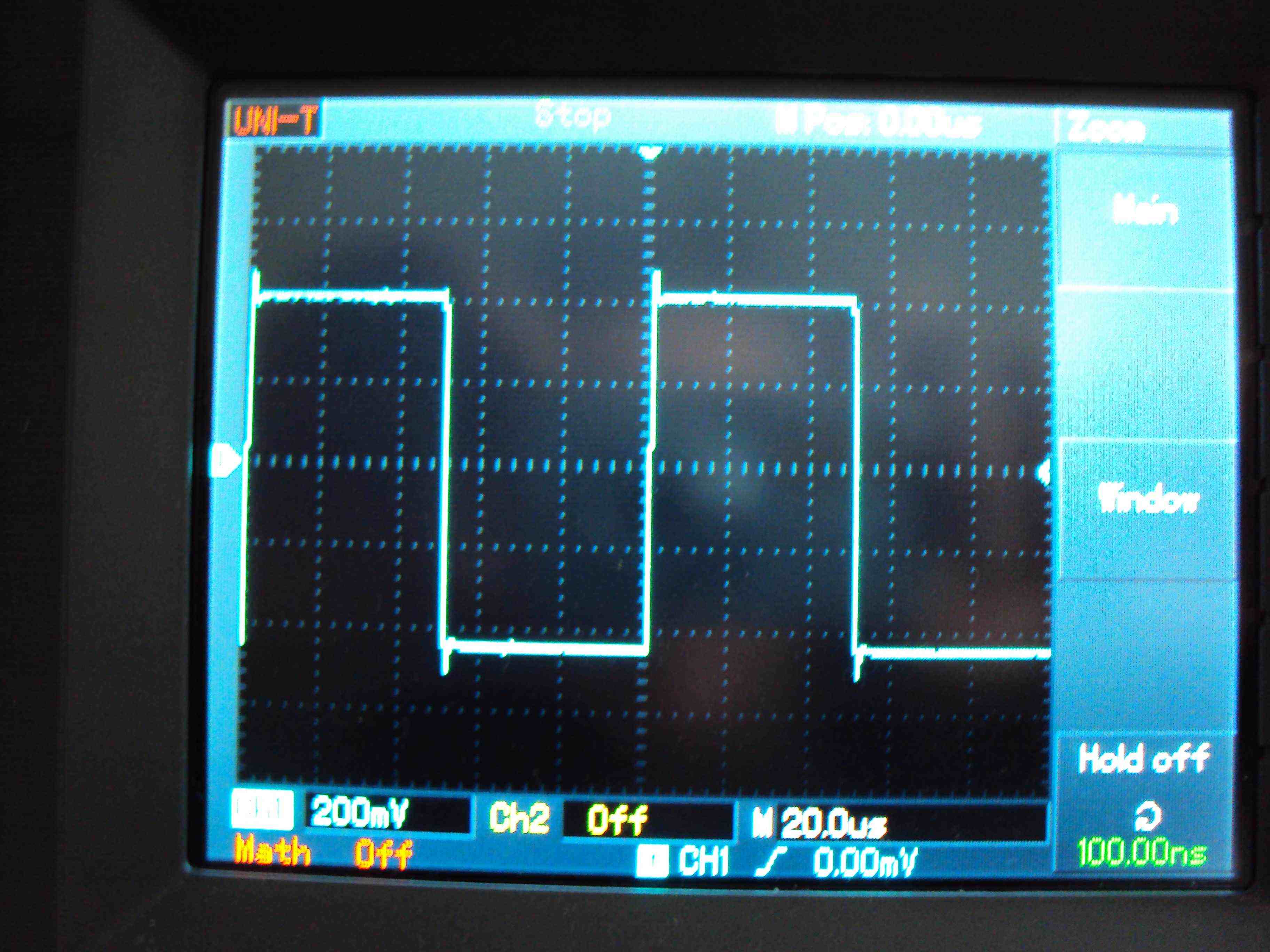

Today i measured the JG Self with the RIAA Encoder.
A positive surprise. Very quare quarwave and not much overshot this time so the 450kHz resonance in the inductive RIAA seems real. I will try to solve that but i do not think that is is audible.
Here the results for 1kHz and 10kHz into the JG Self.
I bridged the first cap in the subsonic filter to switch out the ICE amendment for this test.
If the Self RIAA is accurate ( i have no doupts) then my Encoder is accurate too.
A very encouraging result. It is posible to build some precisssion stuff at home without much cost if the dedication is there ( plus iron nerves) and the math is correct.
