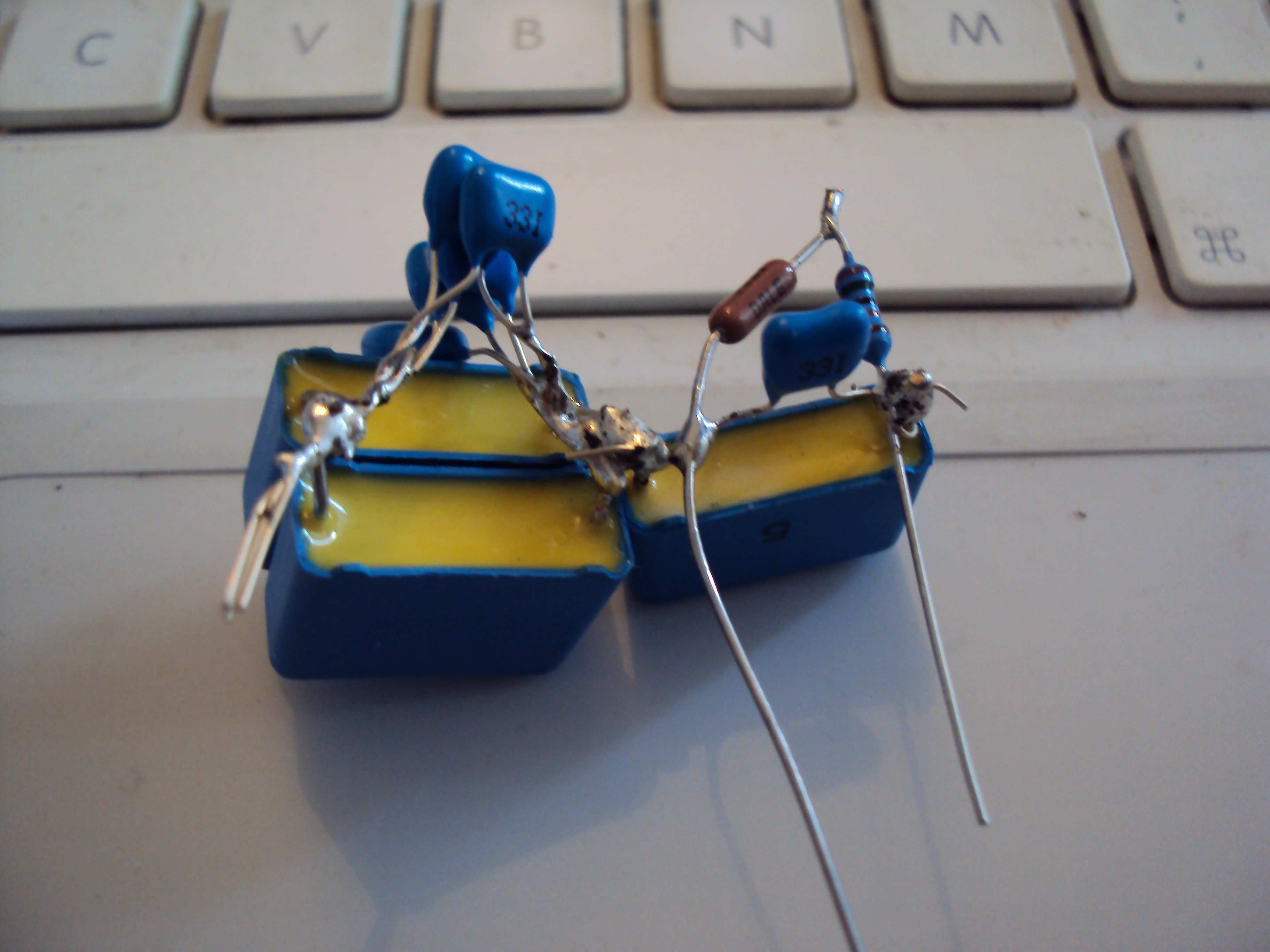

I have not posted for a while because i was very bussy building the RIAA Encoder and make it work reliably and precise. That was bigger of a task that this seemingly simple circuit sugests. Finding precise resistors and caps was not easy. I have no problem measuring them to better precission then 0.5% but i got a bit fanatic and had to drive into town many times to buy some and get some from a friend. It is now a wild combination of Wima FKP1, Silver Mica, Dale RS55 and normal 1% metalfilm that i selected out of my waiste bin.
Then i ran into trouble with the servo and then the second amplification stage did not work. The mistake was so ambarassing stupid that i spare you the details. I looked several hours into the box and could not find it. Let me say so much that building this out of double OPamps was not a good idea. After i got it working i found that measuring at that low level over such a wide bandwidth is a challange in itself.
Some hours ago i got it finally working and have first results.
I measured the High Z MPP with Inductive RIAA and in the audible band i found very similar results then what i had measured over the DAAS. The DAAS limits measurements to 20kHz and one of the advantages of this encoder is that i can measure over a much wider high frequency bandwidth.
One very telling test is a 1kHz or even 10kHz quarewave. In an ideal situation the combination of Encoder and RIAA gives a perfectly quare quarewave.
What i found with the Inductive RIAA is a 7dB overshot at over 400kHz. If that is the result of the Encoder or the Inductive RIAA itself i will find out tomorrow.
For other purposes i had build a little wideband linear measurement amp from an OPA627 that should be very flat to over 10Mhz. With that amp and my Sennheiser Tube
Voltmeter i will test the setup.
My next post shows some pictures i collected over the last hours.

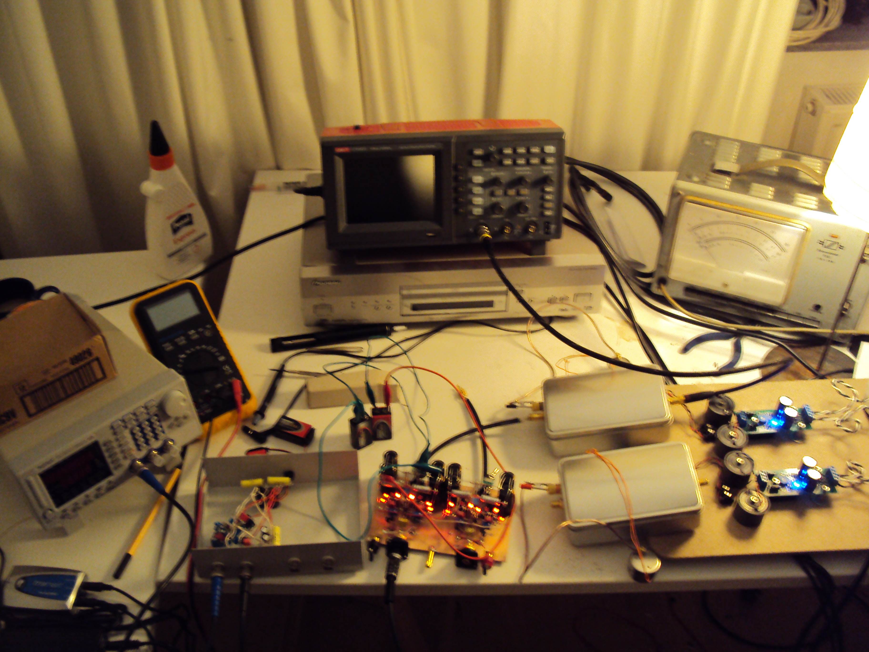

Here some pictures. First the measurement setup.
From left : DSD generator, RIAA Encoder in small metall box. 40MHz Digital Scope,
Sennheiser Tube True RMS Meter ( bandwidth 1MHz)

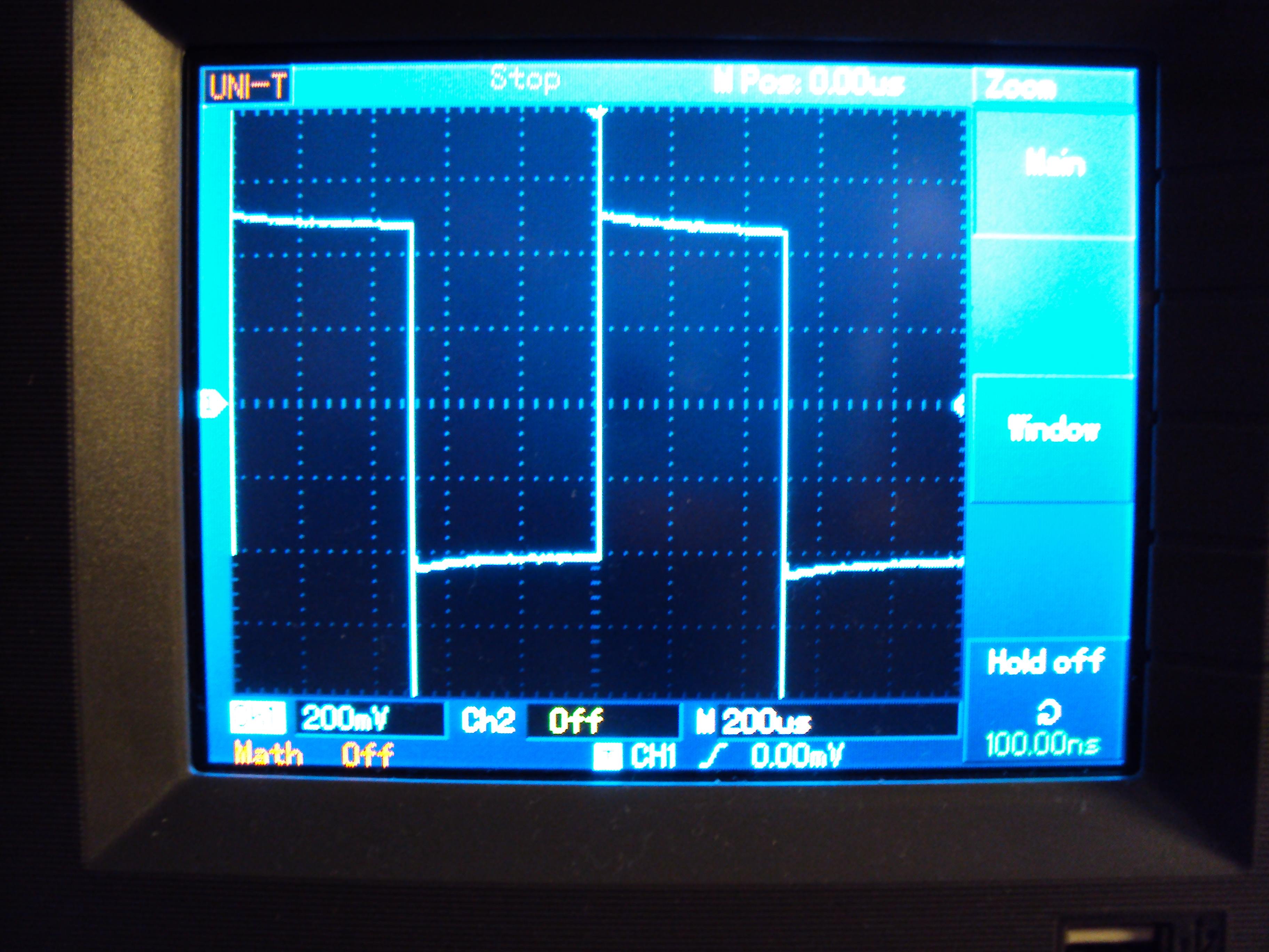

1kHz Quarewave over Encoder, High Z Mpp - Inductive RIAA

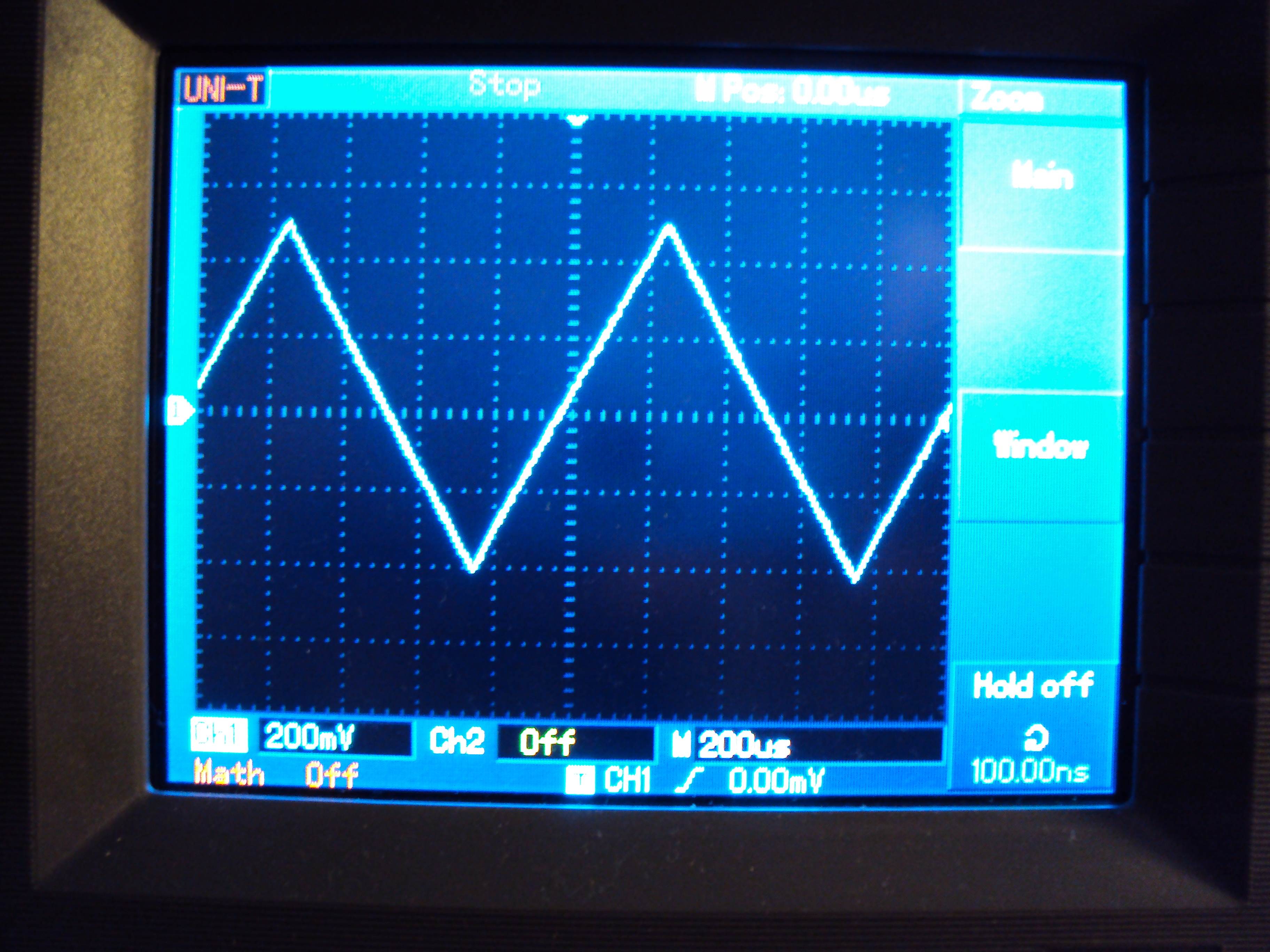

1kHz Triangle .... same...

I try one more time.
Left: Level at 200kHz
Right: Level at 1kHz
Well uploading does does not work. I try again tomorrow.
Thinking more about the ringing at 450kHz i think the reason is in the Encoder.
The opamp will reach its output swing at some point higher up and then a forth time constant is established.
I will look into that in more depth when i find the time.
Until 100kHz everything seems ok.
