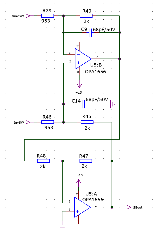

I just reviewed my autoranger documentation and the actual used circuit to convert bal to se is as attached. This is the circuit I discussed with RME. The earlier shown circuit is for the RMS measurement chain were requirements are more relaxed.
For inspiration, see Kirkwoods exposé at https://www.edn.com/audio-line-receiver-impedance-balancing-using-a-2nd-diff-amp/
His fig 4 is a neat way to impedance-balance the two balanced-to-single-ended converter inputs, and with that, equal load currents.

Does the schematic in post 11446 have equal input impedances/currents ?
Maybe this will tickle your fancy.
Works fine for known impedances of the source, if you know the source impedance then subtract this value from the input resistor value, and in the case at hand just ignore the output impedance (of the driving circuit) it is near enough to zero (compared to the 6.666... kOhm mixed resistor circuit it's impedance)

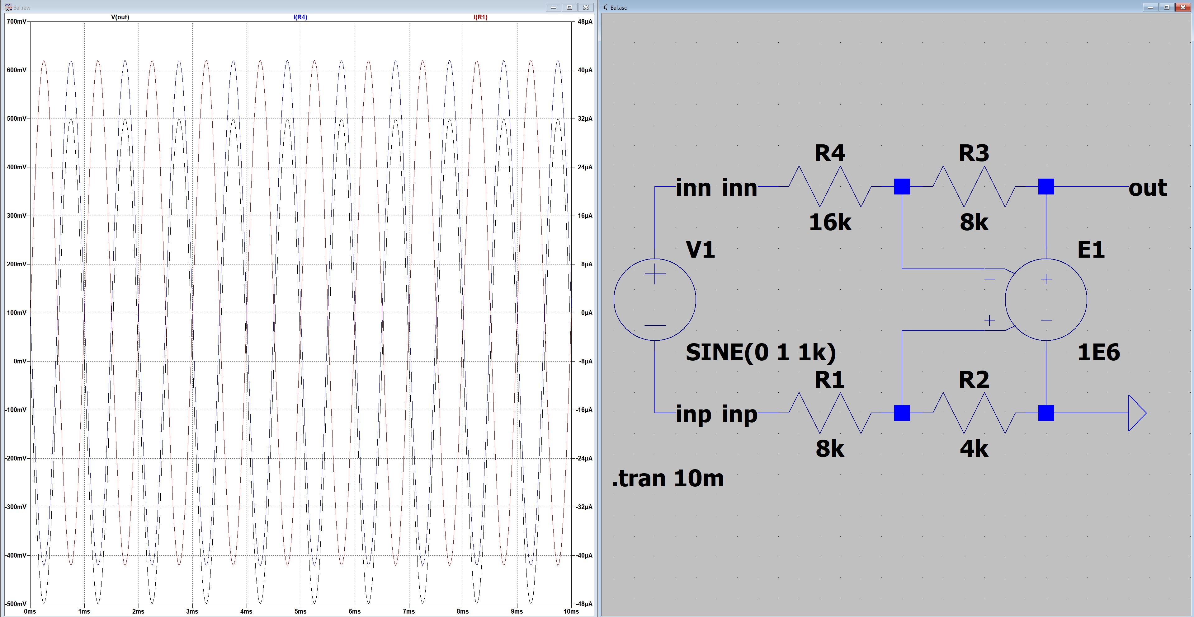

Jan,@ Hans: if the load currents are unequal, there is an unequal voltage drop on the output impedance of the two driving nodes. With the unequal resistor pairs, both the voltage drop over Zout as well as the load currents are equal, promoting CMRR.
Jan

Hans see my reply above your post. Also see the sim from Frans above. I think we are on the same sheet.

To add even more confusion :
In general, the resistors of the two "legs" need not to be equal.
But the quotient of resistor values of positive leg and negative
leg has to be the same in order to maximise CMRR.
Now what about the input impedances ? Formula please, no sim.

Exactly. No confusion, same applies, equal CM impedance.
