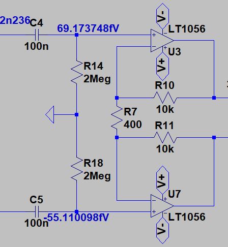

1) so better use well matched resistors. With 400/401 I only get 2.7V before the INA and after the INA 140pV.1) C15/C16 are DC blocking caps but also part of the riaa compensation.
If removed, the riaa filter must be modified to cope with the extra bass boost.
The circuit works without them as long as the 1st stage components are all extremely well matched.
If there is a small mismatch (for instance R2 = 401 instead of 400) the circuit still works but we have already 6V offset in the output.
If the mismatch is more serious (R2 = 405 instead of 400) the circuit does not amplify and we have 13V offset in the output.
Anyway this was a very good point as I also do not like the big 10u caps but something must be done to avoid collapsing so I added two small 100n caps after the RIAA filter, recalculated the input resistors on the RIAA and the circuit works flawlessly now.
2) You can remove this connection to GND and will not see any difference in the circuit operation. I did follow the instructions found here Still More Phono Preamps
"On the other hand, adding just one more capacitor and referencing the 2122Hz pole to ground will preserve a much more accurate final equalization, in spite of slight imbalances. (This is something will not show in a SPICE simulation, unless you go looking for it, as SPICE parts come perfectly matched.)"
3)I did see better current matching in the output buffer with this resistor combination suggested by Frans......
Below the new
2) this connection will inject ground noise into the signal.
3) current matching is no issue, it does not bring any benefit.
Hans

I am using LT1056 just for simulations. Chosen because it is a jfet input opamp like the 411....
Would you care to share the OPA1652 model ?
Yes, the circuit works with 401 / 400 but not with 405/400.... must be matched.
But I believe it will be very difficult to match the jfets and that might cause aditional difficulties. The new C4 C5 100n are small, can be used to form a low pass anti rumble filter and avoids any issues with IPS mismatching.

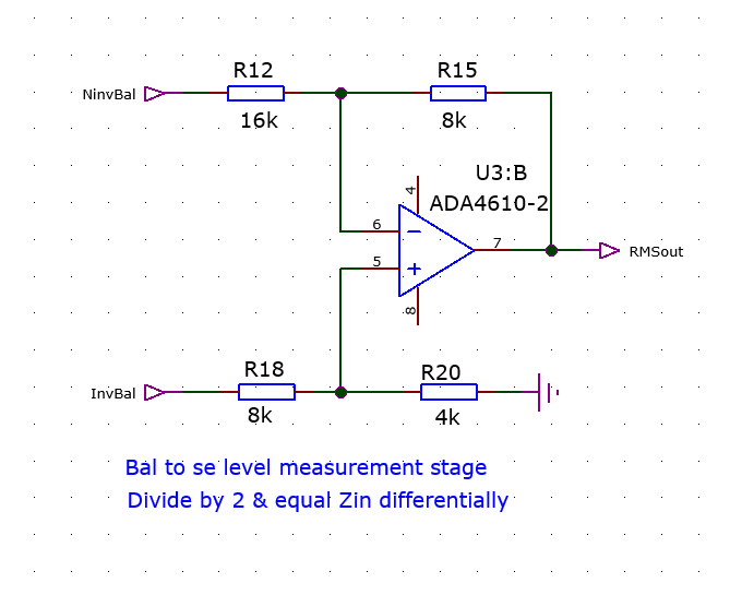

Where can we read about this ? Please at least one published
example of an instrumentation amp with different "legs".
See attached, from the autoranger. A trick I learned from Matthias Carstens of RME fame!
This way you draw equal currents from the diff stage which helps CMRR.
Jan
I just noted that he should check the input currents at both legs (using the simulator it's very easy).
Yes you really must check it. Its counter-intuitive.
Jan
Jan
Jan,
Can you think of any reason why equal currents would lead to better CMRR, and why all INA manufacturers promising very high CMRR are using equal resistors ?
Hans
... Anyway this was a very good point as I also do not like the big 10u caps but something must be done to avoid collapsing so I added two small 100n caps after the RIAA filter, recalculated the input resistors on the RIAA and the circuit works flawlessly now.
You loose input bias for U3, U7 this way (schematic of post 11440).
Please explain.... do I need to reference U3 and U7 inputs to gnd ?

My model of OPA1652 does not work as expected.
To make the circuit work I must reduce the drain resistors from 400 to 100 and there is too much current flowing out of the opamps.
Jan,
Hans
As stated before, equal differential currents but unequal CM currents.
In a balanced line receiver application, you do not know the impedance's that are driving the receiver. Anything more than zero will result in Jan's circuit
having worse CMRR than an 'equal R' bal line receiver. This is due to mismatched CM impedances between phases causing CM to differential
conversion. Balanced studio wiring theory, ref whitepapers by Bill Whitlock
etc.
Once you start talking about distortions of both topologies things get a bit more complex. In Jan's circuit the summing opamp will likely have worse
CM distortion but this will depend how susceptible the opamp is to CM distortion. See Samuel Groners paper.

Jan,
Hans
As above, equal impedances will improve things, (and even earlier [more above ? 🙂]) these are impedance circuits, not voltage or even current ...

@ as_audio: you can simply run a sim and see that with identical resistors, the currents are unequal.
@ Hans: if the load currents are unequal, there is an unequal voltage drop on the output impedance of the two driving nodes. With the unequal resistor pairs, both the voltage drop over Zout as well as the load currents are equal, promoting CMRR.
