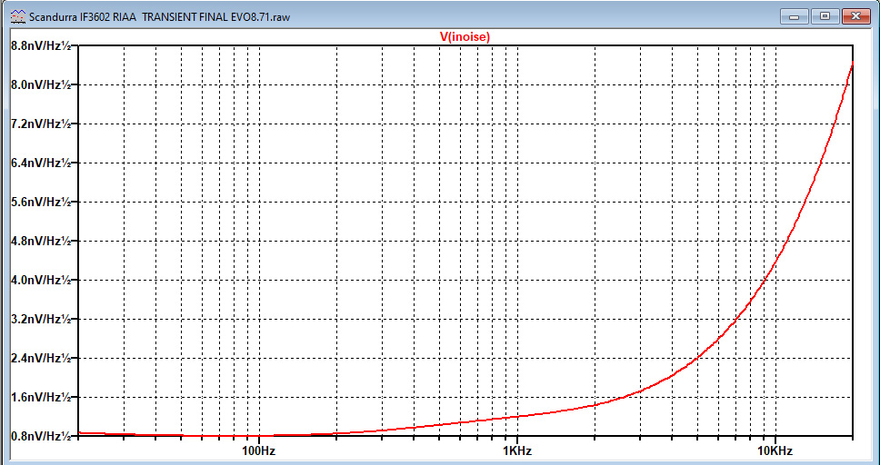

I had a look at the circuit in #11410, and have a number of comments:
1) C15/C16 have no function, they can be omitted saving quite some PCB space.
2) The junction between C2/C3 and C13/C1 are connected to Gnd, this has no function.
3) Output amp U8 has 3k3 and 10K resistors, more logical would be all four 3k3 or all 10k.
When measuring the equivalent input noise with a 0R source resistance, I get 0.71nV/rtHz A-Weighted which is good but not excellent for this very expensive dual Fet.
With a 10R source EIN becomes 0.73nV/rtHz A-weighted.
See calculated input noise below with 10R source.
Hans

There is no compensation C in opamps local feedback path typical for this
type of circuit. Omitting this with IF3602 is asking for trouble.
WRT noise -> 3 x 2sk369 or equiv / phase will get very similar results.
Has anyone done a distortion sim at say 60dB gain?
Not so, see my answer/remark/comment (before/earlier) to RCruze.
Frans, I can't find your answer to RCruz. But from my own measurements, it makes sense to make the two pairs different rather than equal value.
The input impedance of the two legs is quite different, and if you want to load the diff amp equally on both outputs (a requirement for balanced lines!), you need to have the two pairs different.
IIRC the ratio should be 1:4 (or was it 1:3? Can't remember).
