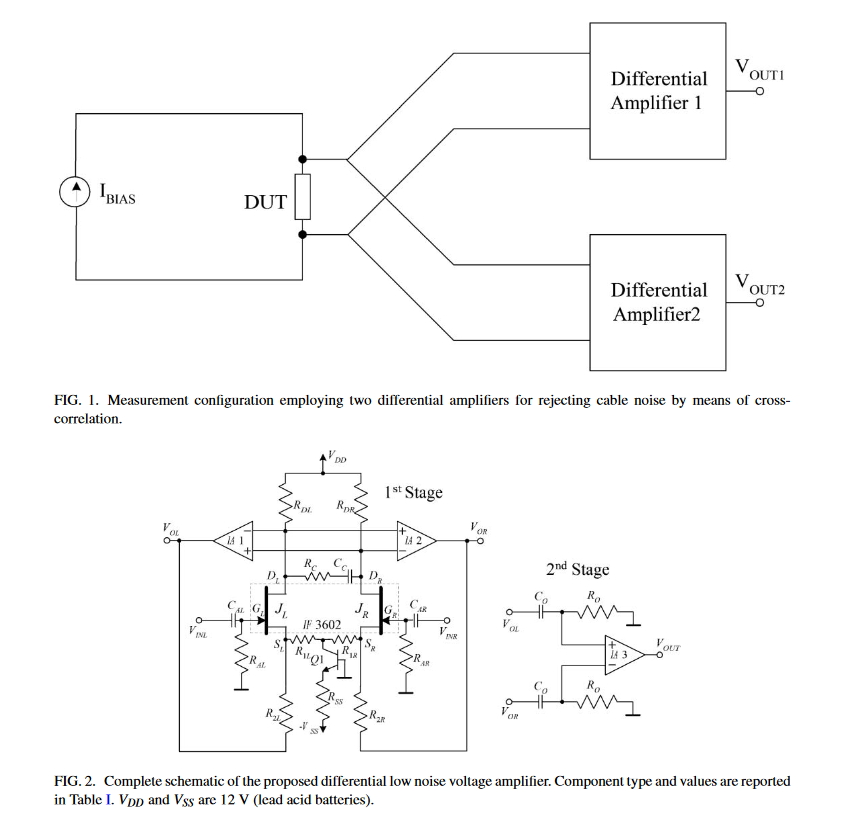

"Differential ultra low noise amplifier for low frequency noise measurements" Full citation pdf: https://aip.scitation.org/doi/pdf/10.1063/1.3605716
Looks to be about 1nV√Hz.
this here is a bit what we do but with FETs.

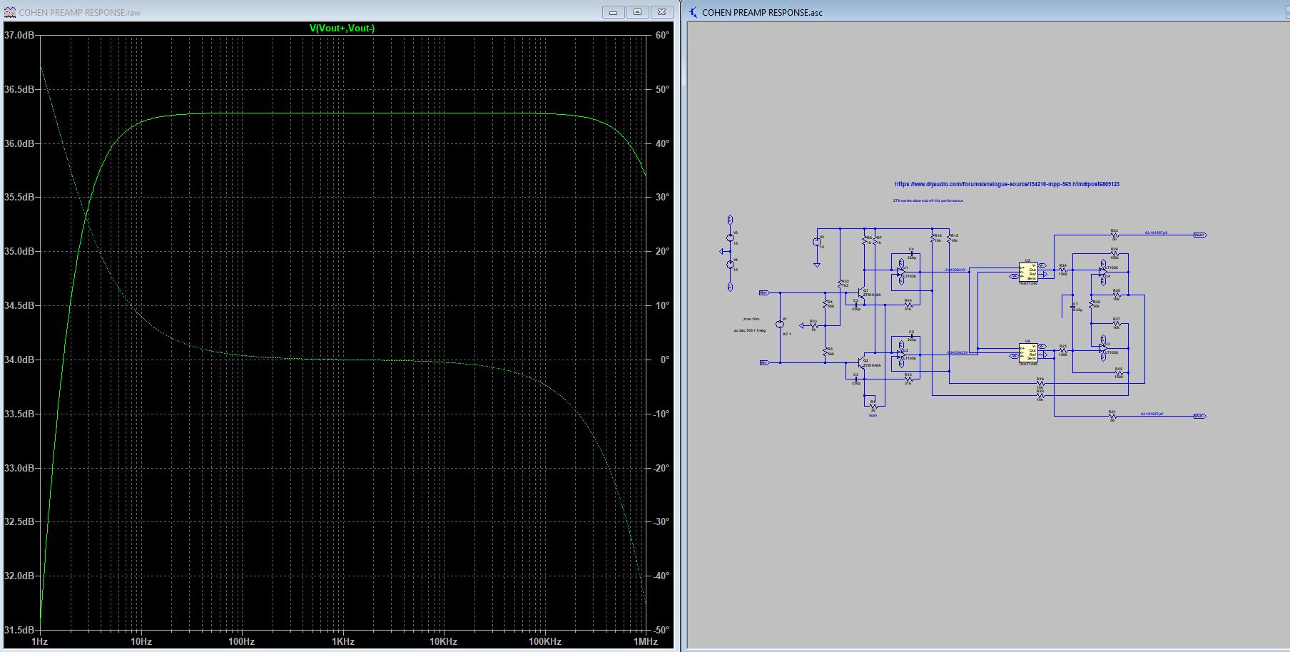

Compare to post 11330 (feedback not applied).

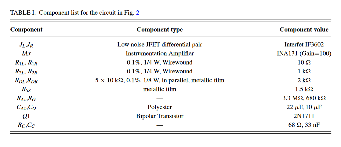

I think the Noise Limit here are the 10 Ohm source resistors and the idle current. I would make them as los as 2.2 Ohm and set the Kyle for the pair at 50mA or something. Other then that the circuit Workshop well.
In my design, idle is 5mA per input device.
To lower noise we can parallel some jfets.
The IF3602 is way to expensive for me...

Let me know if you like it and I will further develop the sim.

Yes, I like the FET Version and I have some IF3602. If you further develop the circuit for this FET ( lower value Source resistors, 50mA idle per pair ) i am able to build a prototype.
