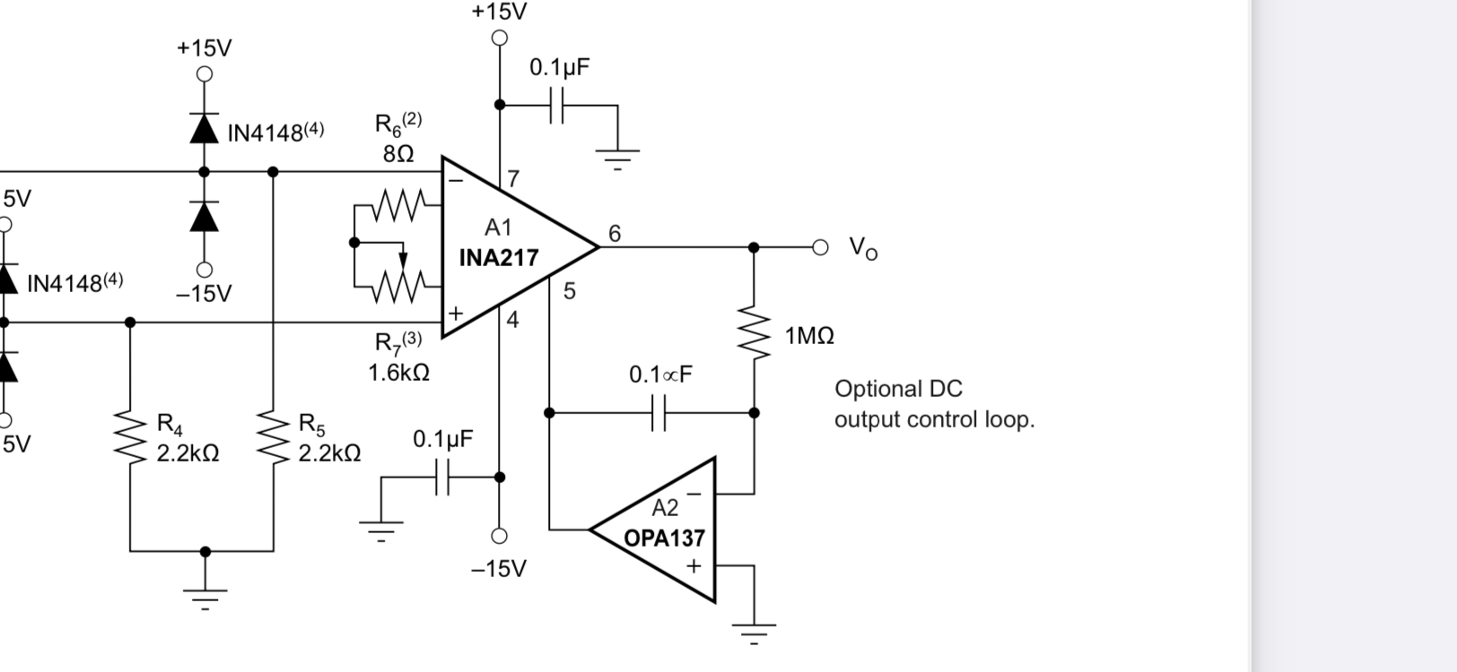

Like this

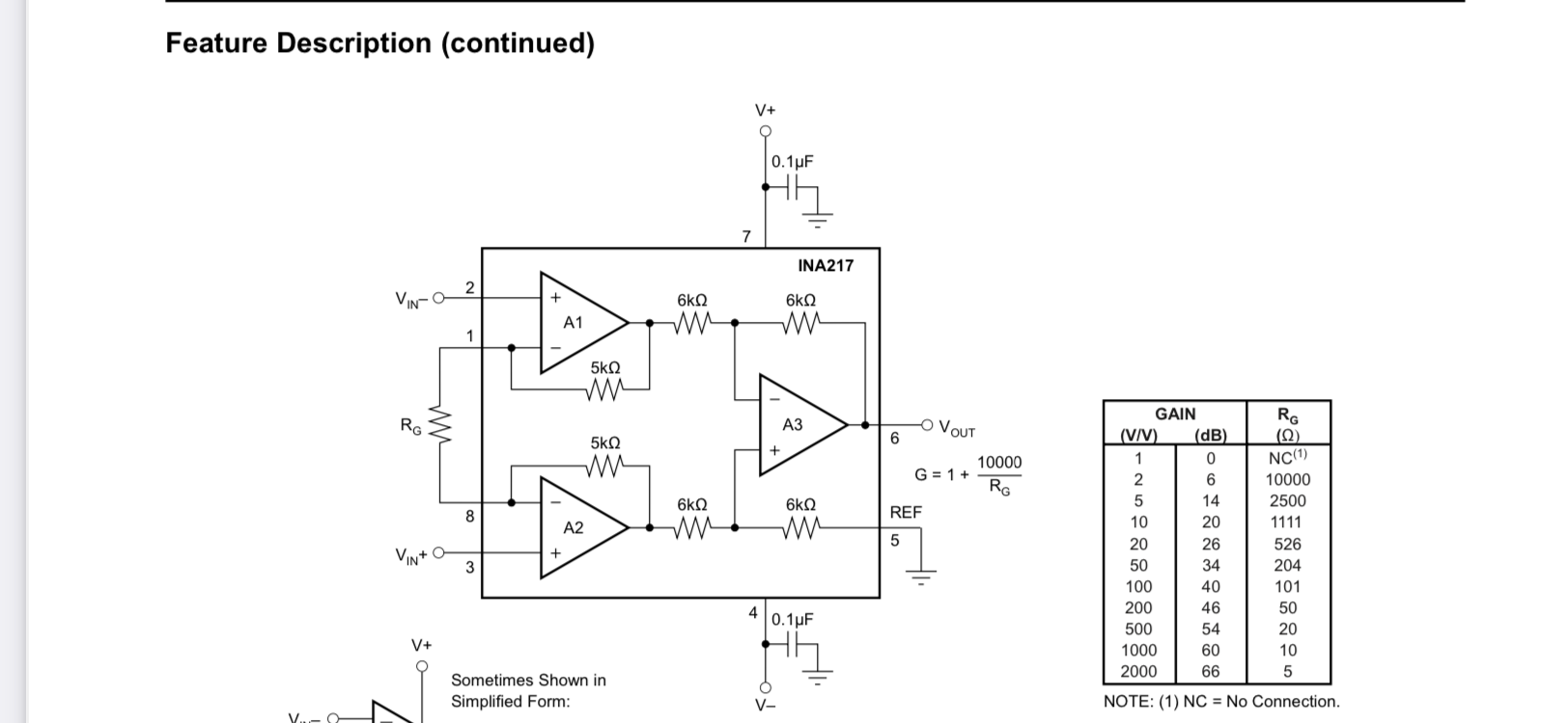

The simplest balanced low noise, discrete/opa hybrid is the Graham Cohen double balanced mic pre arrangement. The first opamps FB resistors bias the
IP devices. I've forgotten how many Pro Mic Pre's with variations of this circuit have been on the bench.
Original paper:
https://www.google.com/url?sa=t&rct...mp.notes.pdf&usg=AOvVaw1bhwCvEHq_2-53jKaJScgN
Fred Forssell's schem using jfets
https://www.google.com/url?sa=t&rct.../JFETMP1.PDF&usg=AOvVaw1_d0jlwSS0v7G43etytfsy
FWIW, there is a 1nV THATcorp bal in / bal out mic pre IC which has very very good specs you could use for the first stage but there will be a minimum gain for stability.
THAT Corporation 1580 Low-Noise Differential Audio Preamplifier IC
