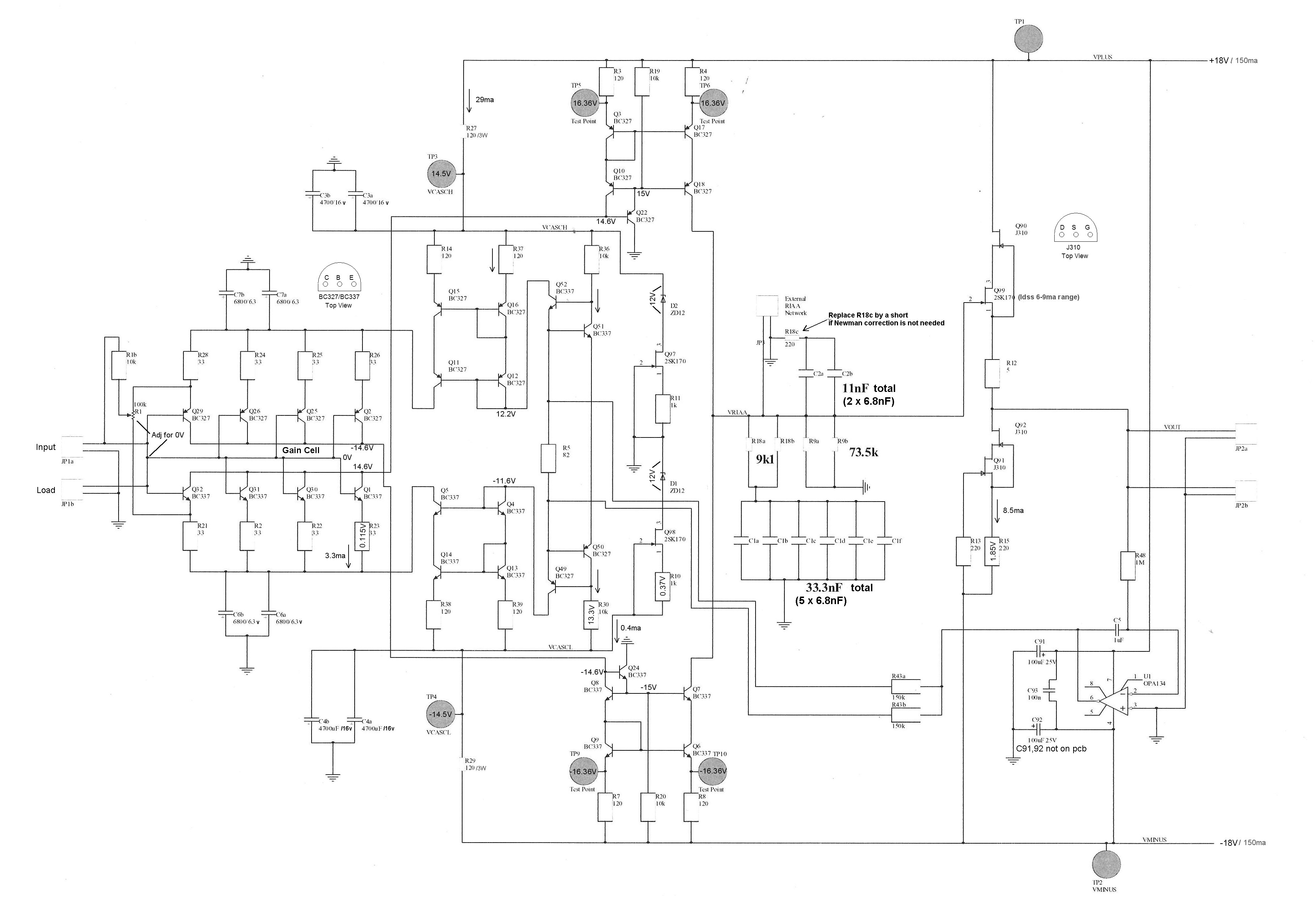

Hello Joachim
Still trying to understand the paradise schematic and need your input.
There are two voltage references that provide VCASCH and VCASCL.
The are made with a ccs and a zener in each case.
R11 Q97 D2 and R10 Q98 D1
What is the purpose of such a circuit ? In my simulations the circuit works perfectly without these subcircuits......

I guess D1 and D2 are just used to drop voltage so that the JFETs don't suffer from high Vds and heat losses.
