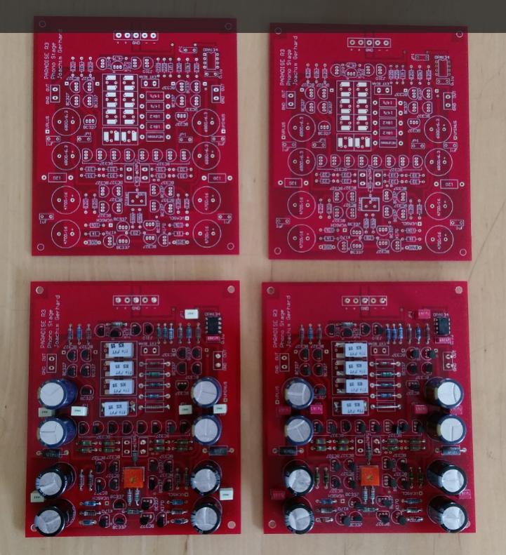

Yes, the input is balanced and then converted into ubal. Maybe we do the output balanced too- Lets see.
You have my full attention, and admiration for your dedication..
Hi Joachim Frans
That sounds very good lads, go ahead with the project you have my
full attention.
I would like full balanced as well.
Take care, Werner
Yes, we will do a balanced-in to unbalanced-out and to balanced-out.
Good news!!!
Compaired to Paradise - is it easy to implement sort of two gain alternatives with a switch (without big sound penalty) with maybe 6dB difference? This is something i would like.
Because in my case i have one balanced input, which bypasses the input transformer (phase splitter, in 2:1 mode) so i would not need more than maybe 57dB gain for ~0.25 - 0.5mV carts.
