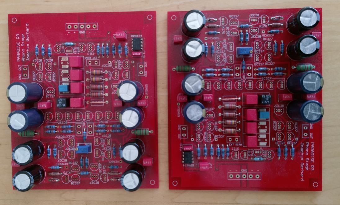

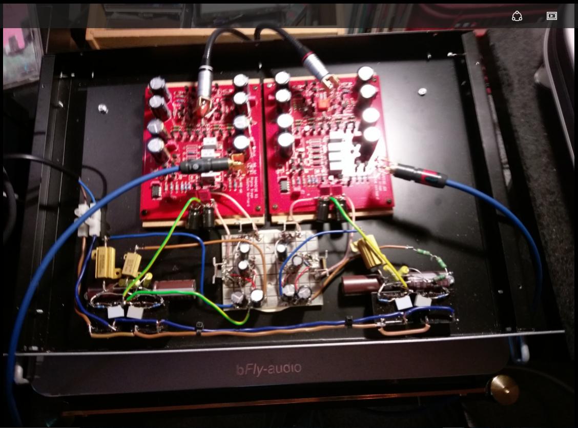

I have some stuffed Paradise boards without PSU. AS Audio build and calibrated them.

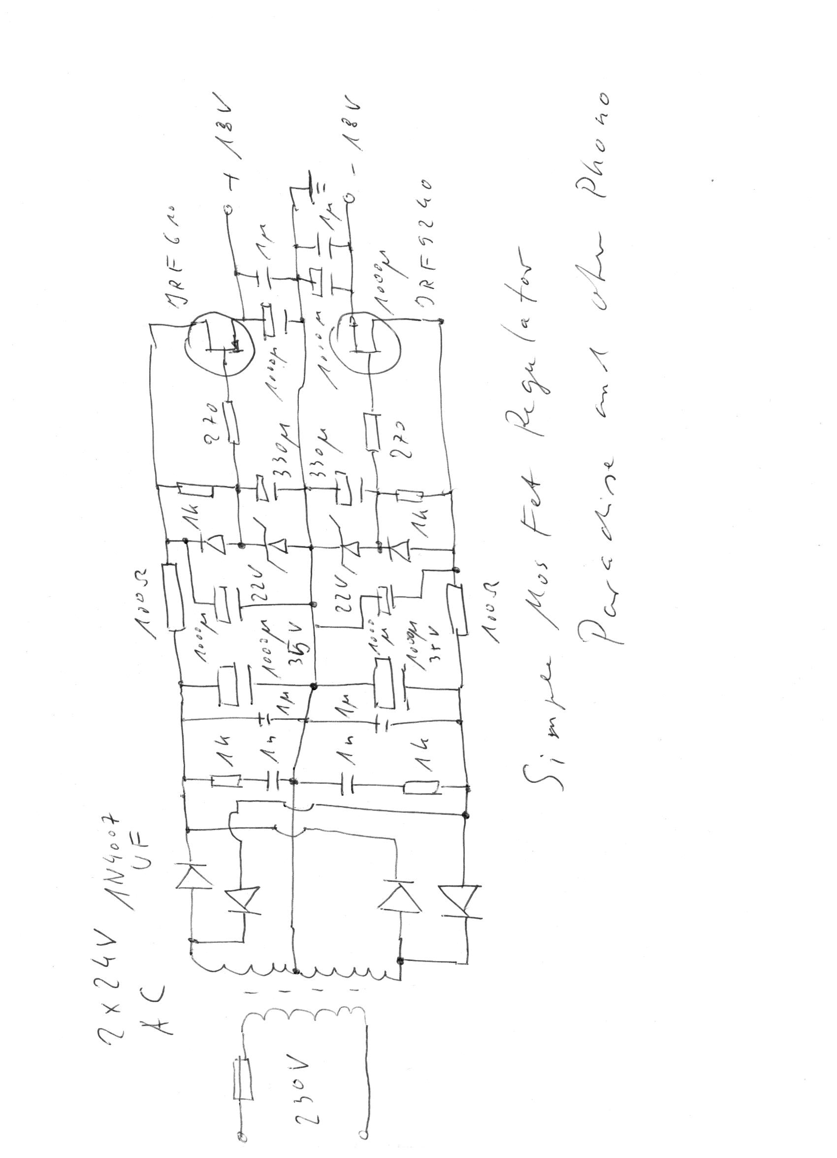

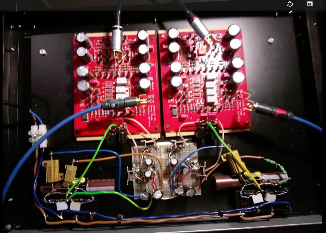

I build a very simple PSU, double mono, MosFet Z-diode multiplier and RC filtering.
This stage is super quiet and sounds just fine. I may publish pictures and circuit diagram.

Hi Joachim,
Please do.

Thank you for the schematic for the alternative power supply. It actually is great as I have been thinking about building a Paradise RIAA as a present for a friend of mine. Could make the build a little easier.

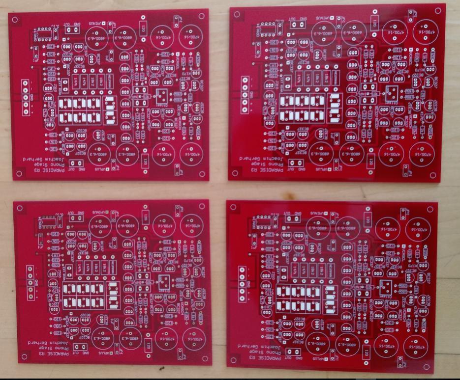

Many people are asking me if i still have Paradise parts. Going though my vaults i found more then i thought.
Here come some pictures and i explain later.

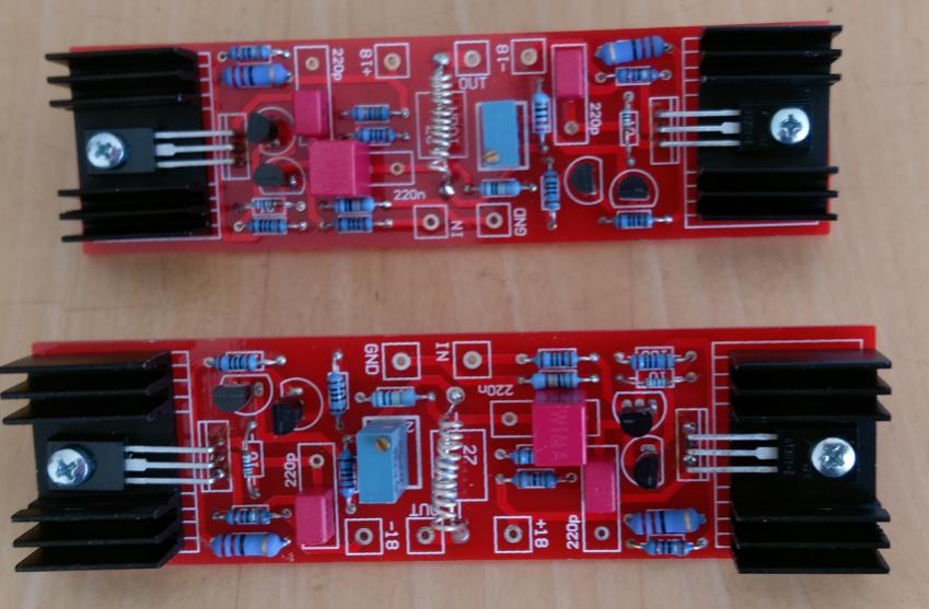

A pair of Calvin buffers, ready to play. 4 Unstuffed Paradise boards R31b. 4 Paradise R3 without shunt.

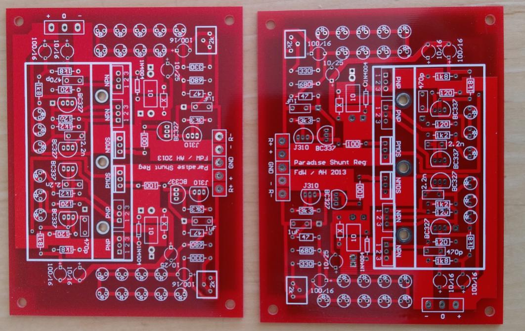

Pre regulator stuffed, transformers and resistors missing. Stuffed Paradise R3 stuffed, semiconductors missing. FdW shunt regs, unstuffed boards.
Jaochim, can I take a blank set of Paradise main boards and the Calvin's off you, I'm not bothered which rev the main boards are.
