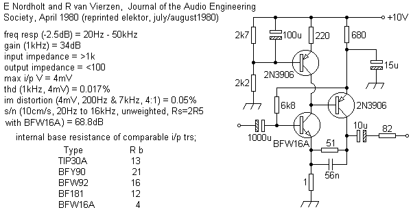

This a " good enough " circuit to test it. A single 2SC6000 is only 0.5dB worse then a differential triple.

I called RS Europe, no 2SC6000(yet).
Long time ago i build the " good enough " circuit when i worked with Mr. Nordholt. Later he developed a special chip with a very big transistor with low Rb for Ortofon. The project was cancelled later. Found some BFW16A's in my drawer....

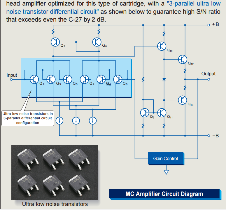

This is all i have :
http://pia-hifi.de/wp-content/uploads/c-37_g.pdf
They even do a differential input that has a 6dB noise disadvantage over parallel symmetric.
This new input transistors must be very good because this phono stage is even 1dB more quiet then the last one and that was very quiet.

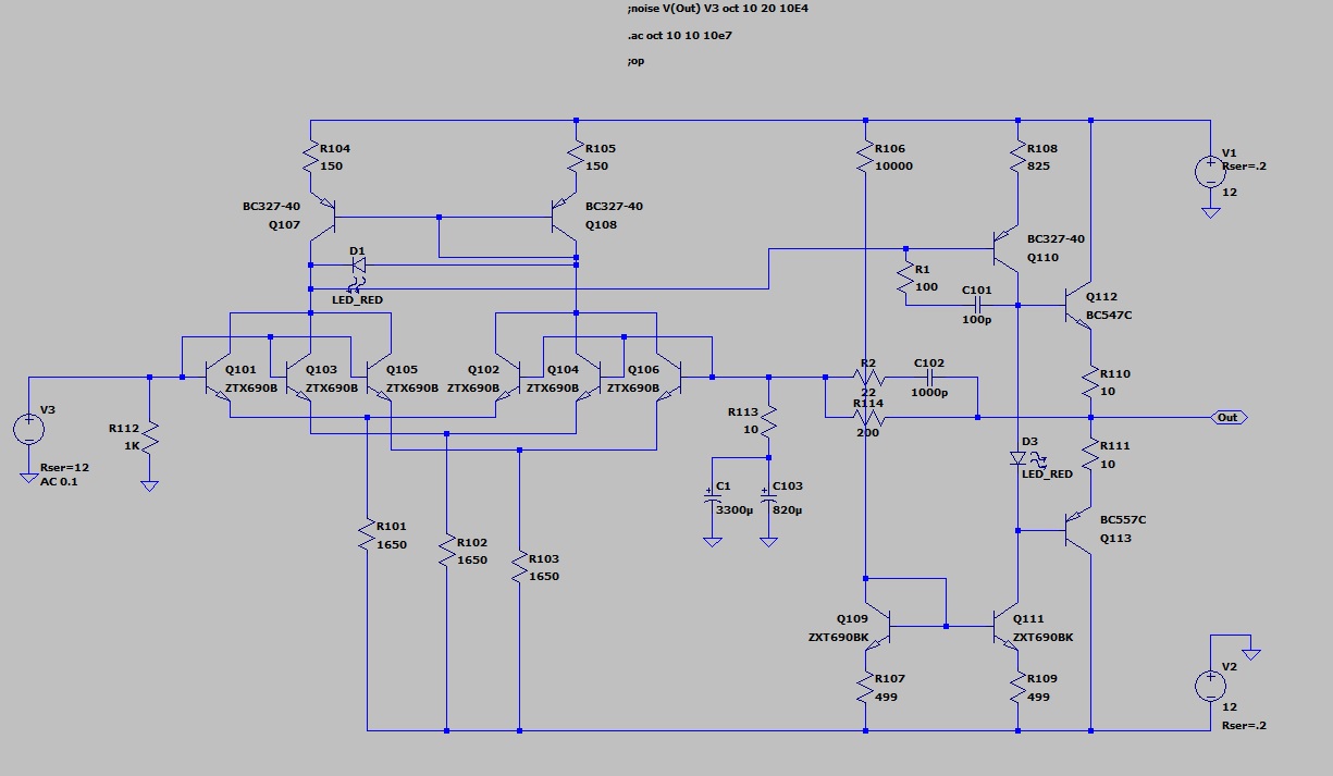

A little while ago I created an LTSpice mockup of the Accuphase C-37 MC stage based on the schematics in their brochure, but with different transistors as I didn't have suitable models. Their input stage looks deceptively simple so I thought I might give it a try. There is certainly room for improvement but unfortunately I have little to no time for audio right now to pursue this any further:
