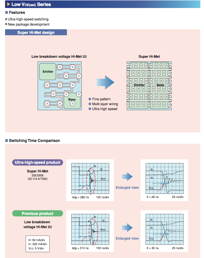

Accuphase has a new super low noise phonostage, the C-37.
That comes as a surprise because the stage they made before is only on the market for ca. 2 years. It uses NPN BJT transistors at the MC input.
It is the 2SC6000. I could not find a complement so far.
http://www.toshiba.com/taec/components2/Datasheet_Sync/201211/DST_2SC6000-TDE_EN_10758.pdf
many medium power bjt´s have very low voltage noise.
this one has also high and linear hfe and a very high early voltage at a current that works for lowest noise
both, hfe unlinearity and early effect, are sources of distortion.
this one ios not a perfect compliment but it could work :
http://www.toshiba.com/taec/components2/Datasheet_Sync/200612/DST_2SA2097-TDE_EN_7703.pdf
