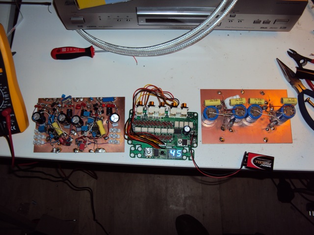

i supply the MPP with them. I now changed for bigger ones of better quality.
If i do not use batteries, i use the LC Audio Low noise supply that i modified with 27mH coils. My circuits have superb PSU rejection so lets see what the shunts can do.

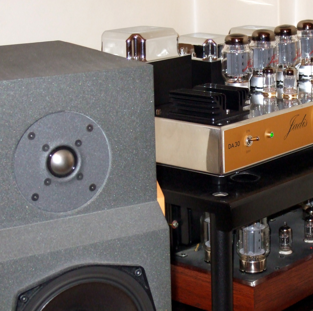

I use the same alignment for tweeter filter in my home speaker. That is why you use a slant on your monitor? You use it 90deg shift for low pass too. Tilts down lobe if straight cab profile. I use it with a deeper step back than aligned Z axis for TW and stays upright. Thats an Audax with neo spider mag cap initially planned for Revel. I use a 4Ohm VC because it is a 95dB 1m spkr. Underneath is a PHL mid.
