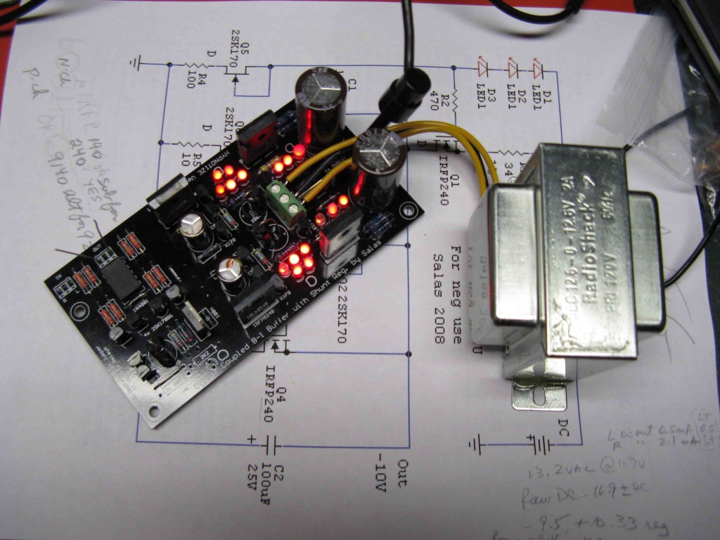

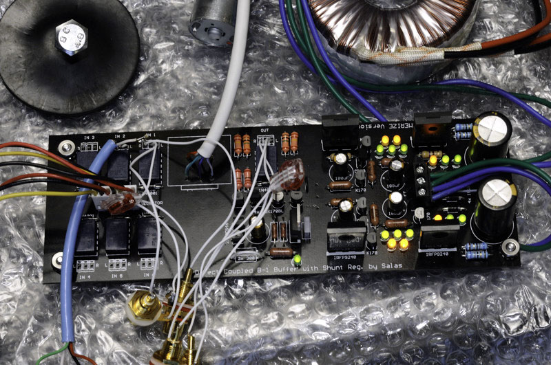

We have used the Nais TQ5-TQ12 and Omron equivalents on the DCB1's signal inputs/outputs with no apparent resolution penalty.
In the first picture there is a Hypnotize build with one output relay. The second one comes from a Mezmerize build measurement with Nais TQ both on input and output. If they can pass a smidgen of 3rd Harmonic to be displayed on the -130dB grass, I guess their contacts are OK?

Well, the 'smidgen of 3rd' is of course part of the total signal which maybe on the order of 100's of mV or even a volt?
Even AP uses these types of relays in their analyzers, so yes they perform well.
But as I said, I'm not sure what the significance is of that spec. It is there, it is tested so it should mean something.

Forgot to tell that If there is digital zero for input, hence no signal output, the noise floor does not change shape or -dB level, remains like when passing the 1kHz at hundreds of mV to 1 or 2V if that can show something, towards your query.

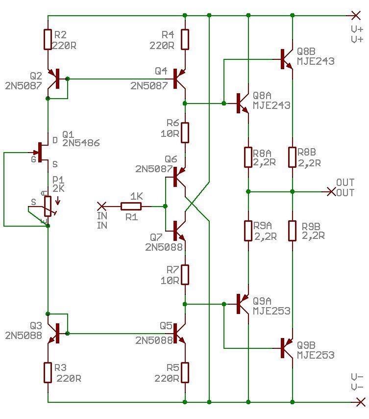

My main phone is the AKG701. It has quite a low impedance so I will use a diamond buffer
with ca.30mA class A as output stage. It can swing 50mW class A into the 60 Ohm AKG.
The buffer is a more or less clasical design with improvements to the current source that are similar to the High Z MPP i posted lately. A Fet constant current source feeds a green Led. The output is lowpass filtered by a cap and resistor to the bias transitor.
That arangement is very stable and after trimming offset with P1 it stays under 0.1mV.
As input buffer i use the PSG buffer with offset trim and i am still working on the voltage amplifying stage. I am trying to build a kind of I/U converter with current mirrors so the whole amp is global feedback free.

BTW this is a similar amp but only with a different front (read: no led's) and output 2x.

I have seen that topology. I found it when i googled "Diamond Buffer". It should work as well. The cap-resistor lowpass i am using should work with that too. You loose a little bias voltage but i use BC550C/BC560C here that have current gain over 600 in my samples. I really think this little project is too small for it´s own thread and i already opened another worm of cans : "MPL", My Privat Speaker.
