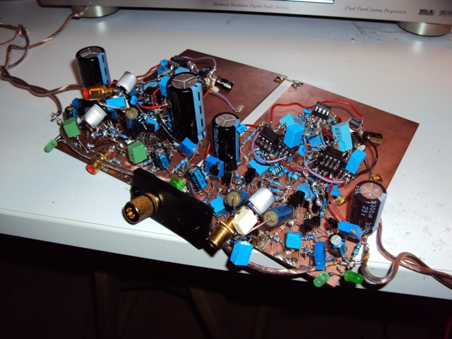

I put more thought into the BJT INA.
The current sourced caskode did not work so well with BJT´s so i simplified a bit.
They are now fed by a capacitance multiplier and the feedback goes directly from the collectors.
Circuits like that proved to work in designs by Douglas Self and Burkhard Vogel but they used them unbalanced.
Idle current in my design is adjutable for minimum DC offset and optimisation for an MC with higher impedance like the Denons and Clearaudios.
When i use 4 x 4 input transistors and reduce the feedback resistor to 1 Ohm i could get 0.3nV/qHz in a balanced design.

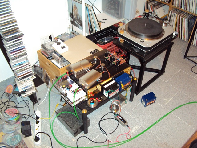

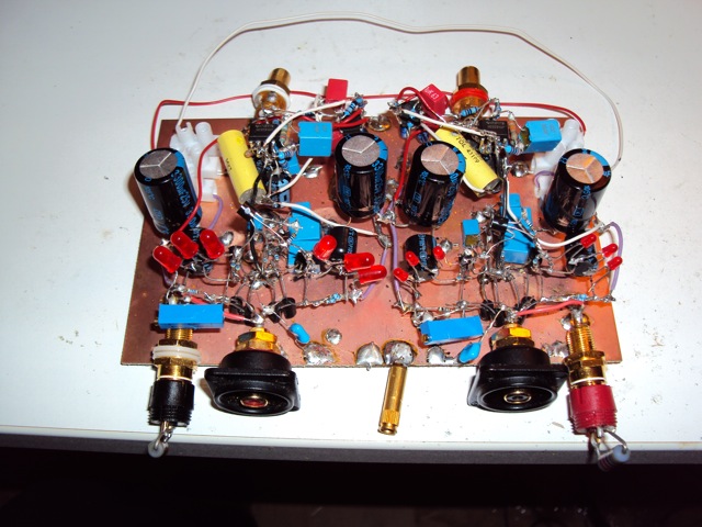

i promissed some photos.
I have build a lot of stuff where i only posted the schematic.
I changed now from building in the small metall boxes to groudplane construction.

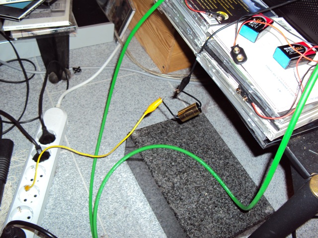

I use a double sided board so in a double mono construction i have 4 groundplanes and i use a metal box under that for a 5th groundplane. I place connections of the groundplanes at strategic positions. I also earth the planes at one point with a 6.8uF cap to wall outlet earth.
I have a cable with two wires from the tonearm and one shield that is connected together at the tonearm side. That way i can try balanced and unbalanced.

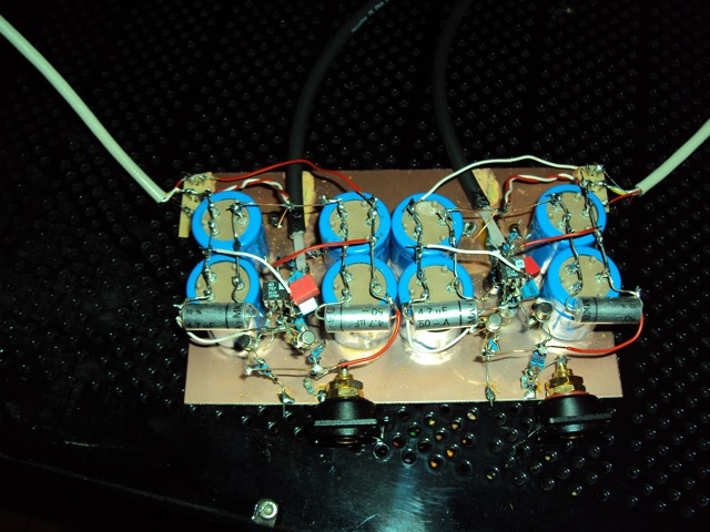

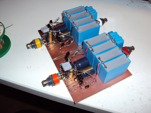

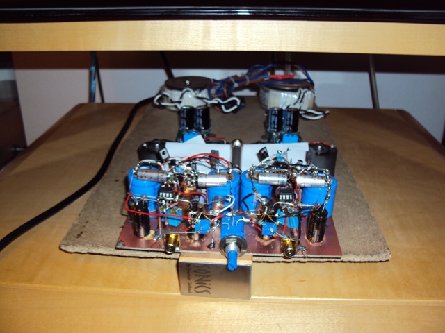

i started to build the Shunts. The cabinets arived and i bought BHC Slit Foil caps instead of Sikorel. I worked a lot with Dennis Morcroft of DNM. the invertor and always wanted to try them. Mosfet are also on the way and i build most of the small parts.
BHC Slit Foil 10000uF 50V I have used in many phono builds, they are excellent value. Good move. Very big box I see. You are going full force.
Great Work Joachim
Man I thought that I was the only one that made prototypes like this.
We are very much alike.
Nice pic's and like Salas said I like P2P and you can make changes to it fast and listen within minutes.
Where are your 12 volt batteries?
Hey I see something I like very much, in the middle of the picture "Sonics" 😛
Thanks for posting your pic's Joachim.

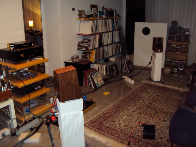

Speaker Setup, little Monitors that i filter with 33nF into 47kOhm plus active mono Subwoofer (the black cube).
Goes surprisingly loud. I sit very close and have the speakers crossed before my ears.
The are difuse field equalised for this, so have slightly rising treble over 10kHz ( only 1dB).
