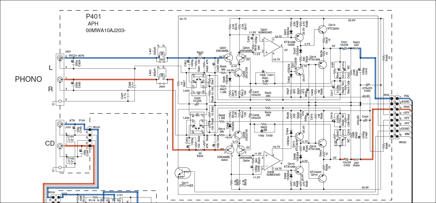

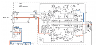

Here is is something else from Marantz.
Trick gain stage..................
Jam

And where is the tricky part. The output stage is driven from the supply current of the opamp? that's it? IMHO this is really bad, please don't (do this at home), take this as a bad example!! Even Marantz seems to make mistakes.
I did not say it was good but but I have never seen this topology implemented in a line level product let a lone a phono stage .........I wonder what it measures like?:scratch2:
It is a 'relatively' normal circuit and old also, but not tricky at all.
The thing is, here we talk about Joachim's circuits (and related (even remotely)) not Marantz. So where is the reference to any of Joachim's circuits?
