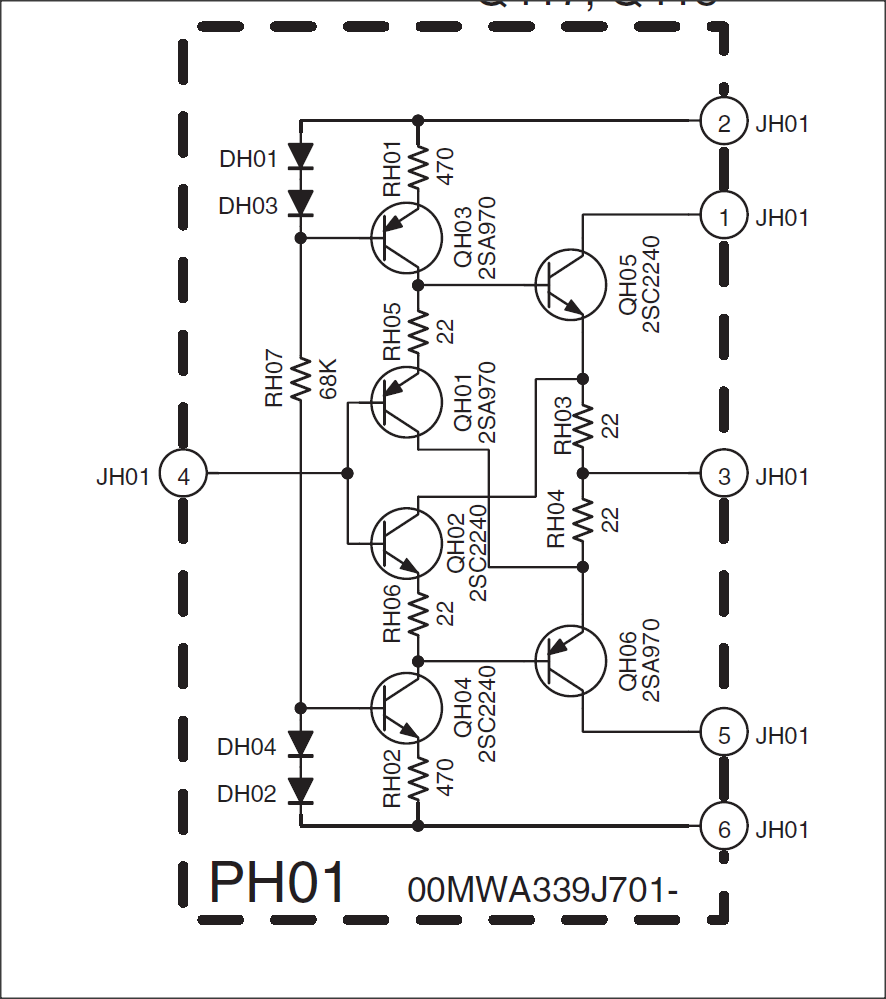

HDAM Schematic
Thank you for the HDAM schematic, where did you find it?
This is an elaborate emitter follower (no-feedback buffer).
This information was indeed missing in your post 10456
(Q 335, 336, 337, 338).
It appears that HDAM means Hyper Dynamic Amplifier Module,
but this is not an (op-)amp, just a follower.
At first I wanted to point out that the HDAM output in your pic
in post 10456 was mislabeled neg. input, this being incorrect.
If it was an opamp, the output would need to be connected to
the neg. input in order to act as a follower (so two pin numbers).
Now, knowing the ingredients of HDAM, the designation in pic
10456 is still incorrect, pin 4 should be output only, not neg. input,
which is missing in a buffer.
It is interesting to see a follower connected as a DC corrective
amp (kind of servo), Q337, 338 in pic of post 10456.
Note also that the circuit of the HDAM as shown here is practically
identical to the input stage of pic 10456, that means the circuit
could be set up with three of these per channel.
To answer your question someone sent me a PDF.
The schematic I posted is used mainly in front ends of gain stages. The more usual HDAM is attached below, which is used in the output stage.
To answer your other question I will have to check the complete schematic.

The two HDAM modules are in function identical, one has a cascode, making it suitable for higher voltage operation, like the input-stage of a power-amplifier. (still have to regulate the CCS voltage down a bit).
Need to explore the HDAM servo a bit.

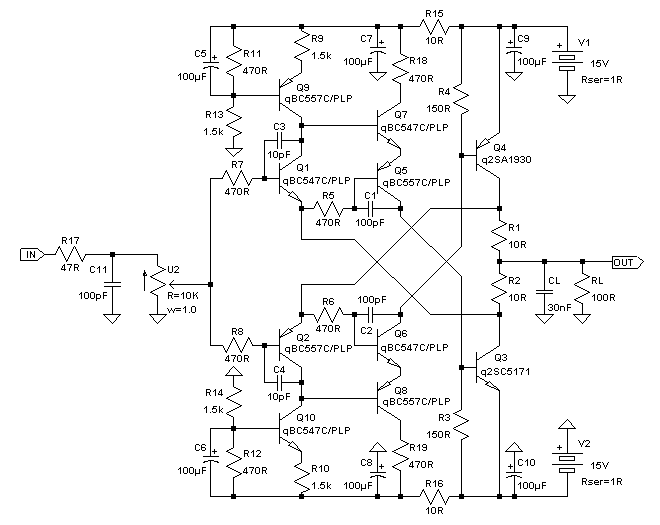

I am working on a HDAM with J-Fet inputs...hopefully this will keep the offset down to a minimum and be able to direct couple without a servo...........
....or you an go really crazy and do something like the attachment😱 ....maybe even calls for a new thread......what do you think Chris?

The second one is attached using a 100K/4700u filter and acts as a servo (looks like that).
.. as seen in post 10461 http://www.diyaudio.com/forums/analogue-source/154210-mpp-1047.html#post4285795.
The circuit in post 10456 http://www.diyaudio.com/forums/analogue-source/154210-mpp-1046.html#post4284257 is a phono amp with an elaborate "Diamond Transistor" input stage,
follower (Q335) and dc corrective amp (Q337). As seen in post 10460 http://www.diyaudio.com/forums/analogue-source/154210-mpp-1046.html#post4285697 the HDAM modules
used here are elaborate diamond followers, not opamps. Pin 4 is mislabeled in pic of 10456 as
neg. input, it is the output.
The whole thing is not easy to explain in detail and I will try only if requested.
Hi Jam,
Oh my! You really must be bored to come up with that! Its too early in the day for me to think through it all. I wouldn't want to be the guy that had to match all those transistors!
Normally I would go for something a little less complicated. You only need enough to allow the signal path to be linear. I like the idea of using J-Fets, but you still need the BJTs to make the diamond buffer work as advertised. An input buffer using J-Fets might preserve the signal while also dealing with the bias currents from the BJTs. In a perfect world, the NPN and PNP bias currents would cancel, which automatically balances your DC offset. They should track reasonably well over temperature.
When I "throw together" a diamond buffer, an offset of 5 mV is common. Less than 30 mV if using different transistors for the output side. But then I am usually looking at something else other than DC offset, and 30 mV or less isn't anything to worry about when testing a circuit. I think in production you would need to use a zero DC offset op amp as a servo. Shifting the common base point to correct offset would be easy enough.
-Chris
Jam
That's neat. It has some rare concepts. I'd say it's definitely worth it's own thread, if only because it's unique. That alone may be a good reason to try it out.
