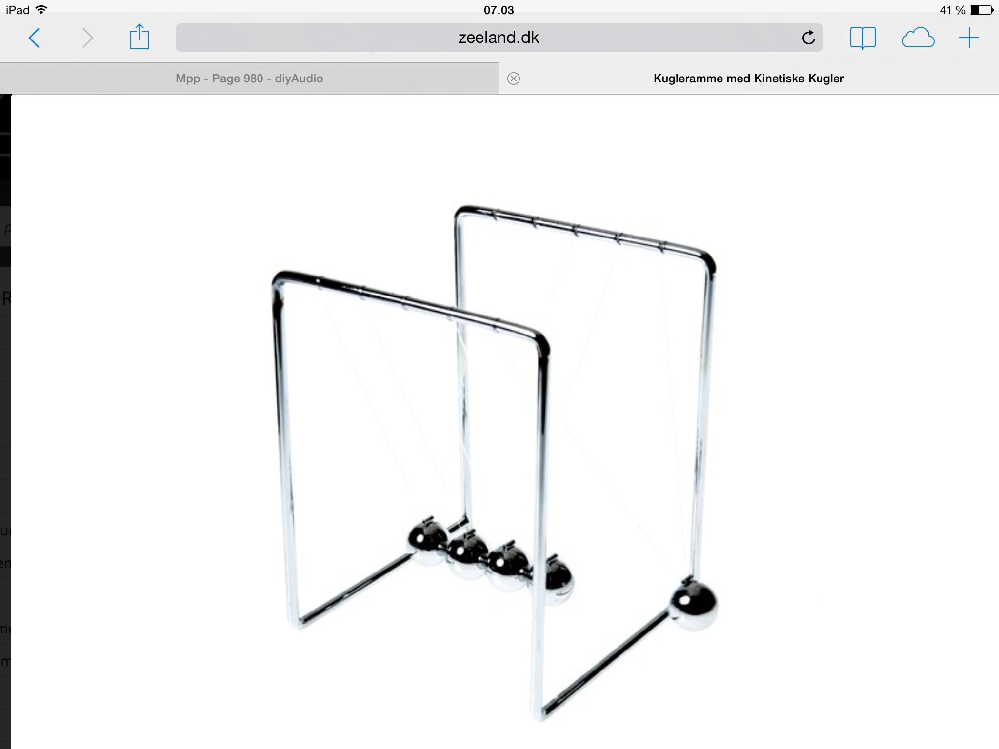

This is interesting, current is then a migration of charge, not a migration of cf charged particles, a bit like this Toy where energy is transferred by elasticity of the equal mass balls
