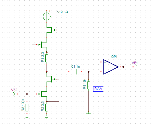

I also had the goal to use only one single ended class A gain stage plus a buffer. Even the Salas Simplistic has two stages and a buffer. The input J-Fet BJT cascode and a J-Fet drain follower. I also wanted to use transimpedance like in the Paradise but again single ended. The major problem with such a super high gain input stgae is thermal runaway. Over the years i have build much but i could only make it work with tubes.

Today then i made a breakthrough. I build a floating J-fet cascode with floating J-Fet cascode CSS that is thermally stable enough and gives around 60dB gain incl. RIAA so it can be used with MC. Noise impedance is around 20 Ohm. Better then an AD797 and not the best i can do but certainly better then my tube phono.

My design is similar to the Fet MM version in that it uses an input Fet that is cascoded.
Aloia uses a tube, i use another J-Fet. He then loads that stage with an SRPP.
That goes into a cathode folower that drives the passive RIAA.
I load my input stage with a Fet-Cascode CCS with fixed bias.
Only the input is modulated by the signal. I call that J - Fet Totempole, just to give it a name.

The circuit is a bit tricky concerning where to place the AC capacitors because the buffer also works with one PSU voltage only.

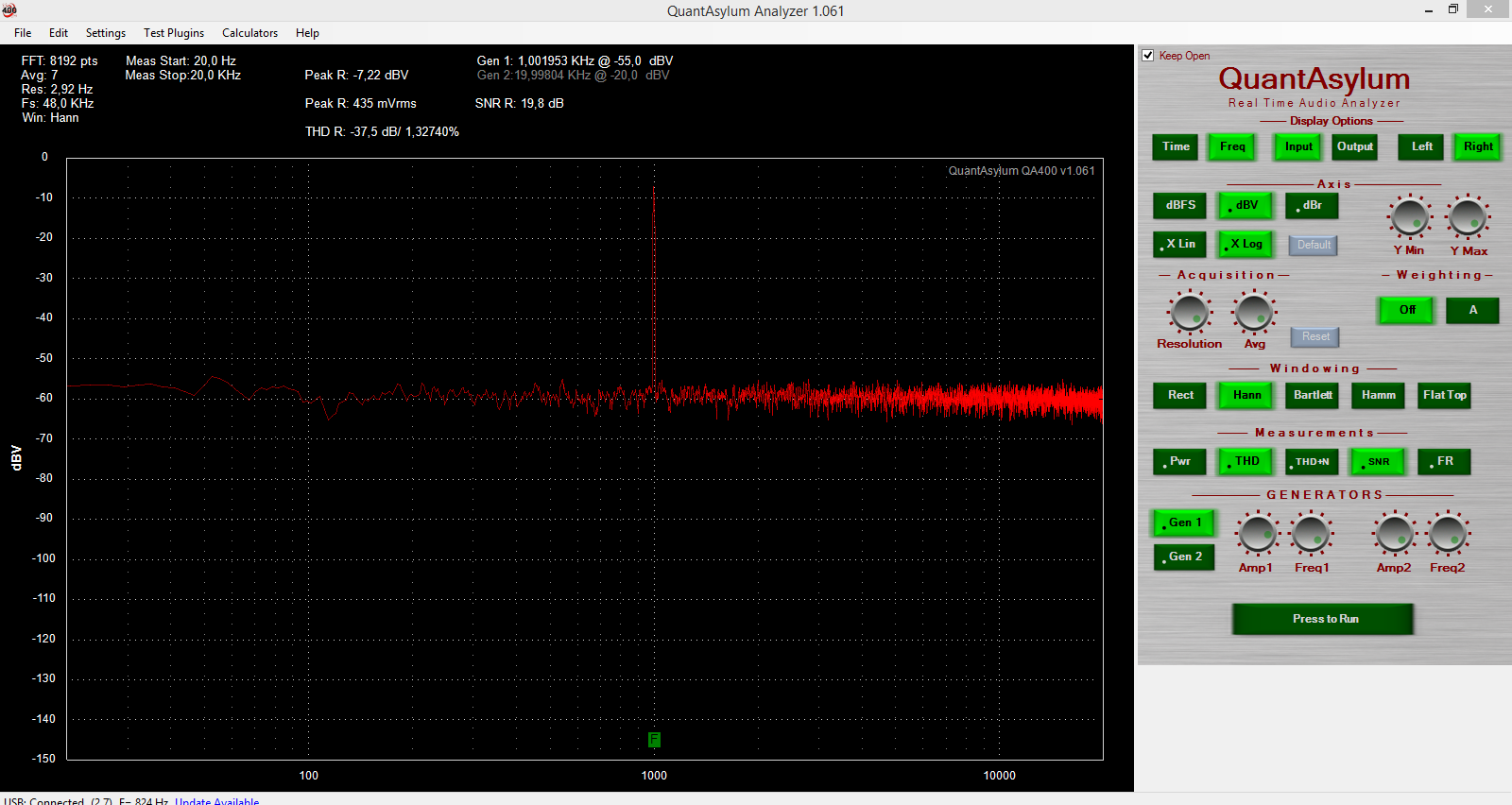

Distortion is dependent on the balance of the input stage. When it goes out of balance third harminic shows up. Other wise there is only second up to 1V output.

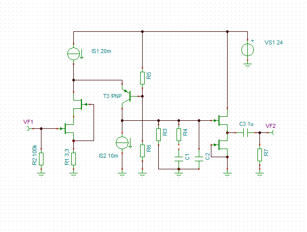

Absolute phase reversing, right? An SRPP input stage with a JFET+BJT cascode down the totem pole and Darlington top hat can have the RIAA EQ as an SRPP feedback active element and keep on the single stage and buffer phase reversing single rail theme also. Like in the Alex Nikitin's mid 90's Creeks. Few transistors fully discrete.
I know Alex circuit and i think it is good.
Yes, my circuit is phase inverting. Cartridge leads can be reversed.
I made some further measurements and i do not have enough gain in the bass with the 53dB version. 40dB is ok but i think more is a problem.
So i changed my strategy. I will go for a folded cascode that is loaded by a CCS.
I keep
the floating cascode at the input. I used that configuration several times and it worked well.
I could of cause cascode the input Fet with a BJT but the floating cascode is simpler-
