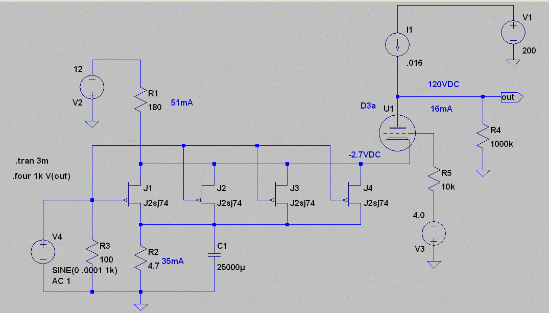

The SE-Fet/folded-cascode input has been discussed ten years ago around here.
The second stage was with opamps, though. I build a few versions, it sounds promising, albeit I did not manage to get stable DC-conditions (this with a 9V-Block and a psu for the opamp-part). If I would do it again, I'd feed a CCS for the cascode-Q with a separate negative supply.
Or, if I'd been into tubes, build it with a p-fet input and fold-cascode it with a tube. This would give me some voltage swing to burn in a shunt riaa network.

Have you seen the circuit that the always interesting JC Morrison published on his blog a few years ago hybrid folded cascode Gm amp | lab jc.If I would do it again, I'd feed a CCS for the cascode-Q with a separate negative supply.
It sounds almost exactly like what you're describing. I attached a copy of the circuit to make viewing it a bit simpler. I haven't built it but it looks very interesting.

No DC blocking cap at the output? Weaponized phono gain stage?
Luckily the output is marked 120V you are warned (that what you get when SDI is scraped and these 'engineers' get a new job). 🙂
https://www.google.com/search?q=sdi...CLyQOF1oD4BA&ved=0CAgQ_AUoAw&biw=1496&bih=925
p.s. I see 16mA is also marked, this most be a killer app. 🙂
Come on, it's a conceptual sketch! 😉
thanks for the link, Gary, yes, that's what I meant!
Now to find a realistic spice model of a D3a, or, better yet, some unknown russian tube that sells for a few pennies...
