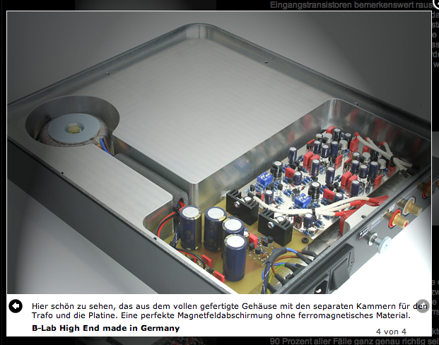

When you look carefully you can spot them here.
This is a brand new Phono Stage from the Physicist i am talking about.
Seems he has not found something better in 30 years.
The sales blurb sais that the input stage is very low noise, so what.

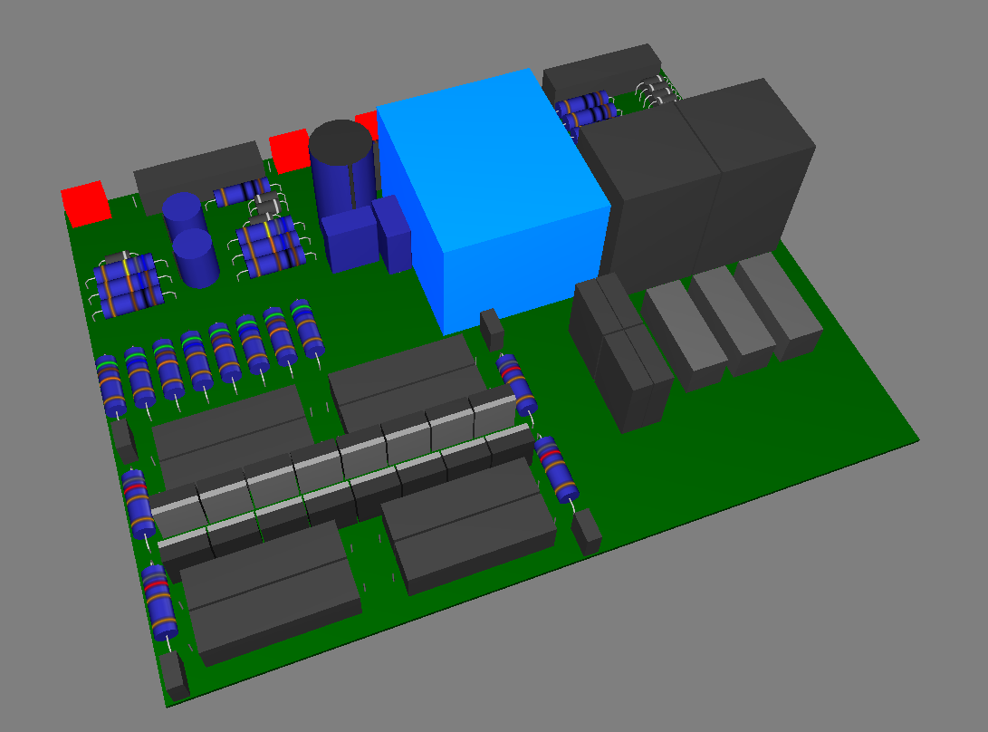

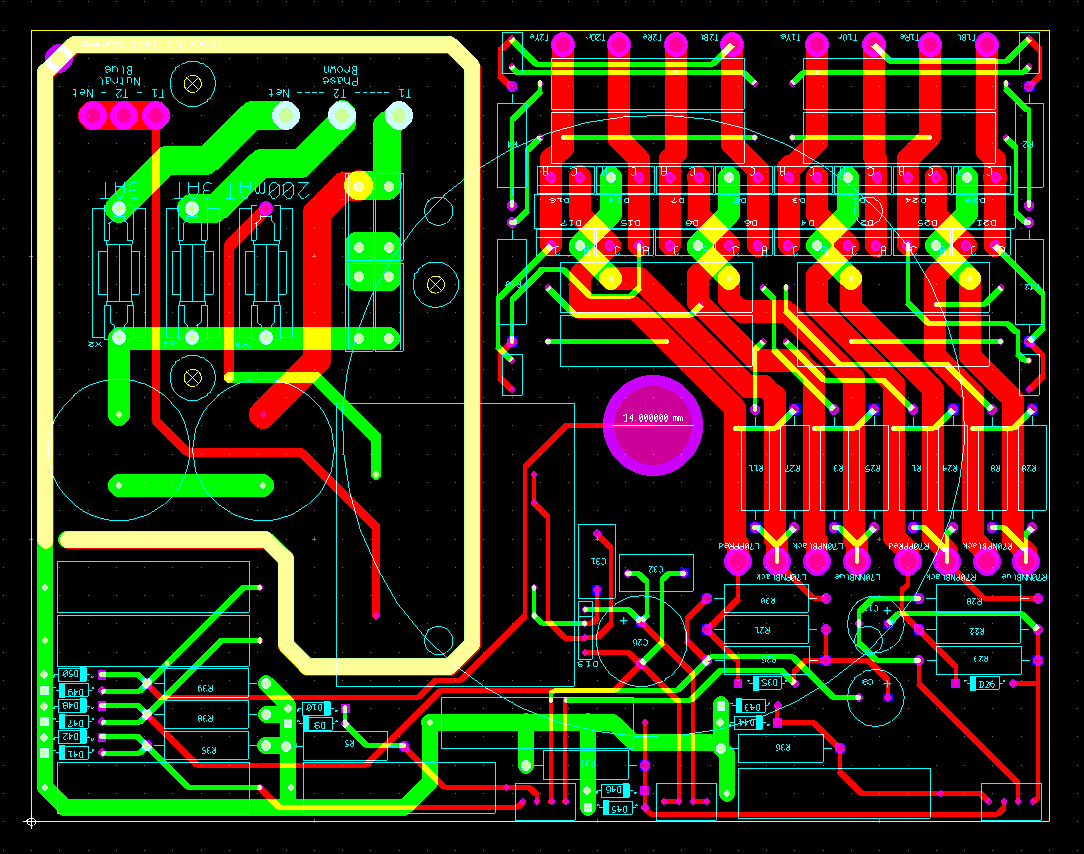

Hi All,
Best wishes for the new year, and if you was wondering what I did during the holidays 🙂 then here is a picture.
2 x (both sides) Mains 'ground-rail' guard (no solder mask)
1 x Mains DC-blocker
3 x Fuses for Transformers
1 x 12VA 9V Transformer + Rectifier + Capacitors
4 x 20Amp Bridges + Snubbers
6 x DDRC ( InR/InL, OutR/OutL, 12V and Case )
2 x N0X
All connection support for Mains(3x) Primaries(4x) Secondary(8x) Elco's(8x) and DDRC's/N0X's using headers(3x).
The boards will be 2.5mm thick with 4oz copper.
It is designed to set on top of 2 toroids (in my case 2x 600VA) The 4 blue circles (on the large circle) used for rubber standoffs and the big central hole used for mounting on the same screw that is used for mounting the toroids. The 3 holes (in the HV section) should be used to mount a Plexiglas 'roof' over the HV section for safety.
Tomorrow I will order 10 of these for myself, but if you would like to have (unlikely) a few then quickly drop me a PM.
