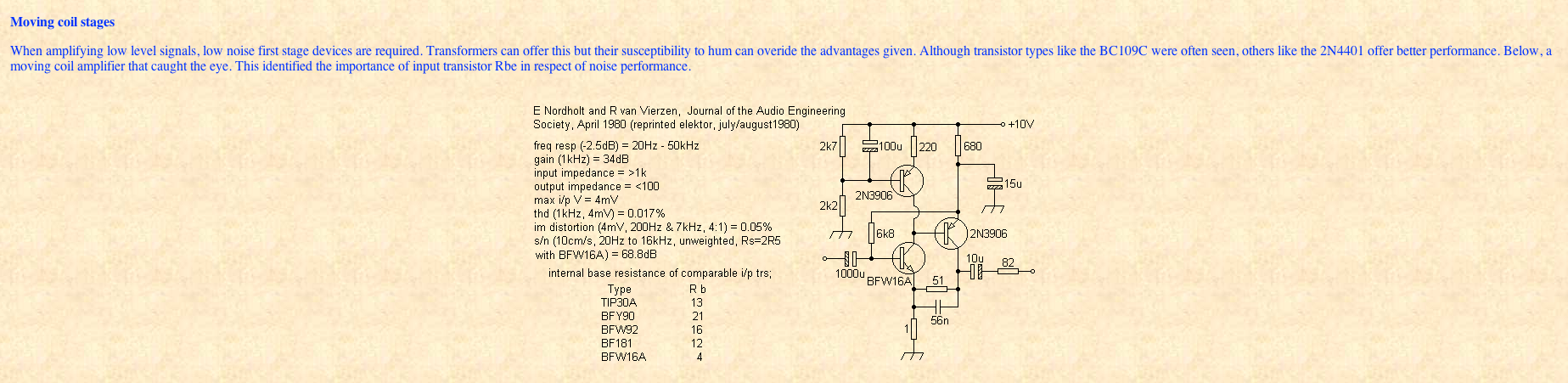

The first circuit that came to mind was this one published in The Journal of the Audio Society :
As nice as it is i really do not like the AC coupling much. There are very good caps on the market now and i think that midrange and treble can sound more or less transparent but i always found when i DC couple the bass gets better. More deep, tight, slamming etc. you name it.

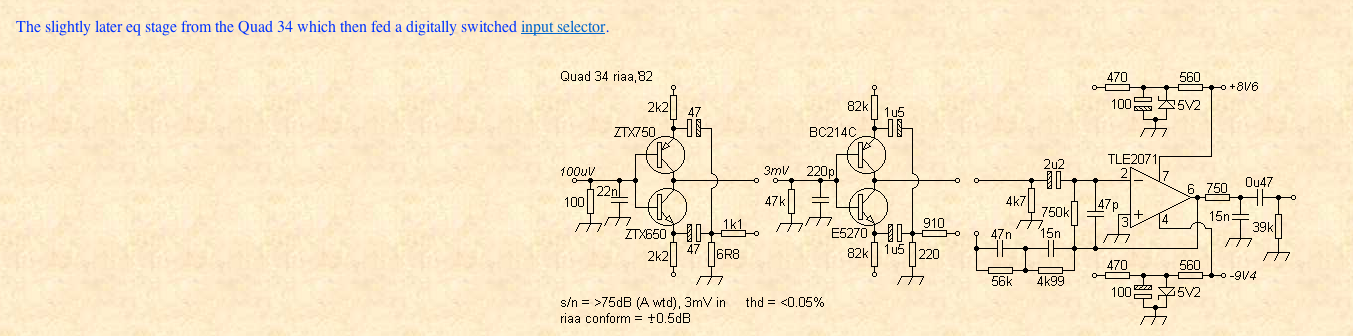

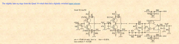

The following circuit is at least DC coupled at the input, so one big elcap less.
As far as i can tell it is a Baxandall idea. It works with the fact that a BJT transistor still works when the Base-Collector potential is Zero Volt and the Vce is only Ube ( ca. 0,65V ).
Here the input stage on the left is in a feedback loop including the following opamp.
It can be used in isolation too as only a linear pre-pre without the opamp.
