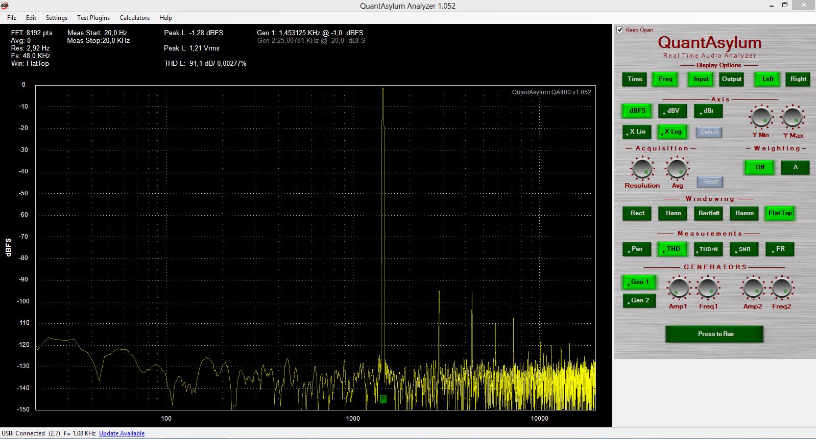

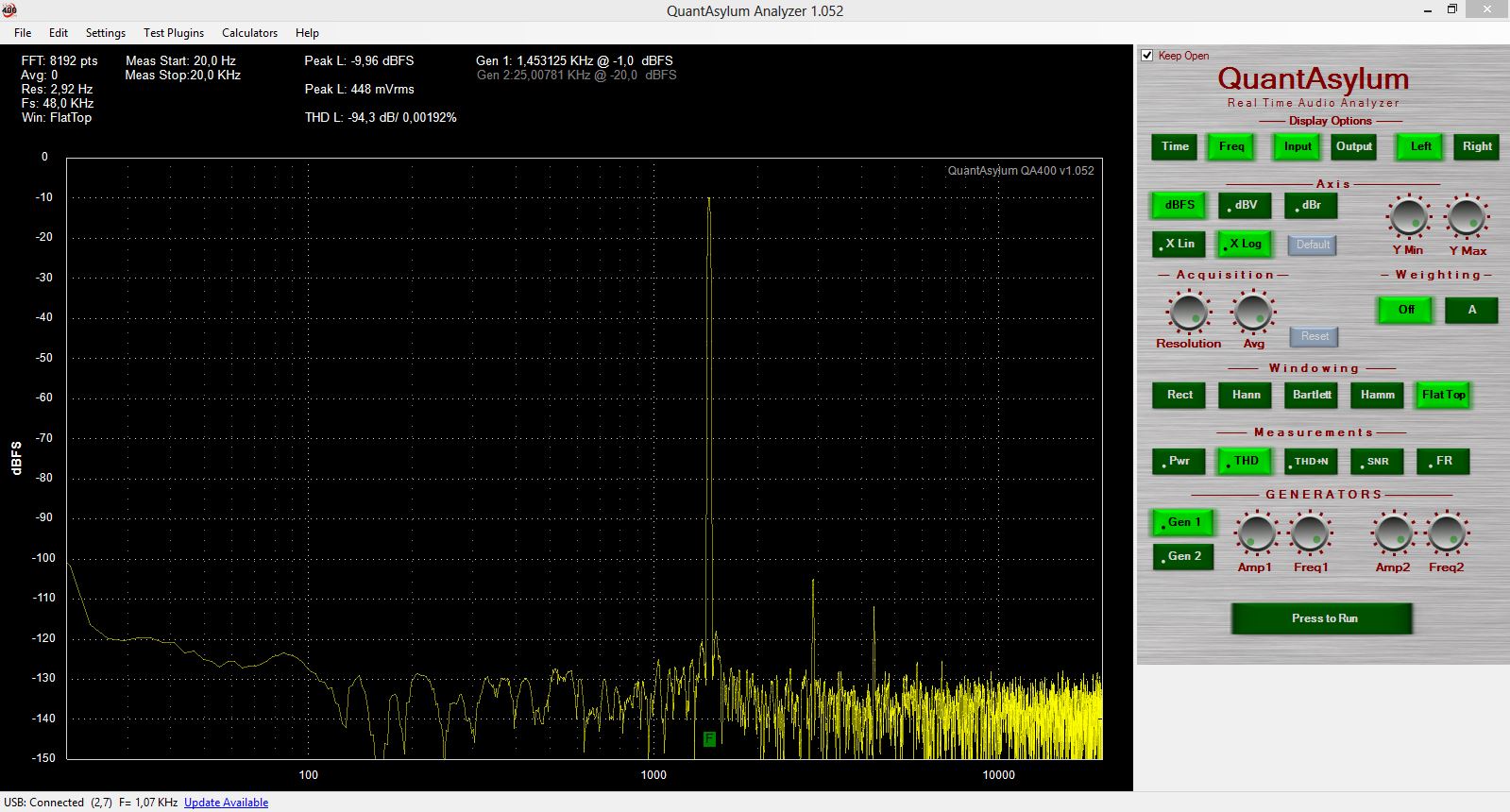

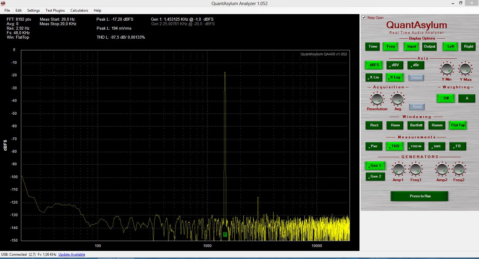

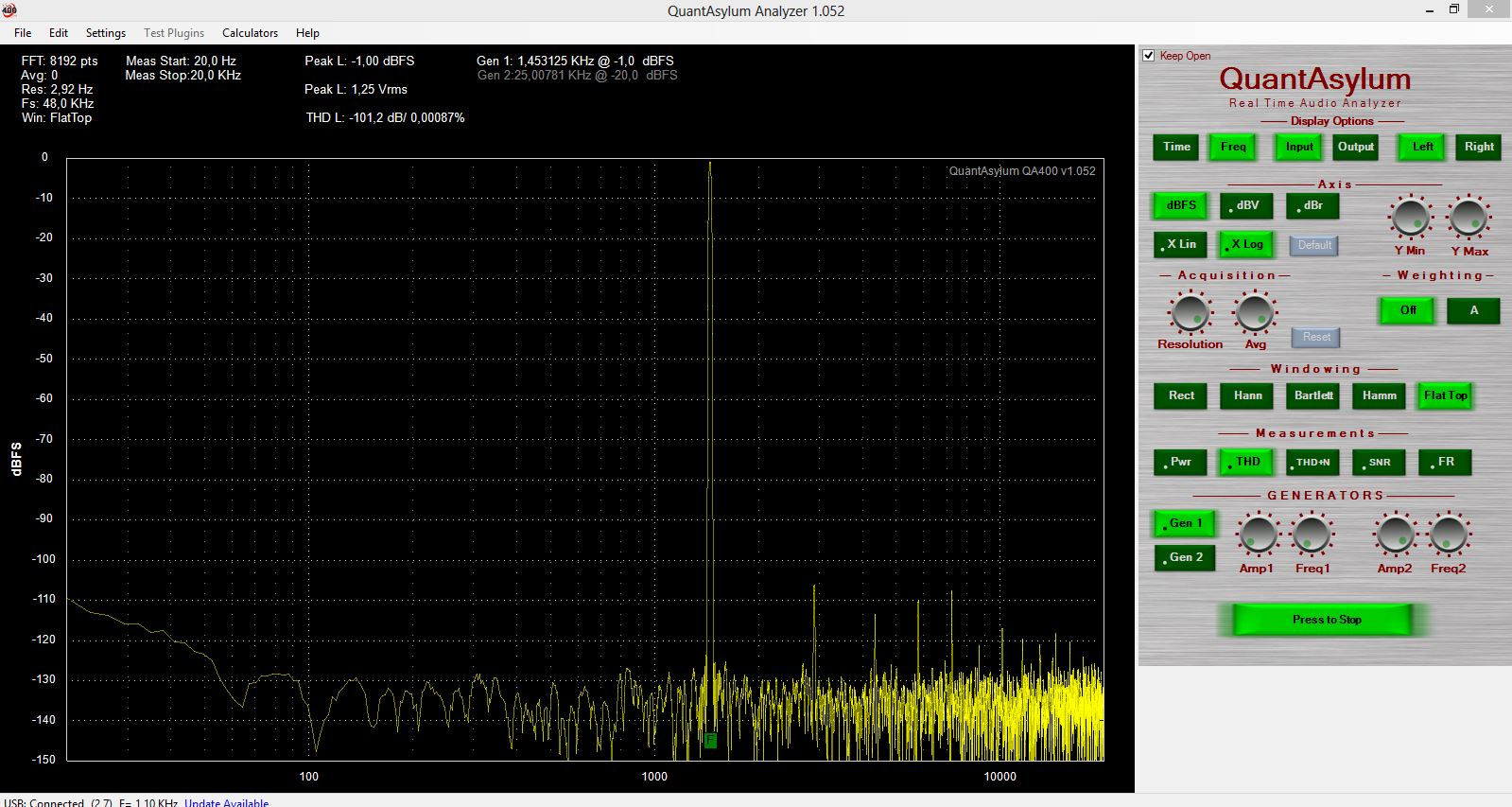

I got a Quantum Asylum Audio Analyzer.
I made a loop back measurement and got the 3rd harmonic at ca.-105dB. That is around 10dB worse then Audio Precission teritory but 10dB better then i get with my E-MU 0202USB so i think this is usefull.
Just for fun i measured the B1 buffer i build quite a long time ago.
At ca 1.3V RMS ( around 4V P-P ) i get around -95dB distortion. I think for something so simple this is very good. I also show distortion at lower volume and the volume where the third disappeares in the noise. The first picture is a loop back measurement of the analyzer.
The last picture is intermodulation with a 10kHz -10dB sine mixed in.

If i had one in isolation, yes.
I have it on the XEN ESS board and on the Paradise.
We simulated it though and it has ( much ) lower distortion provided it is not driven out of class A or voltage overdriven.
I can make an even better buffer especially if more voltage and current is needed.
The attractive thing with the BF862 based version is the extreme compactness.
Concerning measurements, an AD797 buffer with common mode compensation would have no measurable distortion, even on an AP. Does it sound better ?
I think the success, subjectively, of my buffer-filter is the extreme simplicity combined with the good performance.
I do not think that static distortion measurements tell us all about the sound.
I wish it would be that easy.
I am fully aware of the fact that good numbers do not necessarily correlate with good sound. I just wanted to get an idea of the measured performance of the buffer.
I was too lazy to simulate it on my own. If I would have done it, I would have seen that the buffers distortion figures will probably not be measurable with the given equipment😀 Just found the thread from calvin about preamp buffers with simulation results.
The subjectively perceived quality I know very well 😉
