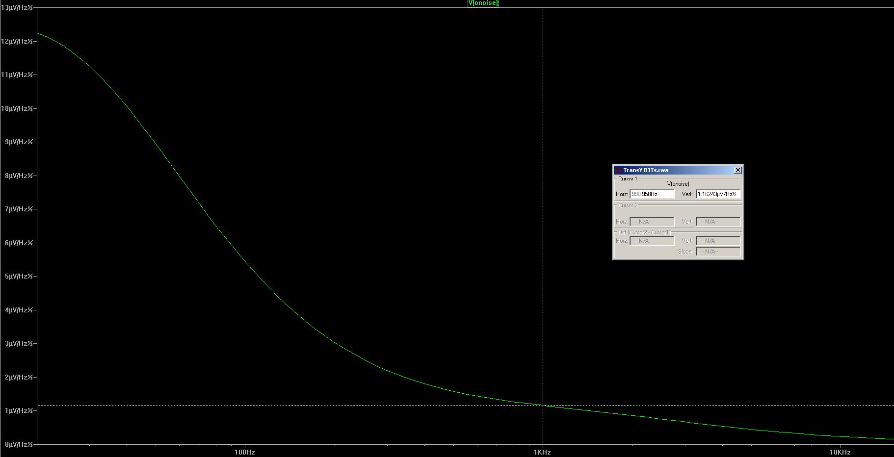

Because Simulation of the entire circuit shows acceptable noise performance, but by any means not in pair with what you like and that is why I was wondering about that.
I will post the noise performance a little later...
ok.
Leet me plug the new circuit in and see how it looks like noise wise.
BTW with the same models I can get the paradise to be at least 3dB quiter thus I am not so sure that in this instance the noisefloor of the models is playing a big role but I might be wrong and in that case please point me out to the right model to use to have a more realistic result.
It depends of cause on the transistor models but the rise in the bass is not good.
Anyway, i do not want to make a balanced transimpedance input any more.
Lets go back to the older circuit.
Your master intuition was right.
The older circuit simulates just perfectly noise wise.

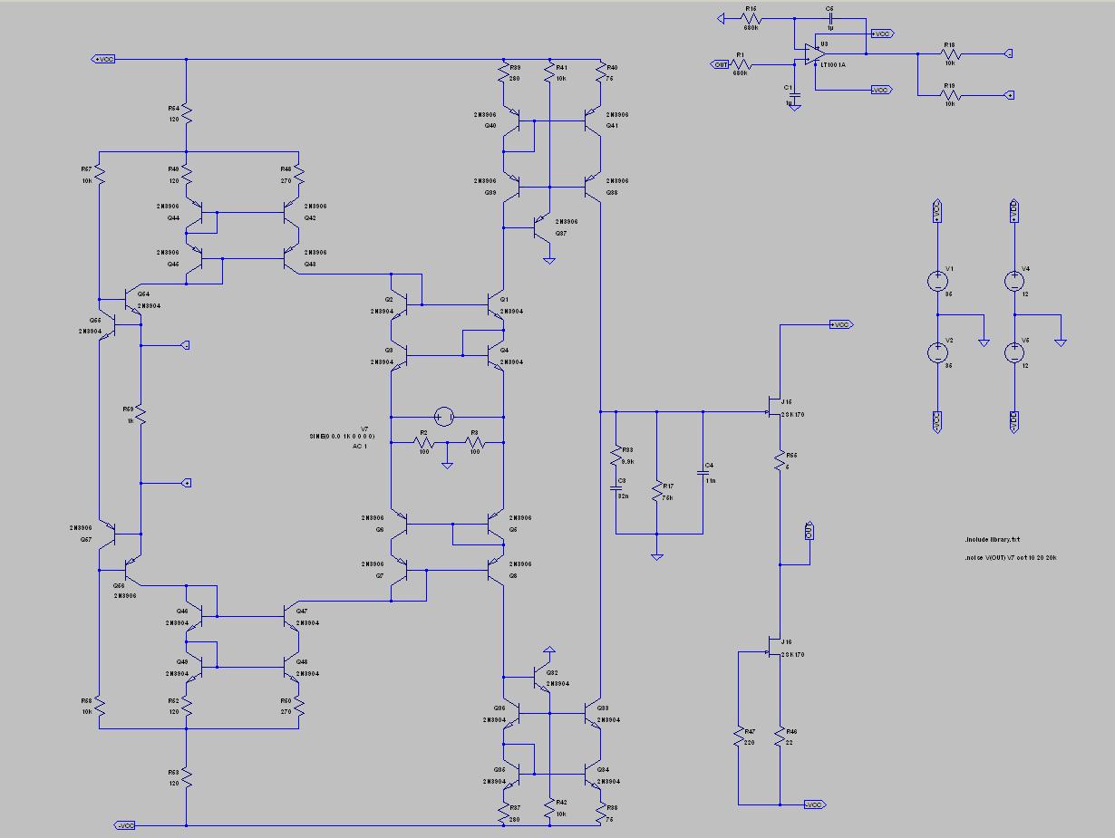

It looks extremely interesting and it could be made completely balanced from in to out.
I am wondering if enough gain can be reached with Jfets as well.
I will have to simulate this as well.

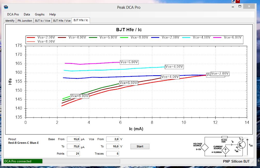

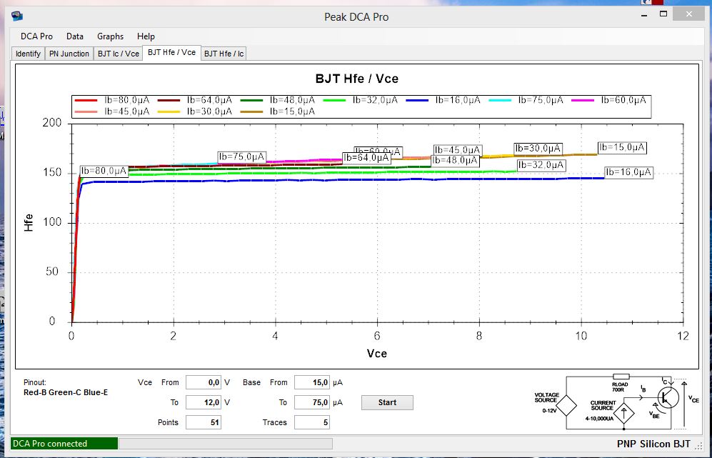

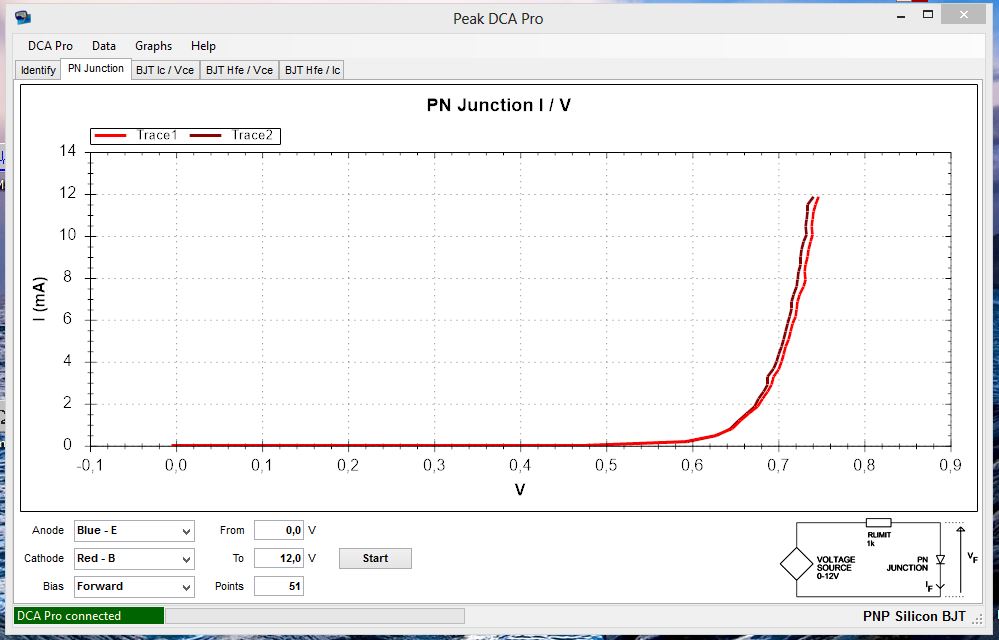

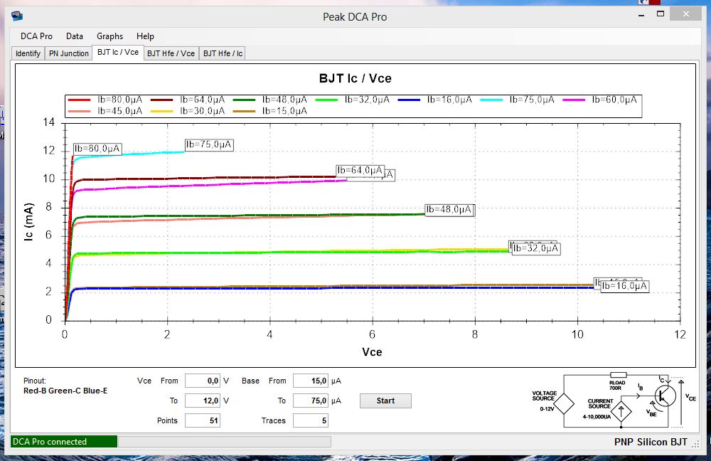

Today i istalled the new software for the DCA75 pro curve tracer. It adds some more functions. Here you see measuremets taken on a pair of Zetex medium power tranistors that are known to be low Rbb. What i find interesting is the curve Hfe over collector current. The PNP has full Hfe, even at very low idle.
